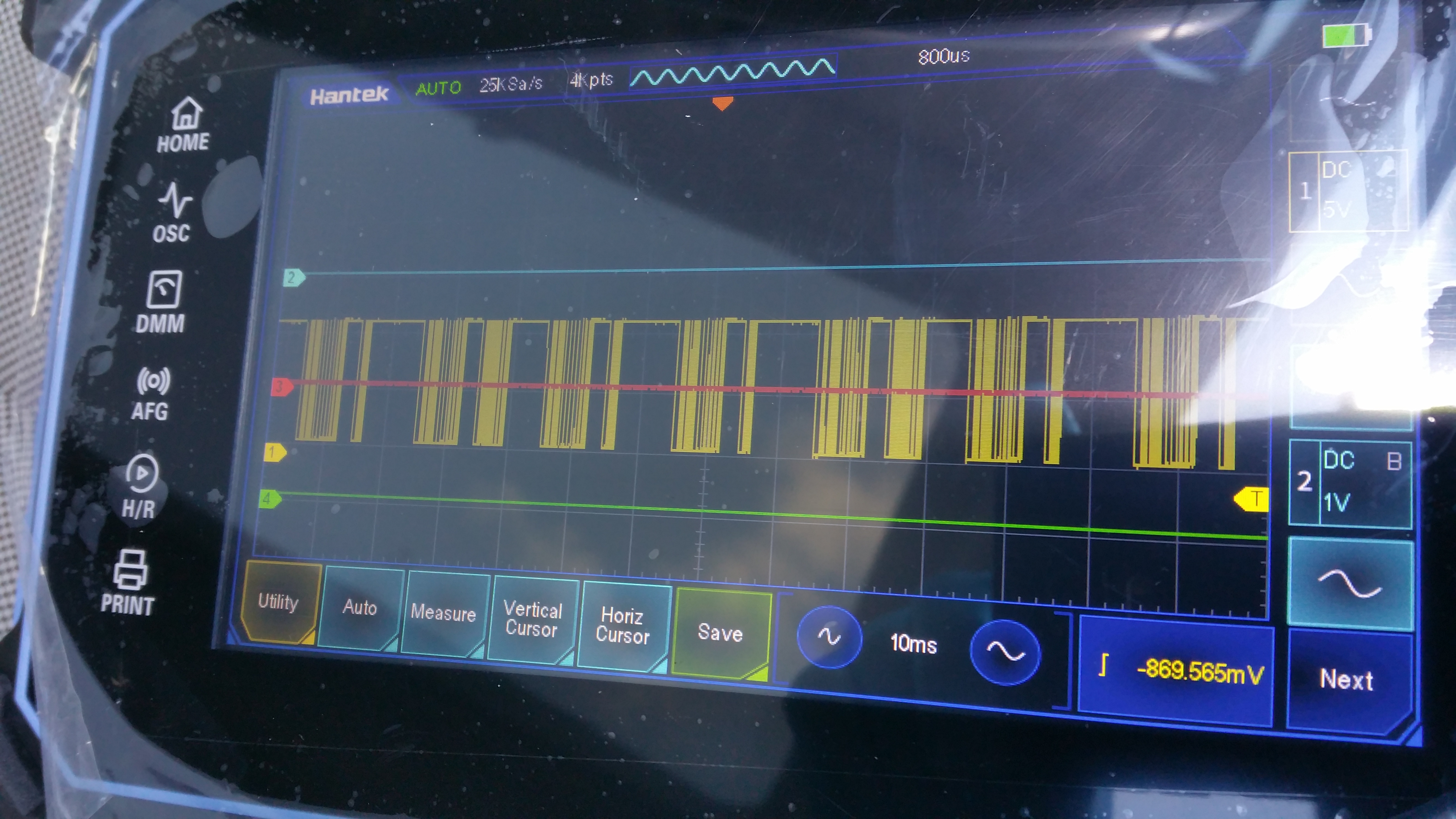

It sounds like it, but to be sure can you get an oscilloscope option on your software? and connect to the thin wire on the alternator, if you get a
wave like the pic below, it's an intelligent alternator
... and the 'exciter' is NOT and exciter in the traditional sense, but a LIN signal from the Engine ECU.

*** Breaking news, it IS a smart alternator. I don't want to change it again any time soon as that was an unpleasant experience but perhaps can find a workaround - or just put up with starting it twice every time
