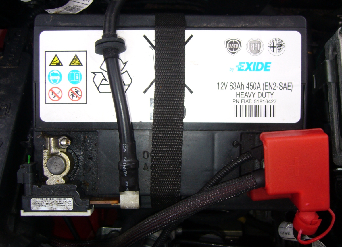

Just been out to check (brrr!). The OEM battery fitted to my car is a FIAT-badged Exide.
Fiat Part No 51816427 - 12V 63Ah 450A
Picture attached - click twice to enlarge

I looked this up a while ago – might be wrong – the closest spec’ed aftermarket battery I’ve found was the Exide EL600.
http://www.exideuk.com/el600-124-p.asp
From the manual (version 2010-02):
“there is a battery status monitoring sensor D at the negative battery pole C which should never be disconnected except if the actual battery is replaced” p. 65
“If the battery is replaced, always go to a Fiat Dealer.” p. 66
IIRC, D4nny8oy mentioned that the new battery has to be fully charged before installation for Start&Stop to work properly.

Looking at jrkitching's battery which I assume is an S&S one, I wonder if the battery tray on the S&S 500's is a bit larger and an S&S battery might not fit in a non-S&S 500.

That's what I think to be honest. Let us know.
… I wonder if the battery tray on the S&S 500's is a bit larger and an S&S battery might not fit in a non-S&S 500.
That, and from what I gleaned the Start&Stop version has a beefier alternator, 70A vs. 55A.
