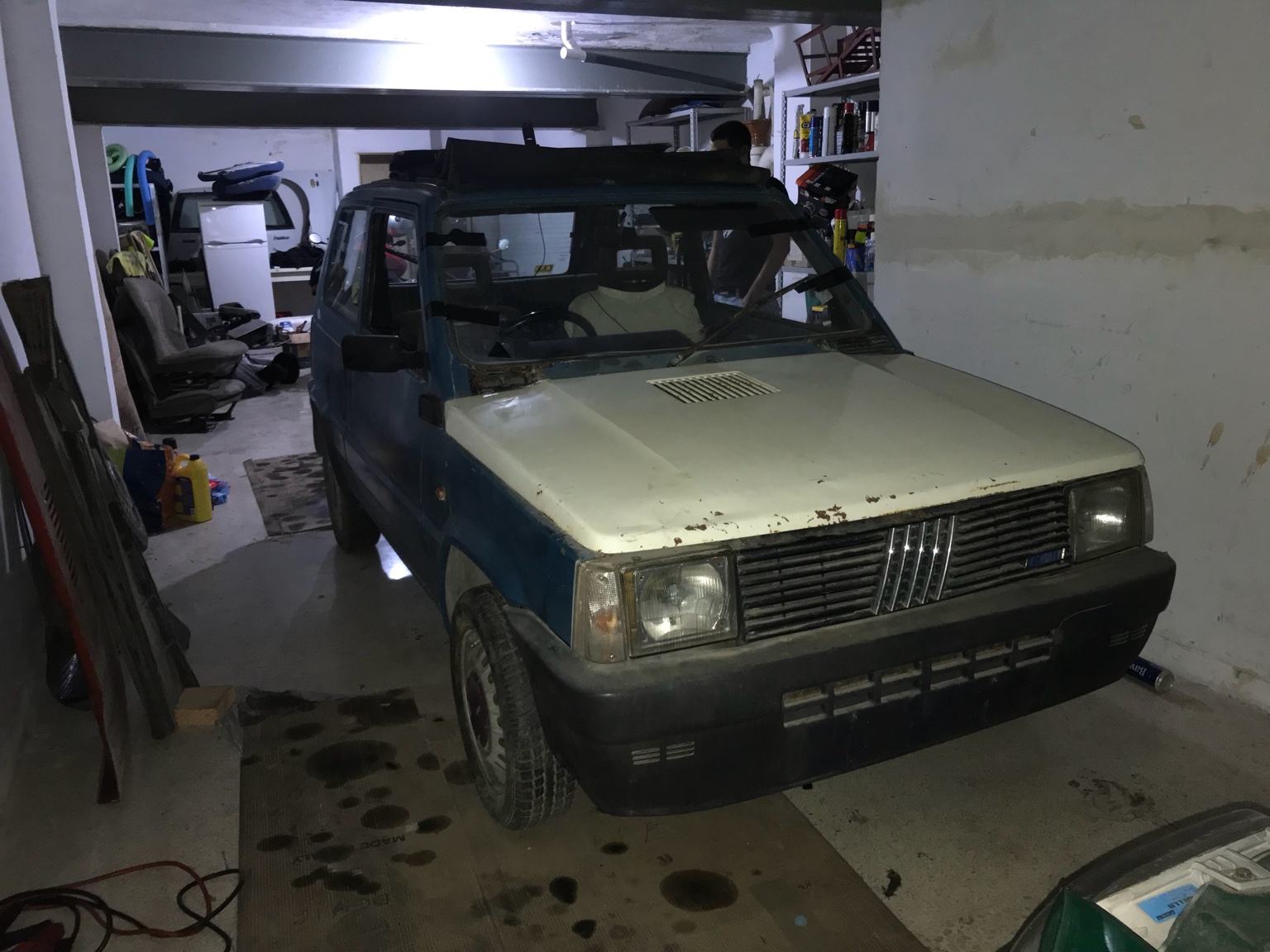

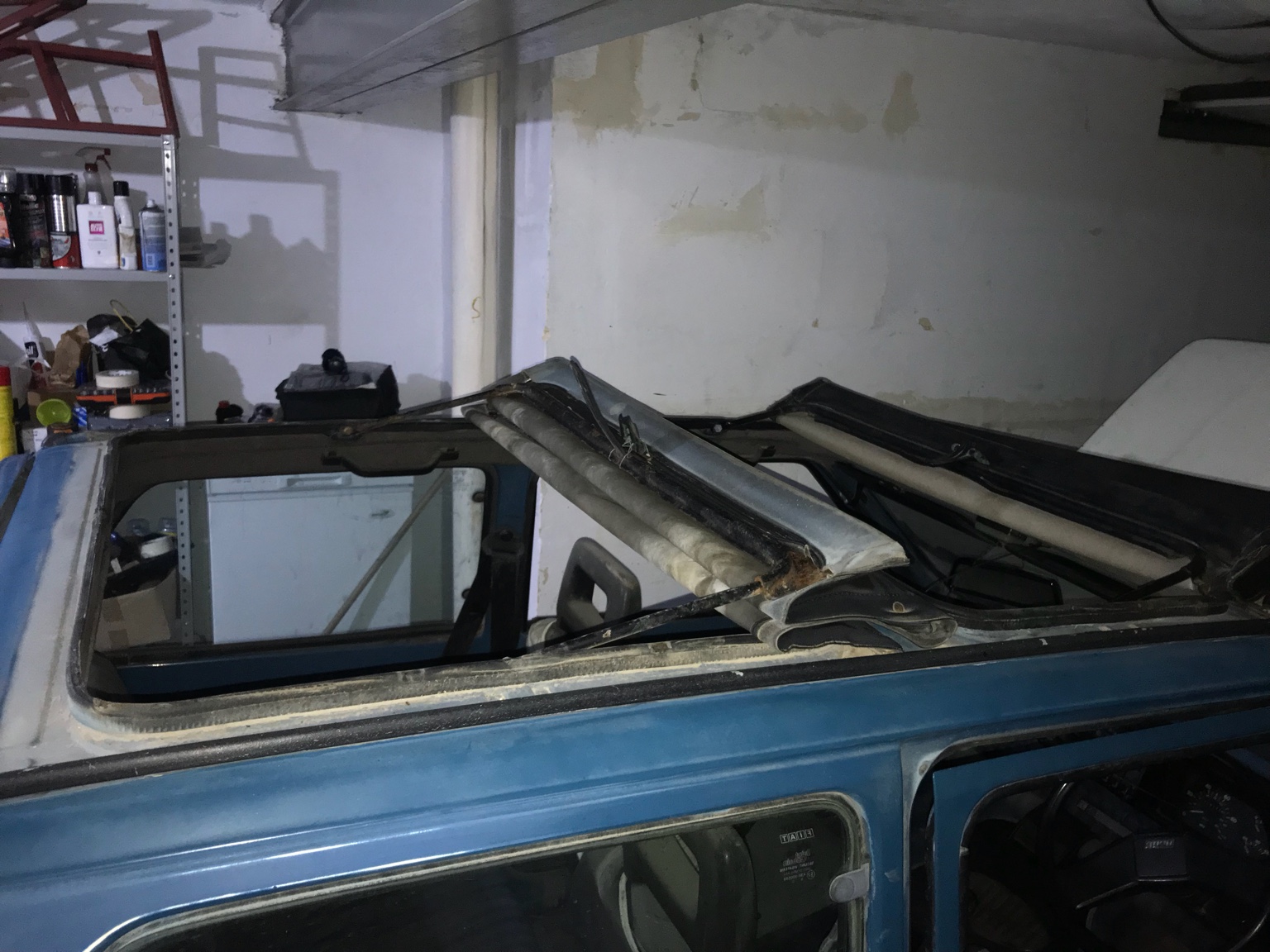

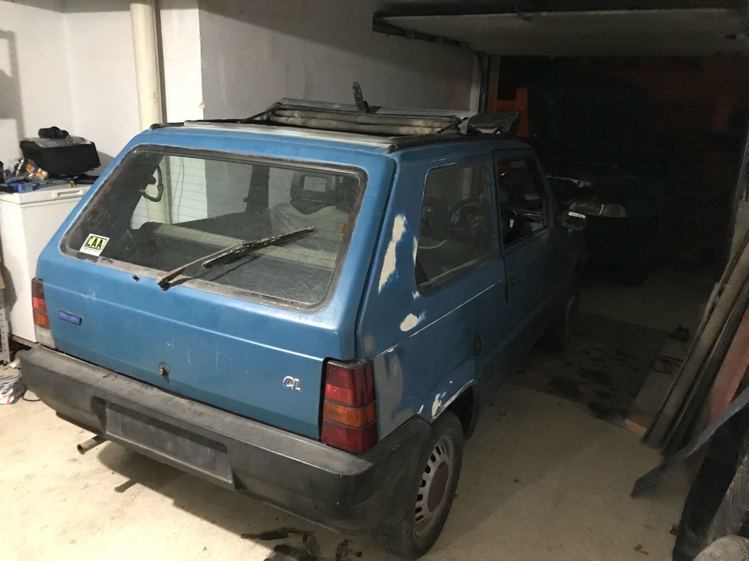

Hi all! Just bought my 2nd panda after having sold my other one a few months ago and couldn’t resist in buying another one :) This panda(still haven’t found a name for it) has been dry stored for the past 9 years and untouched for the last 4-5 years. Front brakes are slightly jammed but it cranks up. We put fresh fuel in it and changed the plugs with new ones. The problem is, the car starts for a few seconds but then shuts down as if its starving from fuel. Starts back up and does the same thing over and over again. Could it be the carburetor float? A dirty carburetor? Fuel filter has been done new by me and the fuel pump seems to be working as its squirting fuel out when tried disconnected from the carb. Below are some pics of it. Thank you all [emoji5] IMG_0375.JPGIMG_0374.JPGIMG_0373.JPG
