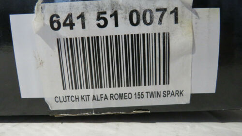

I have found a supplier who says he has a Barchetta clutch -'3 PIECE Clutch Kit for ALFA ROMEO - 145 146 155 - FIAT - BRAVA BRAVO BARCHETTA MAREA'
Is this the correct clutch for my 1999 B?
