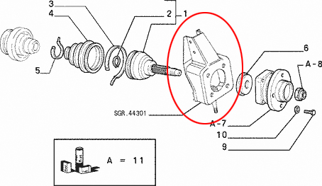

The lower joint is much easier to replace if you replace the whole hub carrier/ball joint assembly. Got mine (for the 'Rat) from a motor factor for £18. Yes, just £18, that's not a typo. Save yourself a lot of hassle and take the ball joint back and exchange it for the assembly.
See pic below:
The part you need is circled in red.
The two holes in the top of the carrier are where the suspension leg bolts on. Remove the brake caliper before doing anything else and hang it out of the way with some wire or strong string. You'll need to undo the driveshaft nut (A-8) so that once you've undone the suspension leg and bottom ball joint the whole hub assembly slides off the drive shaft. Then all you need to do is unbolt A-7 (this will also have the brake disk, caliper bracket and dust shield attached to it) and bolt it back onto your new hub carrier then refit the whole unit in one. It really is quite easy. You'll never get the ball joint out of the carrier with the sort of tools you'll have lying around at home, believe me, and even if you did getting the new one in requires tonnes (literally) of pressure and extreme accuracy to press back in.
