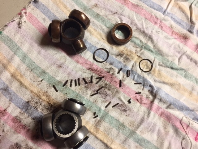

I sorted this.
The offside spider (aka inner CV) joint had worn through one of the tripoid's flange circlips and that had allowed most of the needle roller bearings to fall out on that ring...
I recovered the bodies of about 28 rollers but the other 10-12 had been mashed into iron dust... :eek:
The ring was still on it's bearing but only half a dozen rollers had stayed in there. Still, it managed about 5000 miles from when I first noticed it, so can't be all bad.. :D
A new spider and it's all tickety-boo.
Ralf S.
