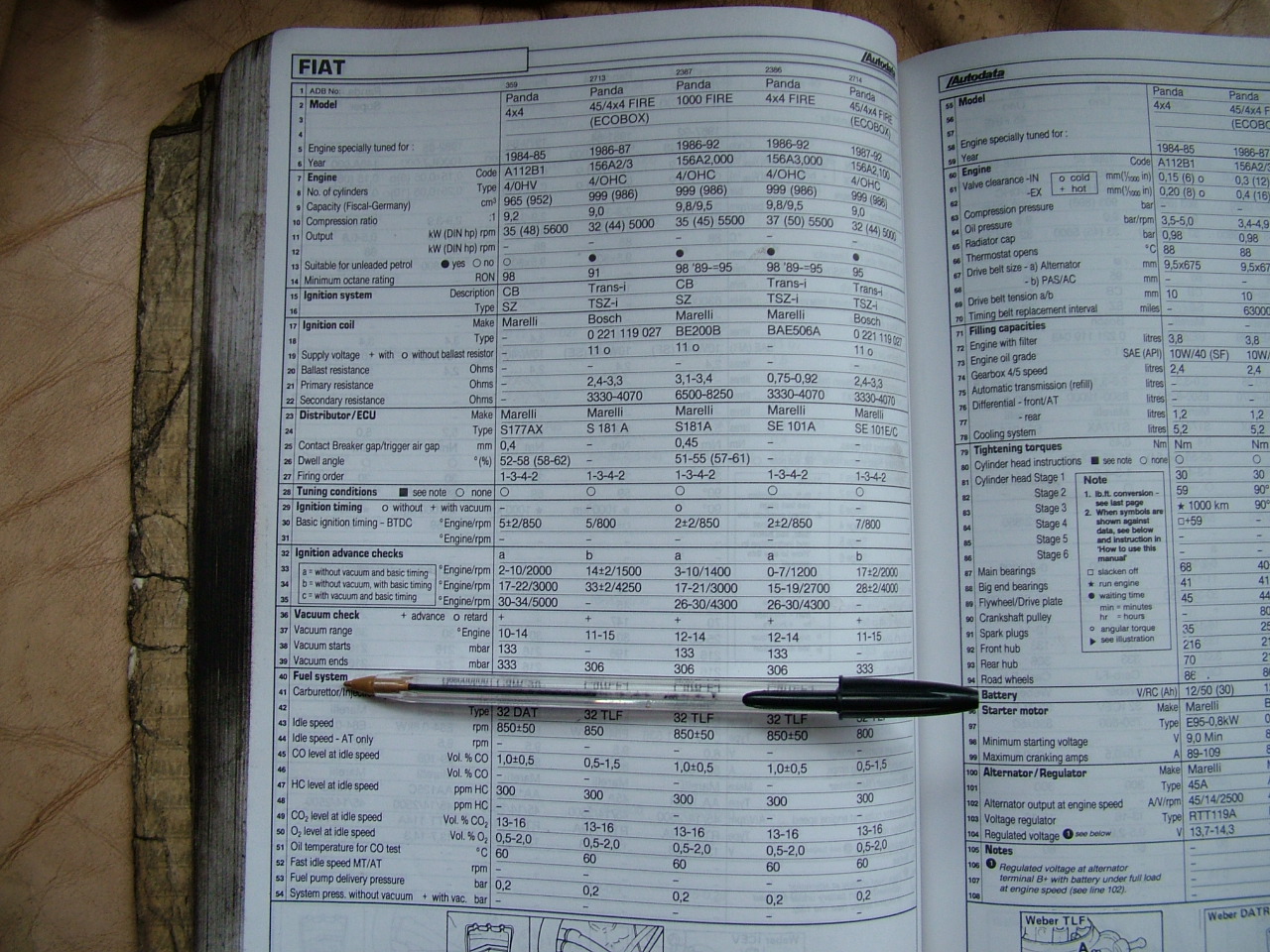

From memory checking timing through square hole in bell housing under rubber plug the timing marks on the casing are 0, 5, and 10 degrees.
Before fuel quality went down most ran happily at roughly 7 degrees, but a road test is always wise to be sure.
Is your idle speed too high, so mechanical advance kicking in?
I assume a basic timing light , not one where you can alter advance figures.
Details in columns above pen in photo.
Your correct time hole n bell housing is marked with 0-5-10-15 markings
I have just basic strobe gun
When i first checked it was at 15 degrees when idling (hot engine)
I didnt check idle rpm as i dont have a meter for it. will look tomorrow
in photo I read correct timing at 2 degrees +/- 2 degrees

On line 28 of book at row of my 1987 4x4 engine 156a300 looks like marked that it should be measured with advance
I did it without the advance vacuüm hose connected

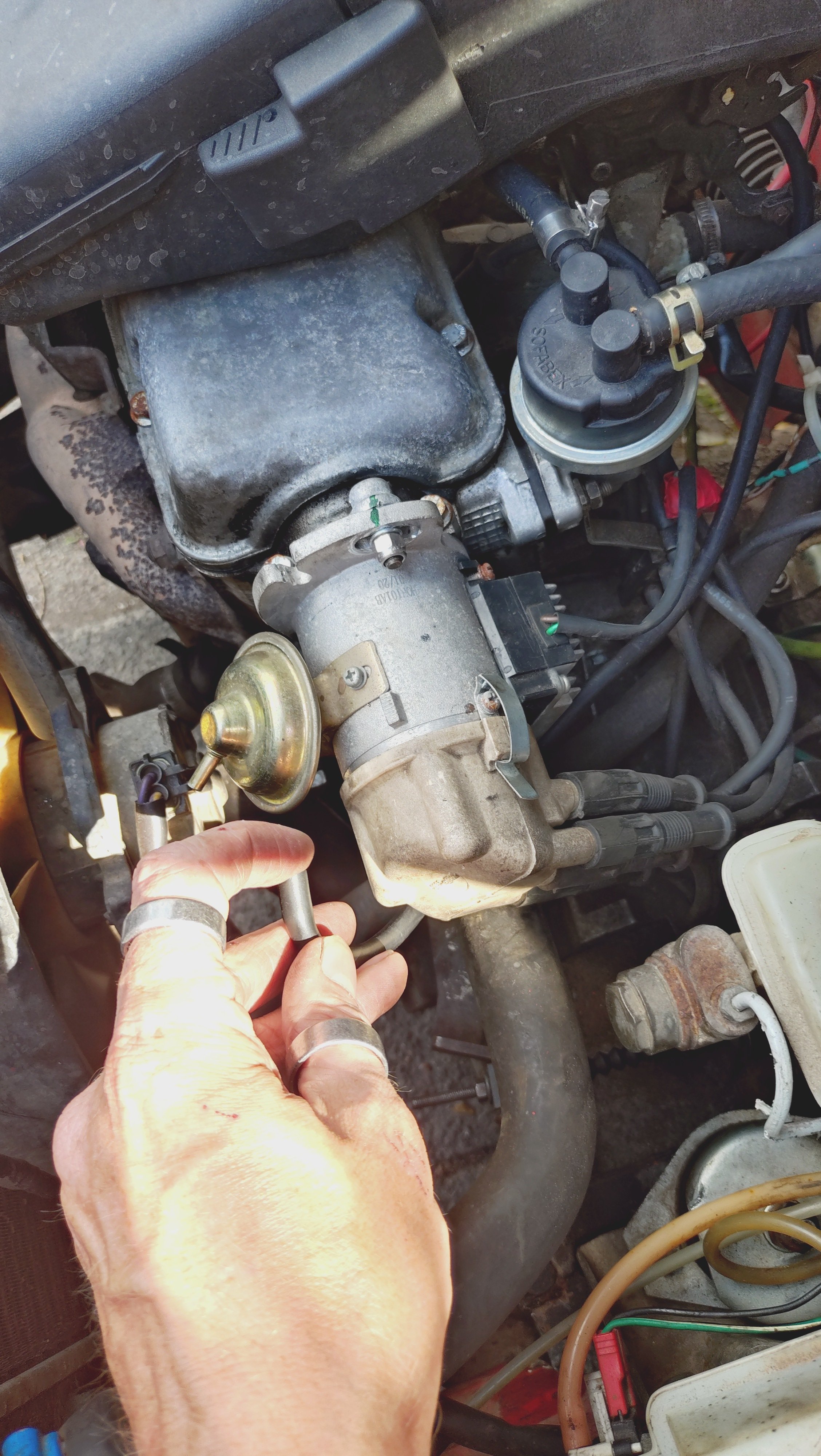

I feel with my finger quite strong vacuum suction on hose to the carburateur on stationaire rpm
When i close hose end fully with my finger engine stalles almost.
When i put hose back on ignition module it runs normal stationary.

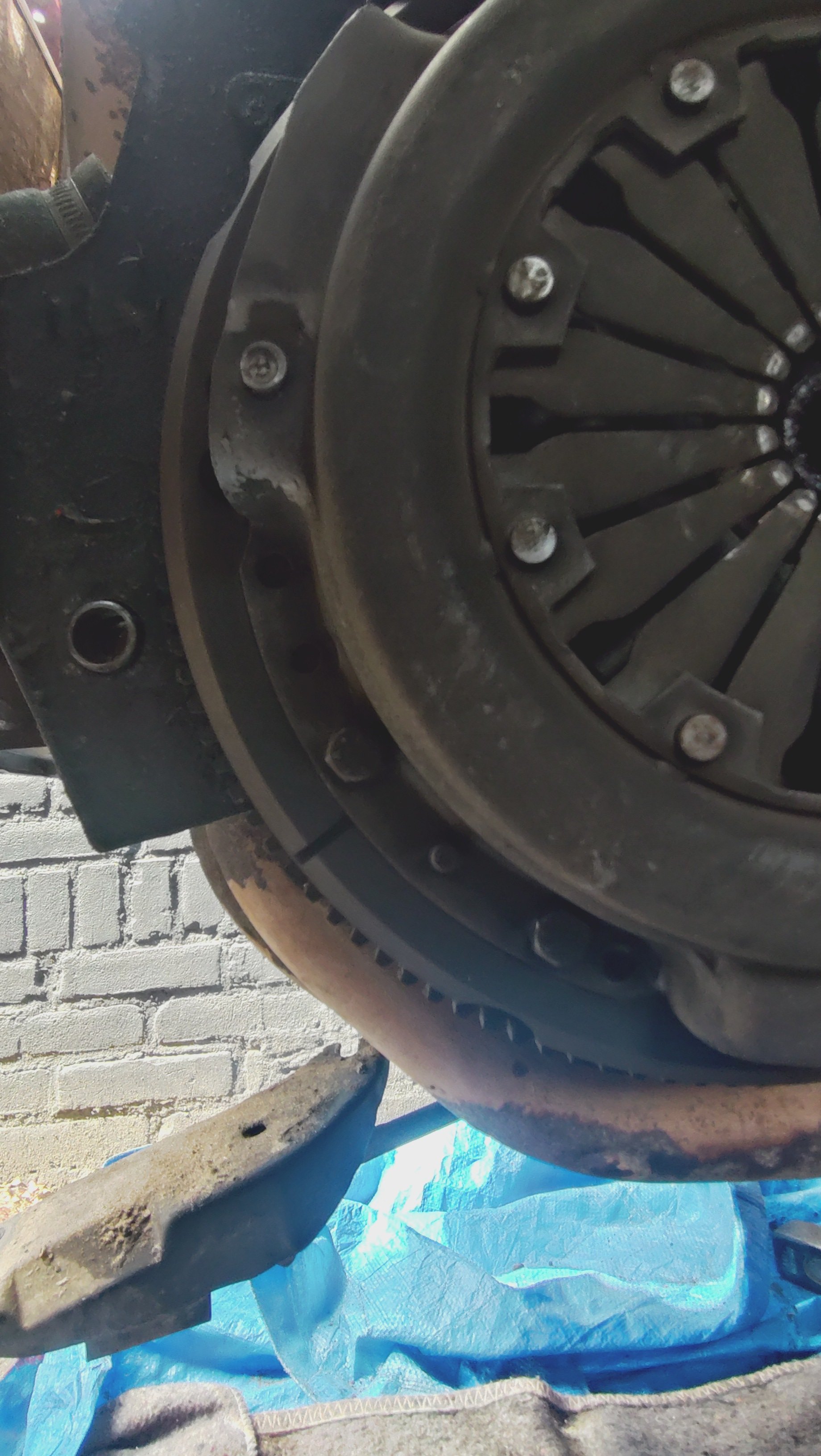

Is it possible it has something to do with other work i did last week and didnt drive after
new rear silencer but connection is not fully tight , leaks a bit exhaust gas
replaced clutch and have worked a lot in engine bay. Maybe disturbed something accidentally?
Vacuüm hose was pulled of carburateur and bit ripped at the end but i cut bit of and put it back on carb nipple
Any vacuum /air leak will affect/weaken the fuel mixture and cause backfiring, also air leaks on the exhaust, particularly on the over run down hills.
Just put a hose on the vacuum advance unit and noticed i can freely suck and blow in it. Looks like diafragm is broken so it doesnt react on vacuum
