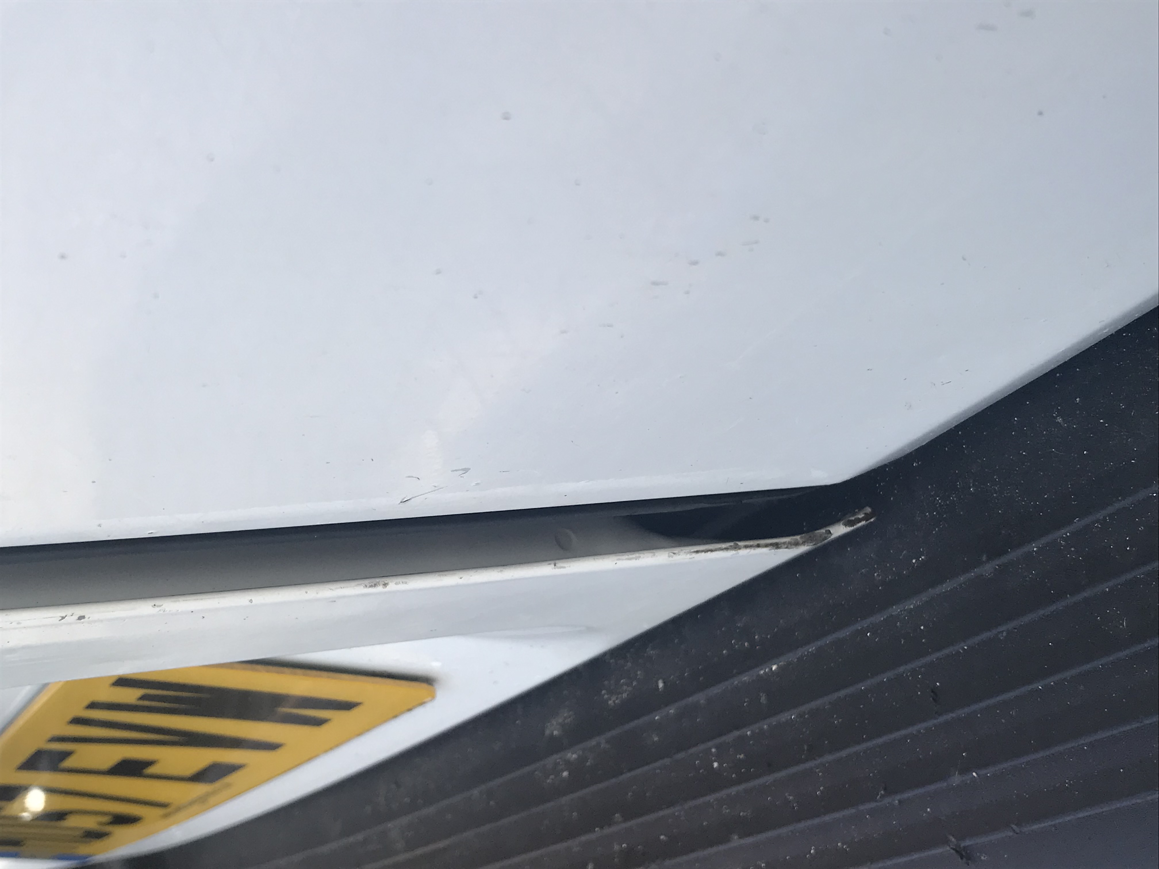

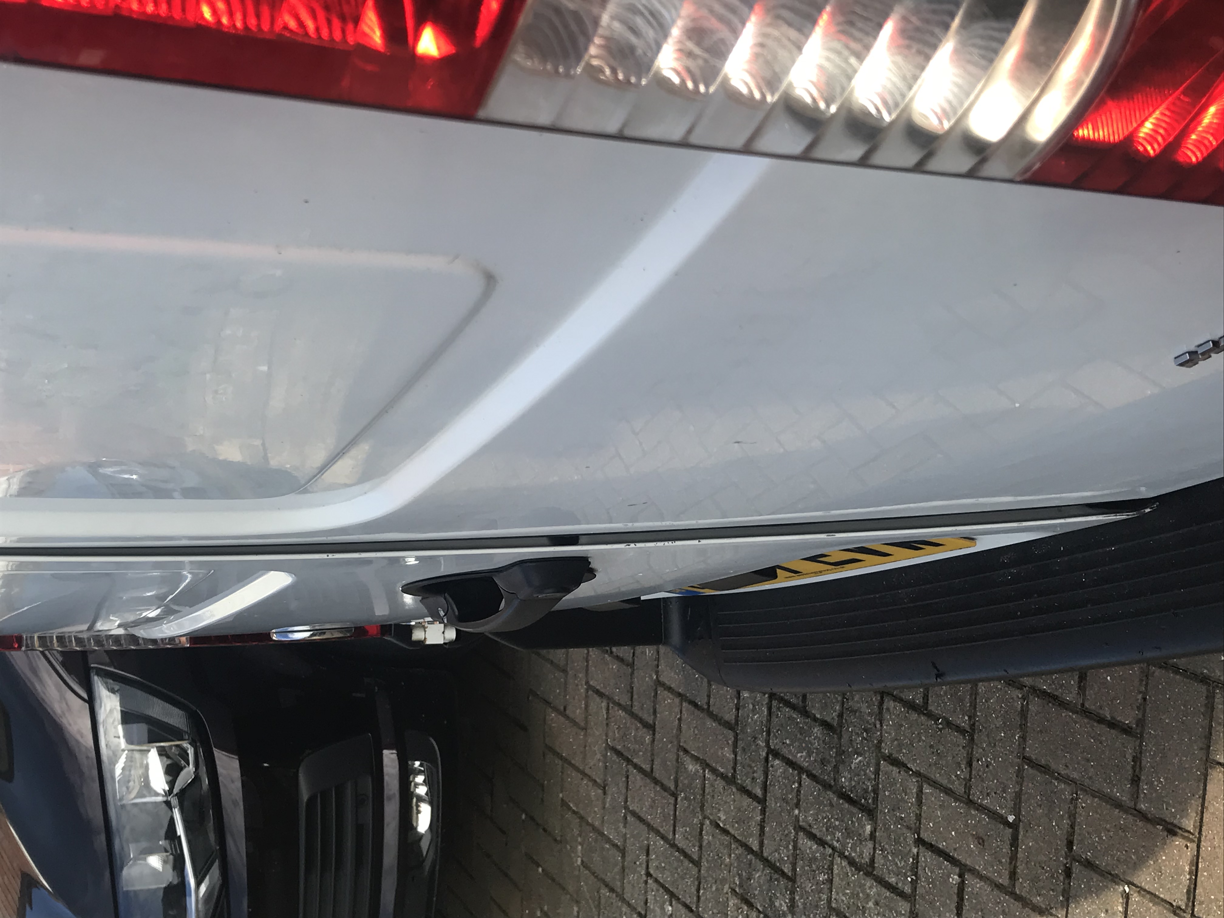

Hi there,
I’m having a problem with my fiat doblo cargo. The back door (split) shuts but the bottom of the near side sticks out - see attached images.
Does anyone know why this happens?
Thanks
Max

Apologises, must of not sent. I have attached them now.

No hinges that side of door, look at the lower door catch fixed receiver looks to be out of adjustment.(Torx bit)

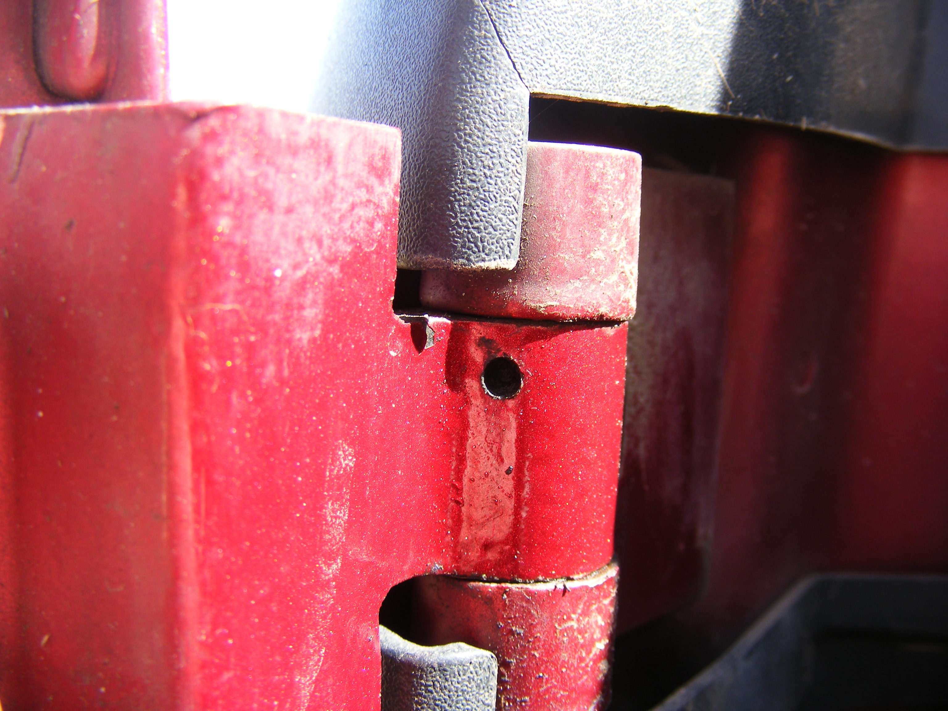

Are the hinges free or do you have to use force to move if so drill holes in moving part of hinge do all 4 as picture 3mm angled down so they will take oil, you will feel drill hit hinge pin just dimple the pin, every one we have had became tight
attachment.php
