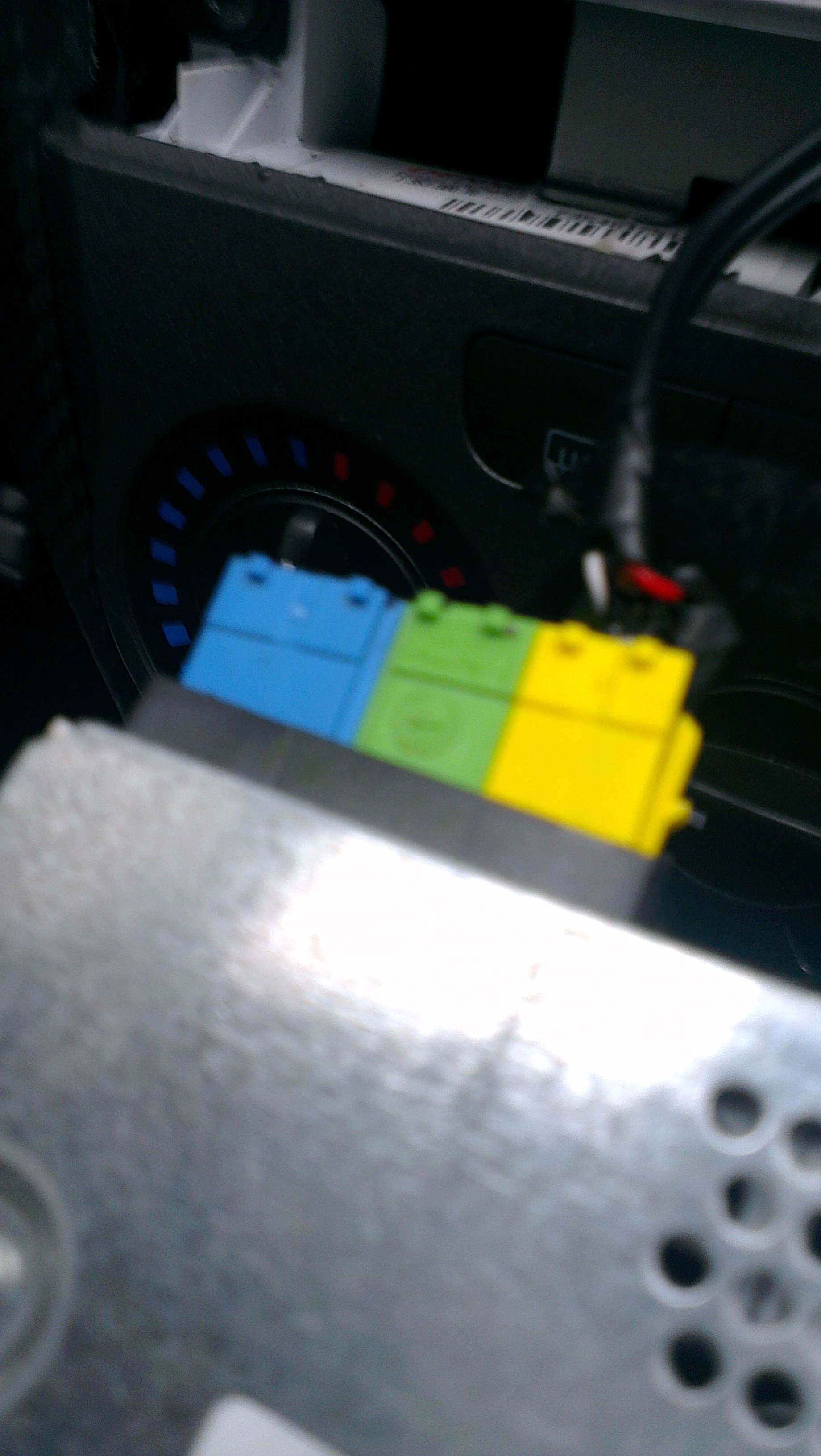

2) Remove the head unit using the radio keys. Insert them into the holes, add a little pressure outwards, and pull the head unit out. Unplug all the plugs in the rear of the head unit.

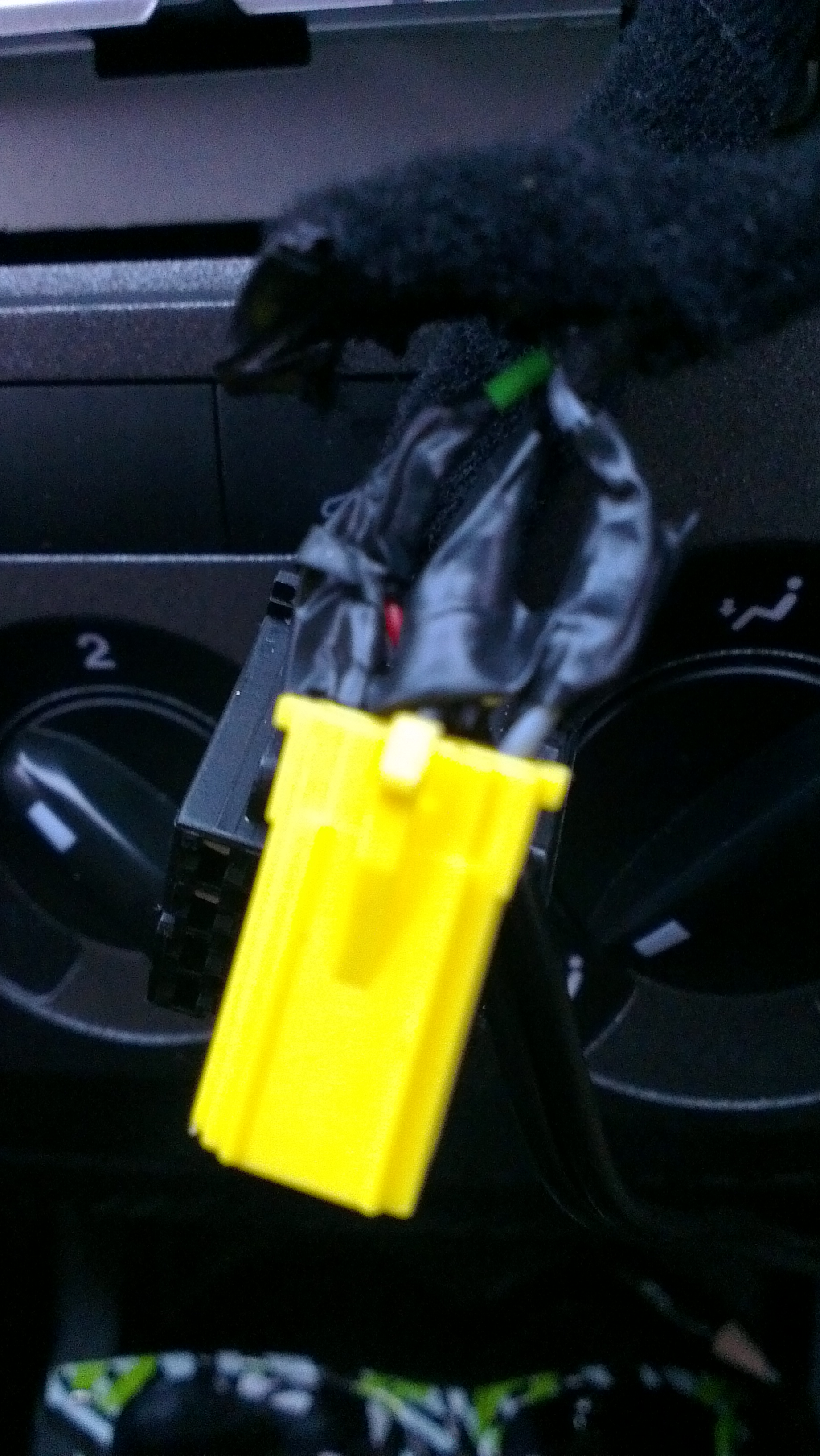

3) Locate the auxiliary input currently going B&M into the head uni. The yellow socket in the photo.
4) Strip back the velcro stuff using a Stanley knife. For this I put the stanley knife in-between the wires and ran it in the same direction of the wires to cut the insulation down the middle.

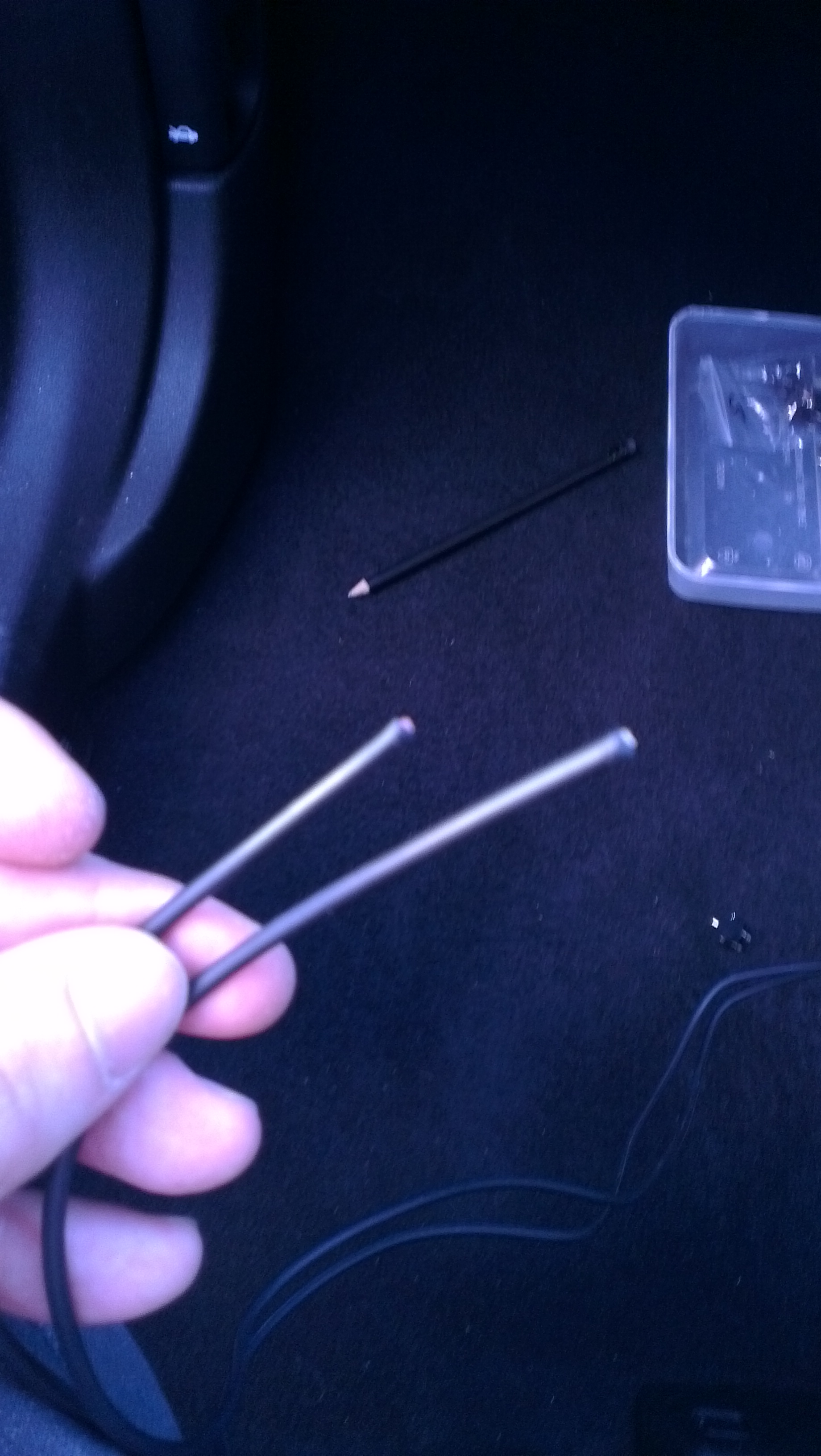

5) Prepare your phono lead. I'm using a phono lead to make it easier to connect and disconnect wires (I'll be fitting a jack into my centre console which will be shown in another guide).
a) Cut off the 3.5mm audio jack.
b) Strip the insulation and twist together the ground wires (the copper wire on the outside of the inner insulation of each wire).
c) Strip the insulation of the other two wires.

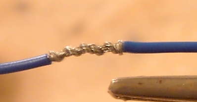

6) Strip the insulation of the current aux input wires from B&M - Strip about 15mm off each wire. I'm sorry that I didn't get a photo of this one. But you want to strip the insulation about an inch away from the socket. So that another wire can be spliced onto each of the three wires. You'll want each wire to look like the photo below.
7) Splice the phono wire to the aux input. Solder the following wires to each other...
Grey to White
Black to Ground
Green to Right.
Tape over all the connections with insulation tape to stop the wires touching eachother - Don't laugh at my dreadful soldering
Grey to White
Black to Ground
Green to Right.
