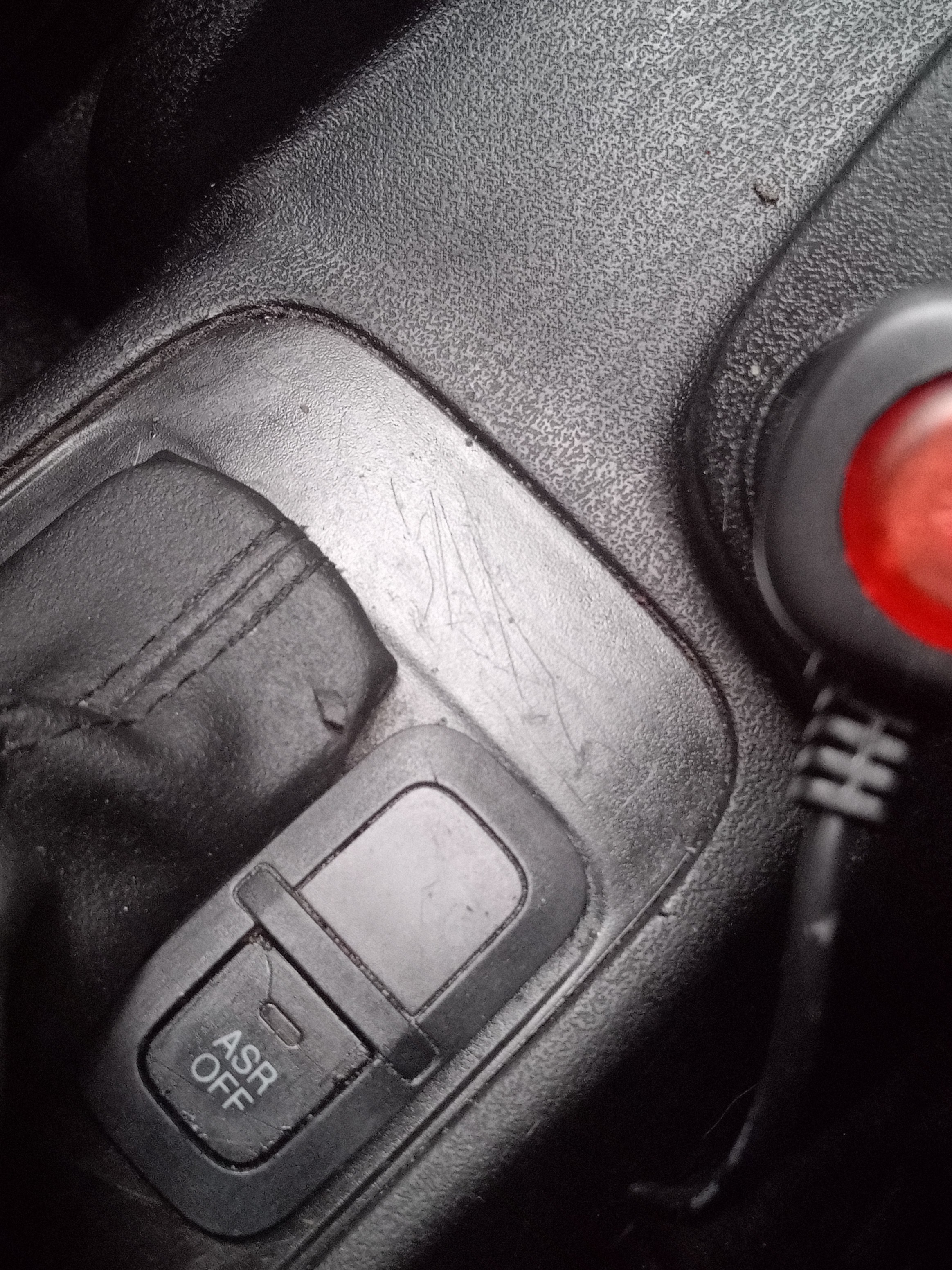

Hello everyone can anyone tell me where I could get a ASRS switch as shown been trying everywhere including Fiat.Thanks

Issue solved with the ASR switch where it is situated it's prone to getting dust probably coffee spills mine never worked since I got the van so I took the switch out you can separate it quite easily 4 small tabs and it comes apart you will find a small circuit board like mine all covered in dust and stains I got electrical cleaner and gently cleaned now there is no spring as such just a little rubber type which is enough to work the return be careful not to lose it the button itself was clogged safe enough to put in a dish and give it a good clean reassembled it quite easy and now works perfectly so if anyone thinks they need a new switch just take it out and give it a good clean
