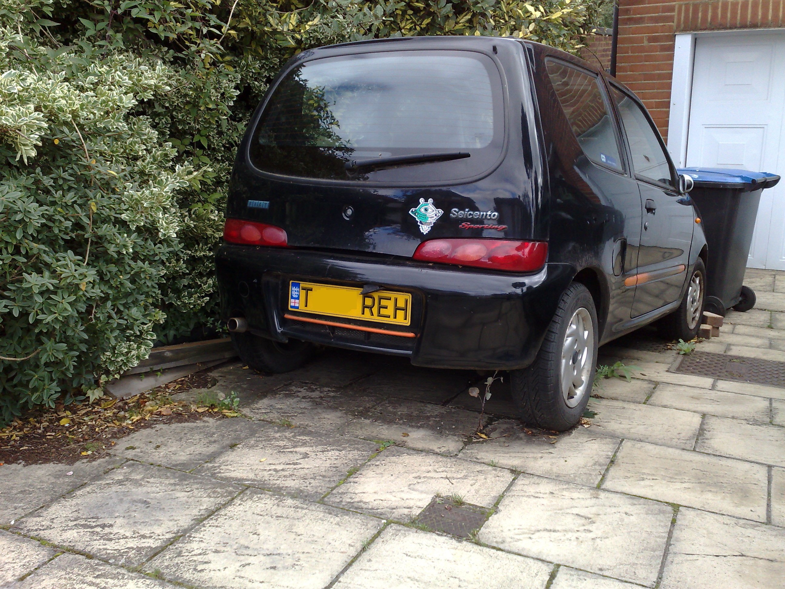

Hi all,
I recently won a new Uno manual locally on ebay, went to pick it up & saw a slightly battered 1999 Sei Sporting on the driveway, half of it covered by a bush (same kind of situation I found my 750 panda in!), so obviously I asked about it... The lady said the family had had it from almost new (a friend got it new) & it had passed backwards & forwards between the children & parents since (10 previous owners, 9 are family members, some several times!). Its last journey had been to Poland & back & it had behaved perfectly, but it had been sitting there for a year or 2 since, & although there was nothing significantly wrong with it she was going to scrap it soon.. Well, I hate waste, especially of Italian cars, so I offered her scrap money which she accepted. :)
She started fine with a jump, no funny noises or smoke, no excess crank pressure, ran smoothly, fan cut in & out properly, & other than the Injector/ECU light being on, nothing to worry about.
Anyway, cut a long story short, I got a battery & wipers & MOT`d it (had a couple of advisories, the warning light, a sticky handbrake arm - which I loosened in front of him - , a weeping rocker cover gasket & a tired tyre) overall it did much better than I was expecting! I then taxed it & I got it home (& swapped the mouldy, ripped interior with a Schumacher one that I got from unclebloodyfester - thanks mate! :D ).
Now, it runs smoothly, but if you turn it off when hot & restart it, it idles very high, like 1500rpm high, for 30-90 seconds or so, it also chokes when changing gear when its doing it, like its over fuelling.
I went out in it last night, did about 30 miles to run the slightly stale petrol low, I then put a load of Redex in till it was scarily low, then put another £25 in & did another 15 miles, but the problem still persists, & the injector light is still on the dash. Also, after starting (after a 2 hour break) the yellow "code" light didnt turn off, though it ran exactly the same.
Any ideas? I was hoping it was where it had been sitting so long, but I`m guessing its an injection sensor or connection issue?
Also, if anyones breaking a Sei in north London/Herts, let me know, I need some bits ;)
Cheers! :)
