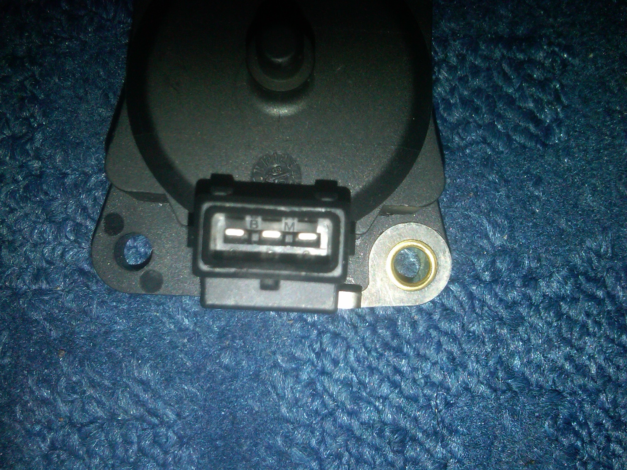

BTW this is the 3 bar MAP sensor im guessing that the third pin is earth as it has the metal plate coming from it so i will have to earth the body off the MAP sensor??

thats the map sensor

right ok, for the pressure sensor wires if you dont have a pressure switch coming off of the mf2 from those wires with a vac pipe then you need to run an external map sensor for the mf2, so keep your original exactly where it is then run the 3bar map sensor for the mf2 then you need a vac pipe coming from that map sensor t pieced into your vac lines for reading boost, hope that helps. Gaz
