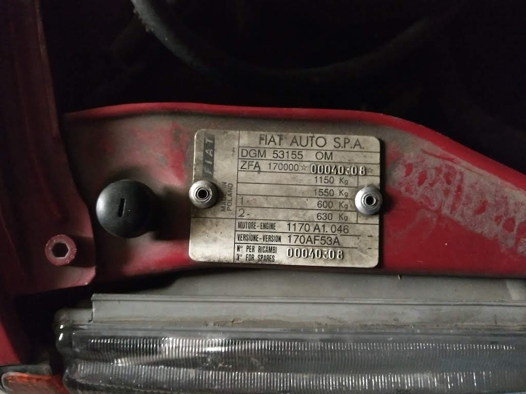

A friend of mine has just had his cambelt go on his Cinquecento and I rather optimistically assured him that it wouldn't be a problem because it was a 'safe' engine and we could fix it together, no problem.
Then I realised that it was the 8V FIRE engine that's safe, and I have got a horrible feeling that this one isn't. But as hardly anyone seems to run this engine there doesn't seem to be much info out there.
Does anyone know the answer? I have attached a pic of the VIN plate.

This is the 900cc ohv engine with a chain drive to the camshaft. If the chain has broken there will be other bits needed, like tensioner, lock tabs, gaskets, seal, etc.
No idea if it is a safe engine, hopefully someone will advise later.
Meanwhile, check the valve clearances. Bent valves will have larger gaps, but if he's run it until the chain has broken, he'll have been ignoring a lot of noise, so valve clearances may be a bit wide anyway.
You could try to turn the engine over very slowly, by hand, and feel if anything connects.

And thanks to those who have pointed out it's chain driven - I hadn't thought of that, and it was only after my friend had told me that I realised it wasn't a FIRE. Sounds as if we could be in luck! And I think he probably means the ALTERNATOR belt rather than the CAMbelt, although he just said 'courroie', which in French can be either. And thanks to EdwardHooper for the spare engine offer, although it sounds as if we may not need it (but I will check!).

So yes it is just the auxiliary belt, which drives the alternator and waterpump.

The only issue would be if he kept driving for some time after the belt went with no coolant circulating.
The gauge sensor on the 899 Cinq is direct on top of the head, so will still pickup the temperature with no coolant flow.
