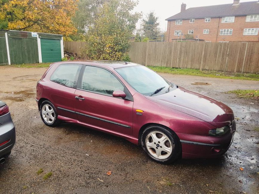

So after parting ways with my black HGT and tgunking that would be it, no chance of ever owning another, i got a phone call from an old friend with a proposition ....
A 1 owner Boreal Red Italian spec Bravo HGT
130,000 KM
Full service
Never been ragged or messed with
Even came with italian documents
And the original pouch with the red and spare keys ......
Obviously theres a catch ....
It needs a new paint job as its been sitting for a few years only going out to the shops on occasion .....
Pleased to be back in another but this one wont take up daily duties .....more of a restoration and then weekend toy along side my 20vt HGT IMG_20201028_180354_062.jpeg

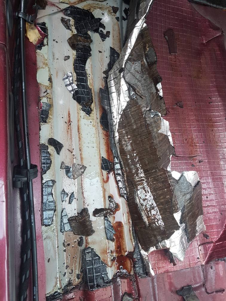

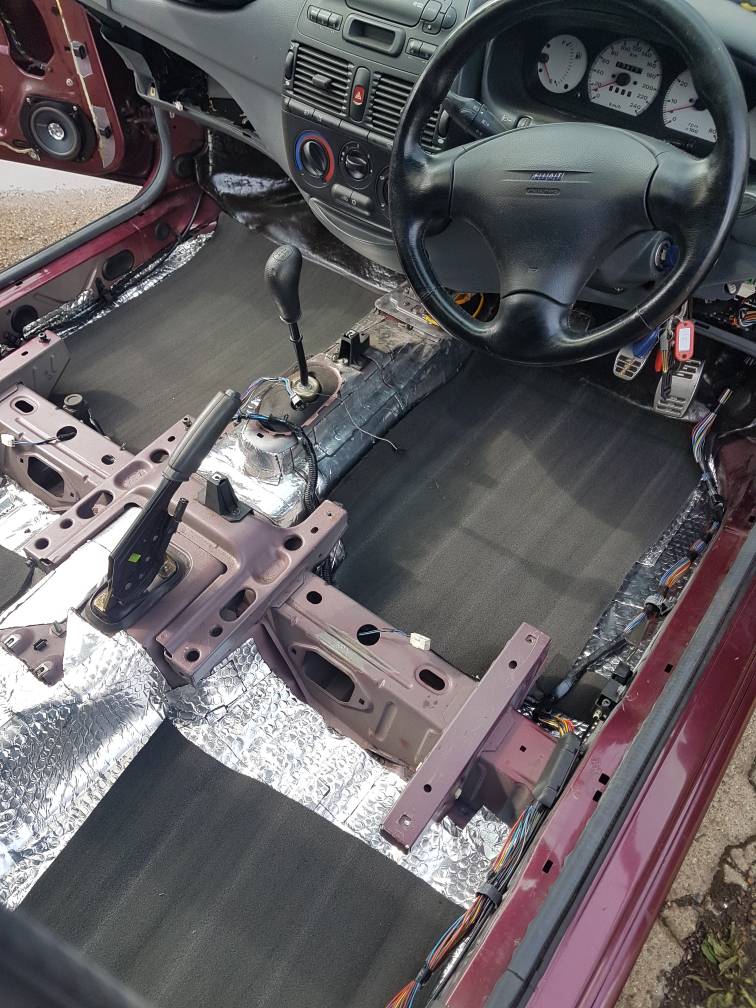

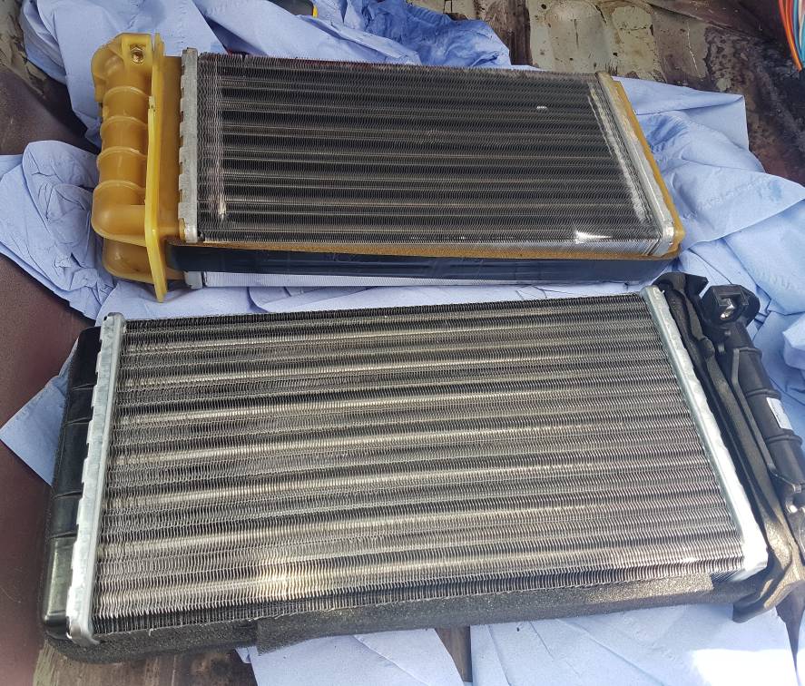

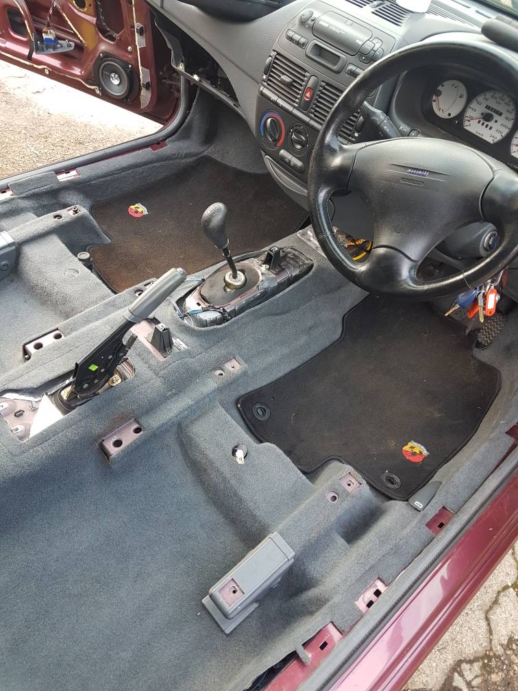

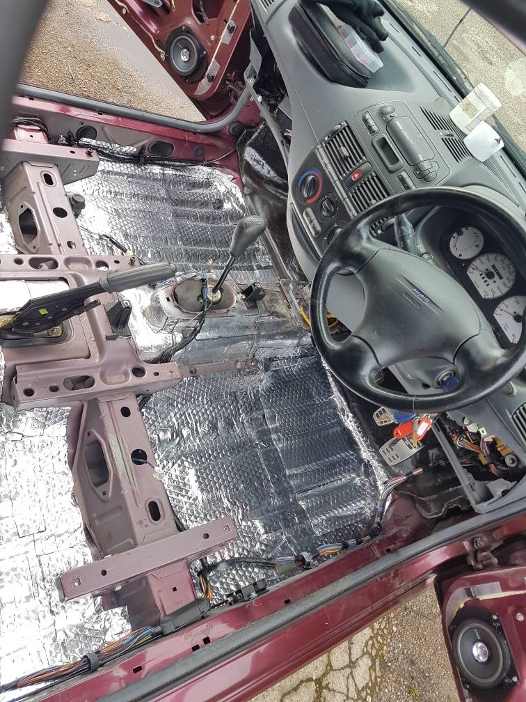

So ive been finishing the Deadmating on the HGT, added some extra foam sound deadining.....
Also had to replace the heater matrix whilst i was under there......
Interior is all back toghether now awaiting its MOT test ...
Some clean new numberplates

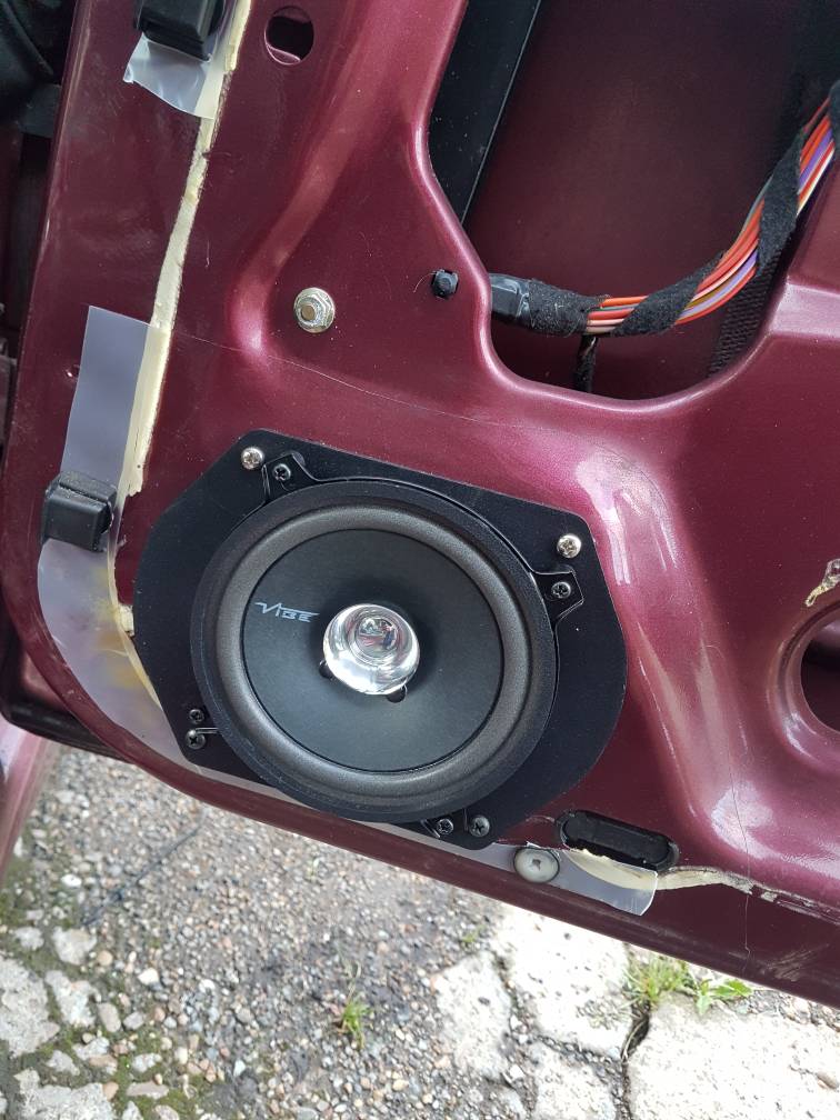

Also had to change the door speakers as the originals were completly toast ....
Couldnt get new OEM one so aftermarket would have to do.....

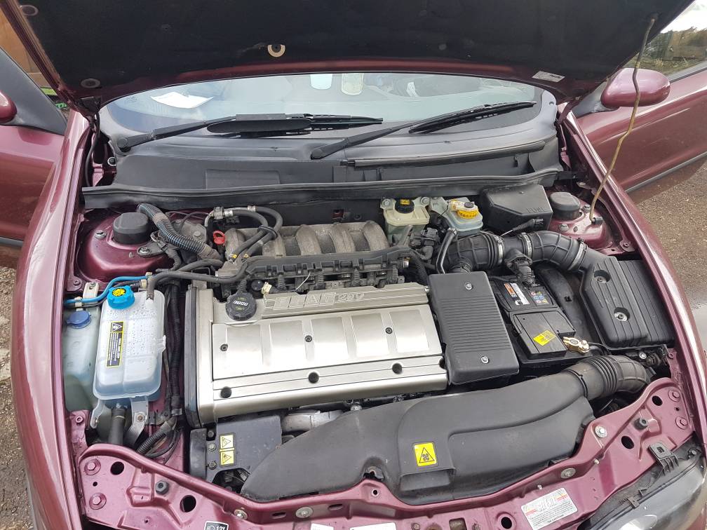

Did a few bits on the engine aswell to keep it sweet for now and its looking alot tidier than before .....20210809_154959.jpeg20210809_160903.jpeg20210809_170422.jpeg20210809_170431.jpeg20210810_174928.jpeg20210809_172909.jpegIMG_20210804_173047_447.jpeg
I see you made some adapters for the weird door speaker install... a few years ago I found some special aftermarket ones on Ebay (from Pioneer I think) that had the special shaped plastic frames... before that I had cut out the centre of the factory speakers and fitted a hardbiard plate to mount some 4" speakers.
Even the rear speakers need adapters when replacing with aftermarket...
Tidy job. Bit of a job but well worth doing to get rid of the factory rubbish. Is it quieter, noisier or the same?

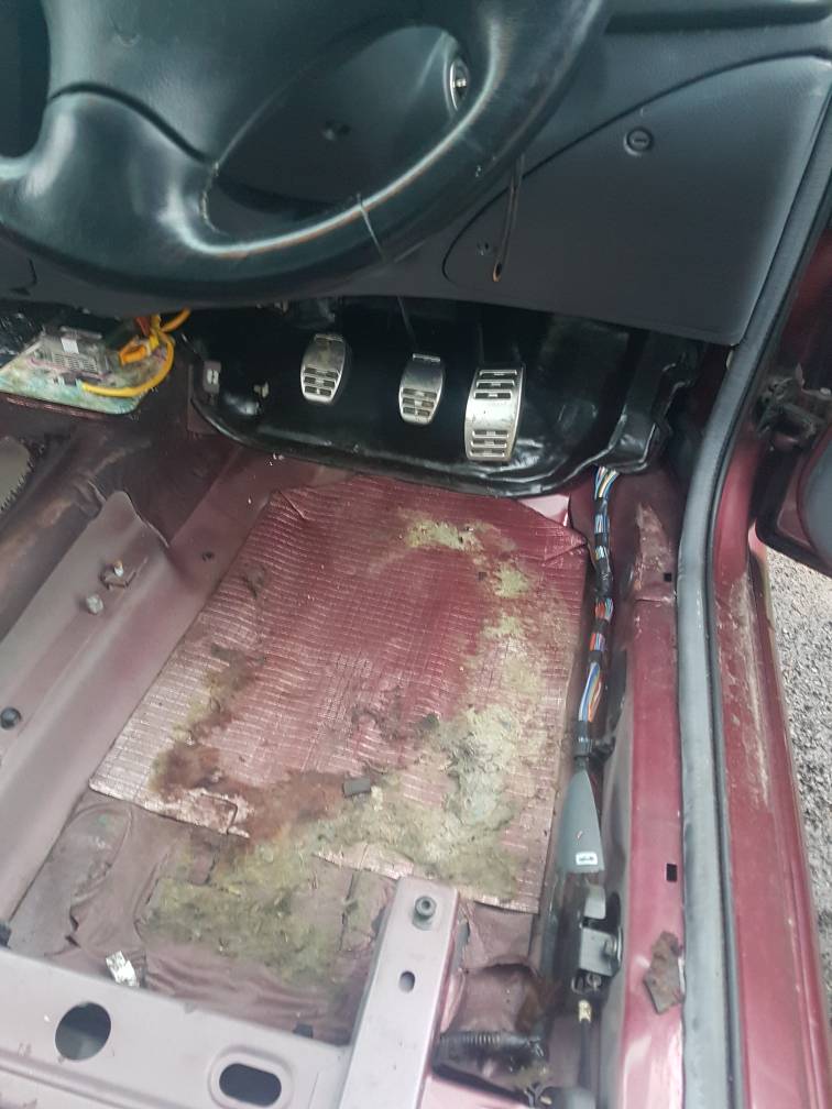

Can you tell the kidz where the damp comes from? My Tipo (same floorpan, insulation materials) has wet underlay just under the pax feet, but not from the front e.g. matrix, evap, drain areas are dry :confused: Osmosis? Cheers J
These were from the Fiat Lineassori catalogue.....
I found them on ebay italy back when i had had my black HGT so i bought 4x pairs [emoji1787]
Theyre origininaly made by Blaupunkt for Fiat and fit really well .....
rears are a straight fit 5inch component but this car is an Italian spec car with a very basic radio so rear speakers dont have pins in the stereo ..... need to find a good H3 original stereo

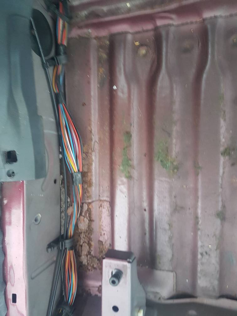

Damp come grom all over, even down to leaving the windows slightly open on a rainy day .....
All runs down a/b pilars and collects in joints and eventually seeps into the underlay ......
Mine was like a swimming pool
Also welding the breather holes on tye floor pan helps massively

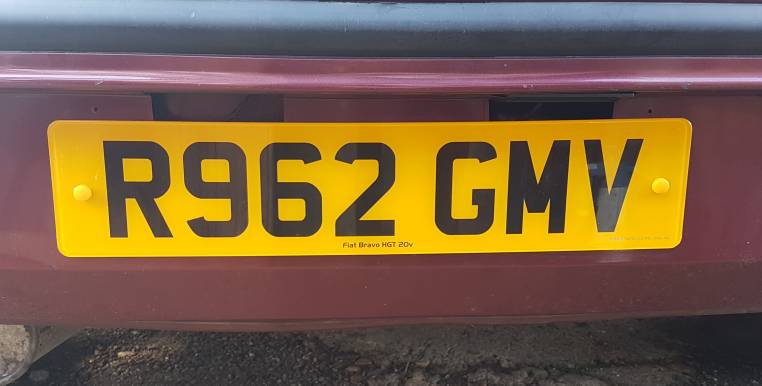

Did a few bits on the engine aswell to keep it sweet for now and its looking alot tidier than before .....View attachment 219521View attachment 219522View attachment 219523View attachment 219524View attachment 219525View attachment 219526View attachment 219527
Those plates are smart Carlos with the writing at the bottom, where did you get them made up?
Got them through an Online store .... they are technically show plates but they have a BS number so i use them on the road .... car doesnt see much use now anyway [emoji22]

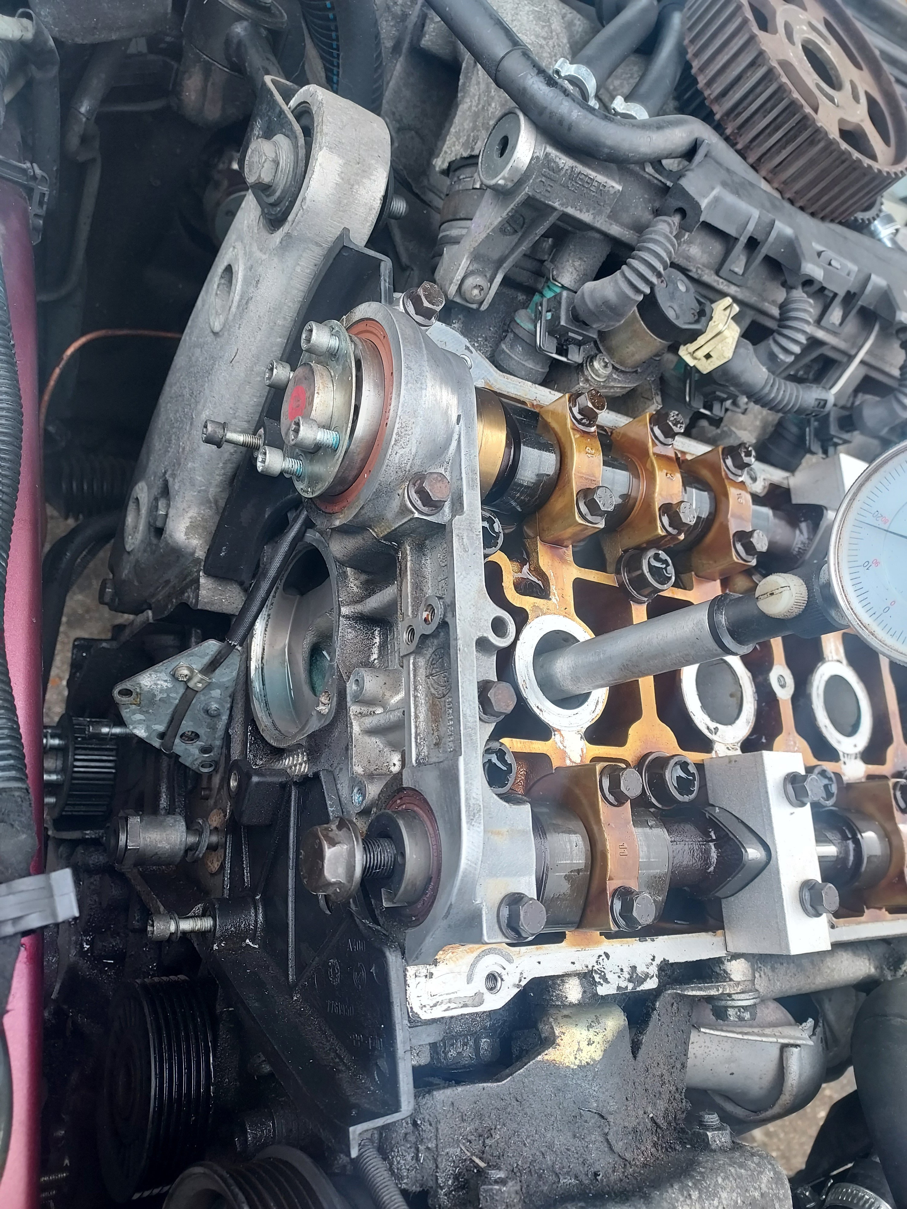

a new clutch has turned up for the HGT has turned up so I will be swapping to a Marea gearbox with longer ratios or maybe even my 6spd Coupe gearbox, yet to decide but at the same time I will he doing a mini refresh of most important thing in the engine bay
timing belt
water pump
engine mounts, stabiliser mount
camshaft seals
rocker cover with new gasket
and a bloody good clean

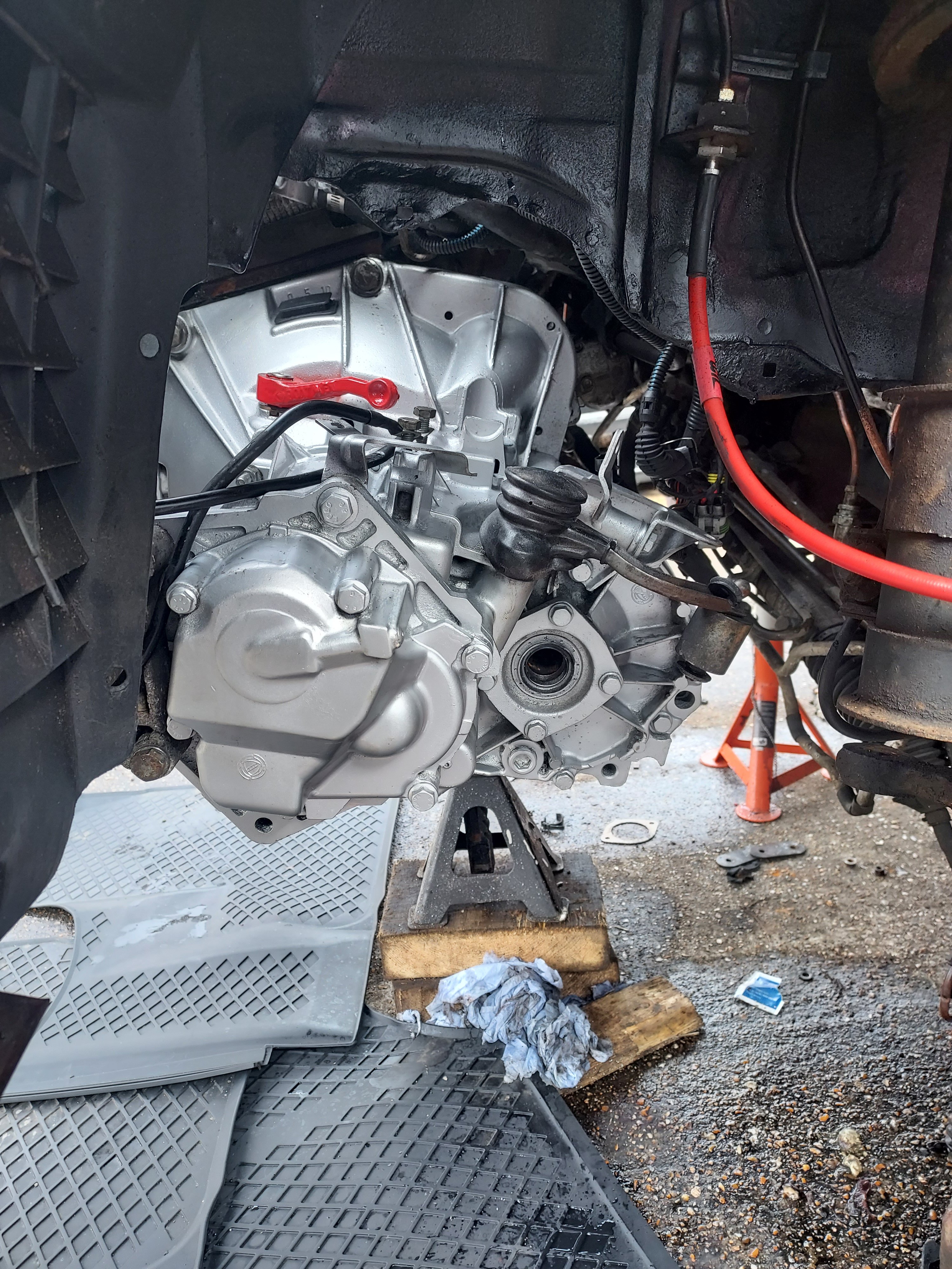

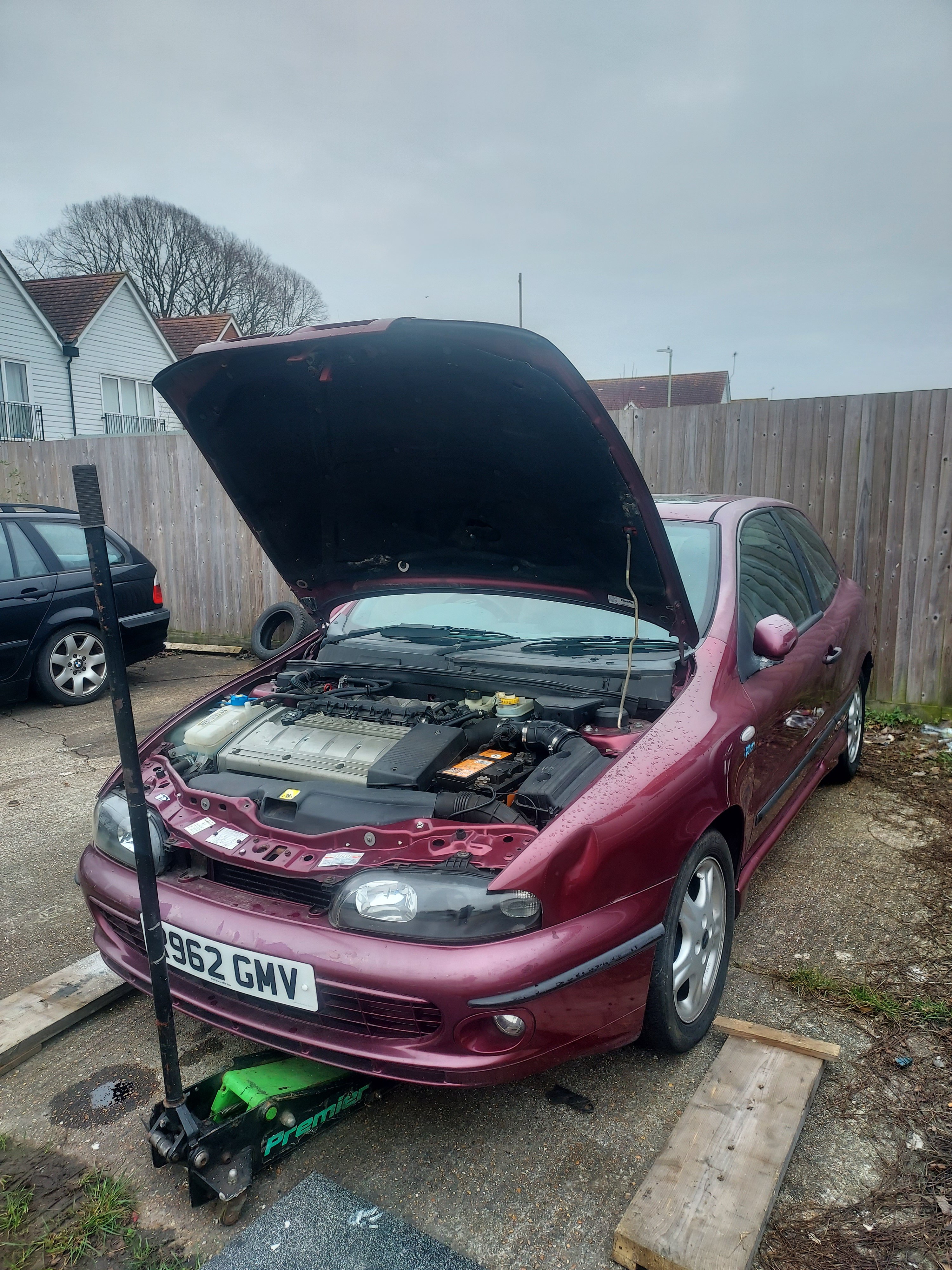

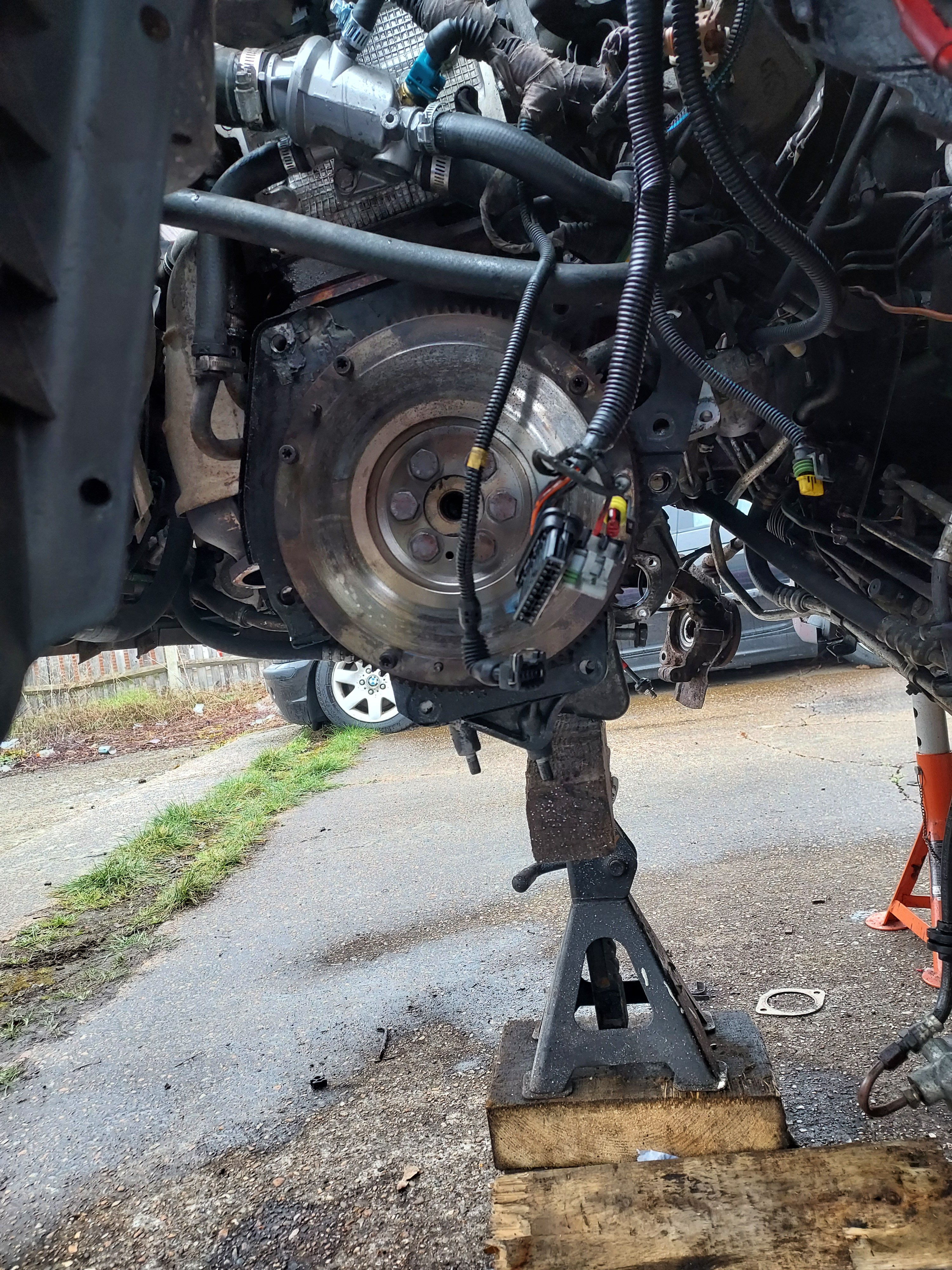

So alot of work has been done recently to the HGT to bring the mechanical work up to scratch ...

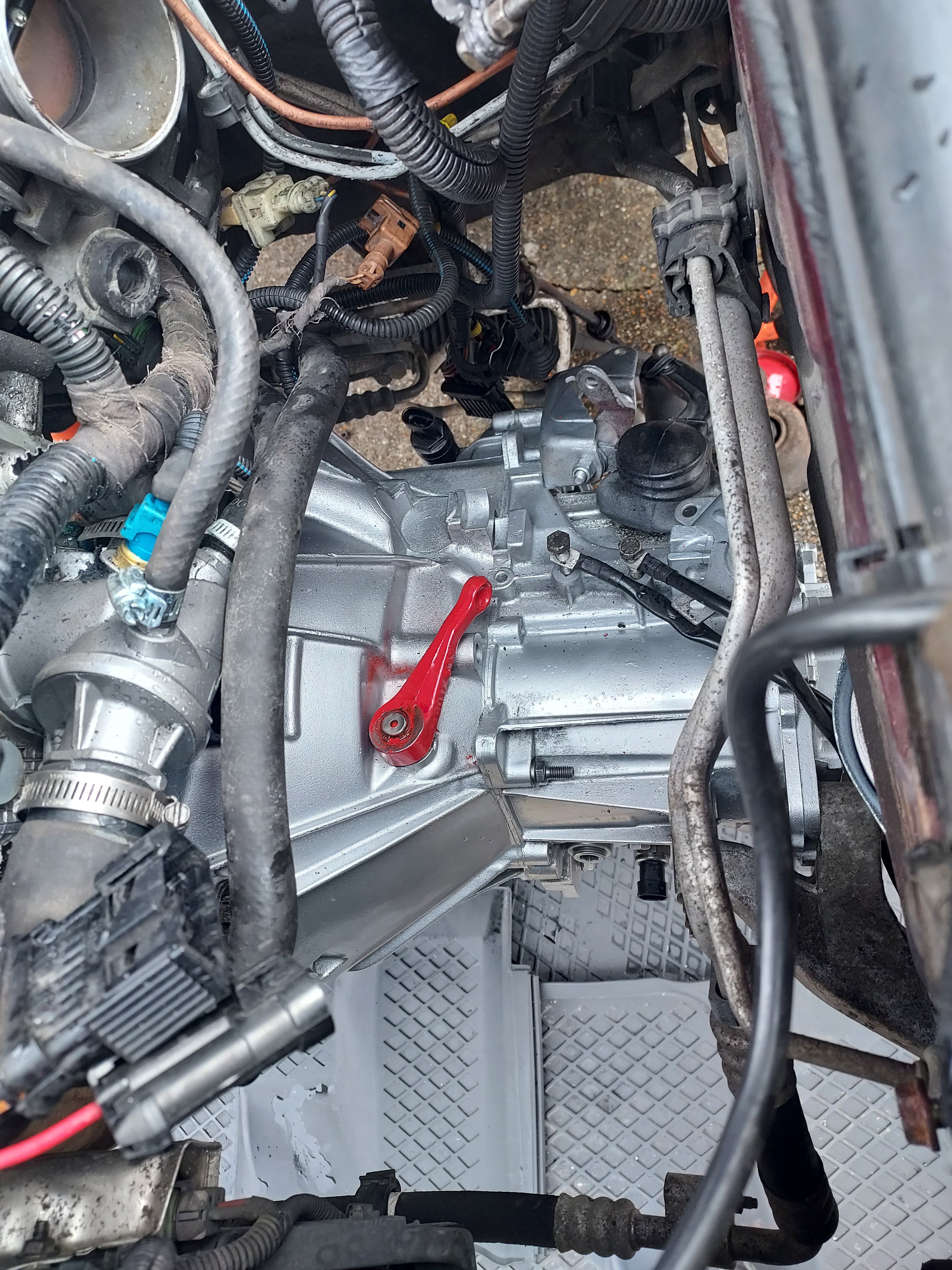

starting with the gearbox......

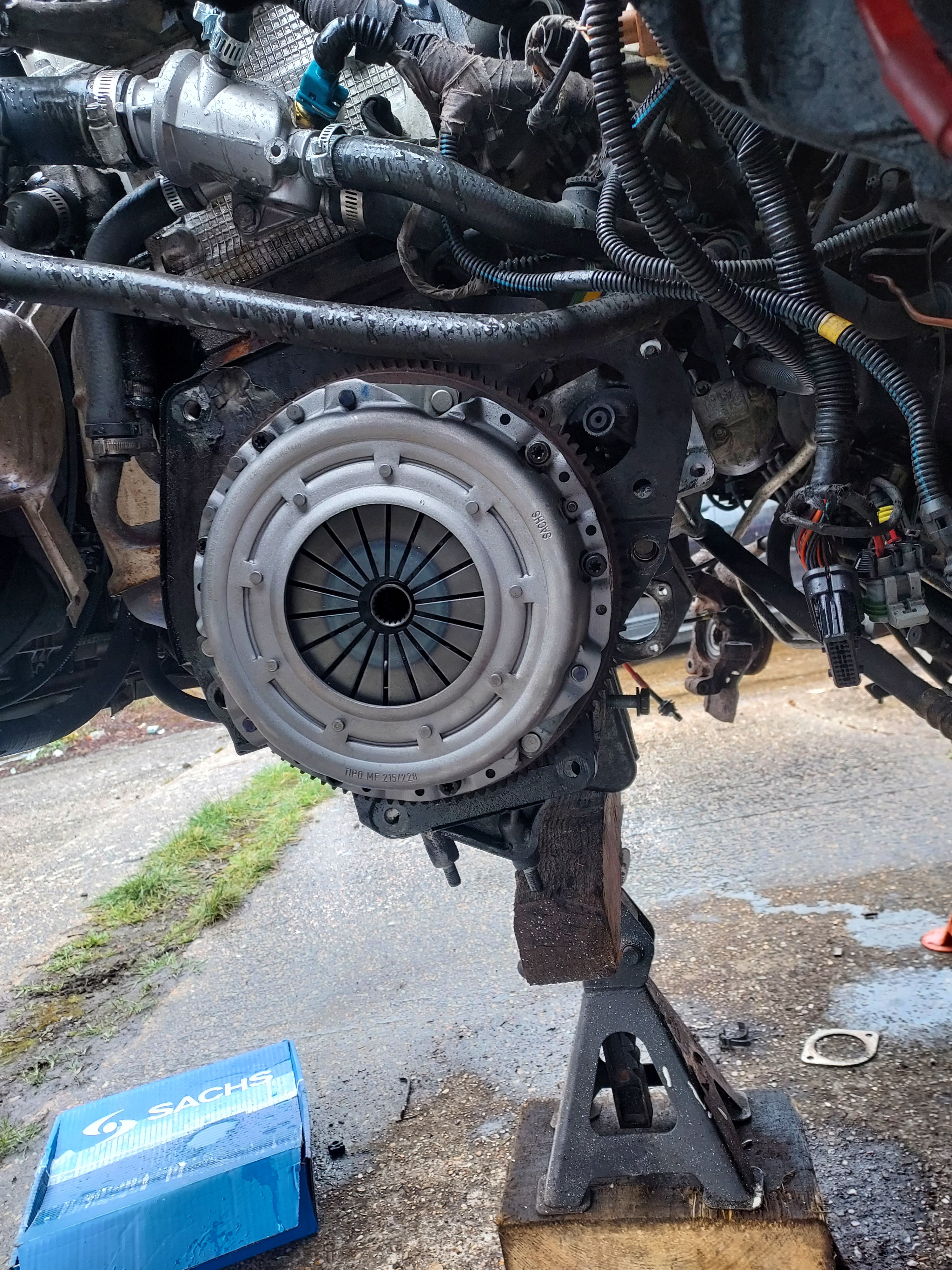

I decided to fit my Marea Weekend gearbox which has slightly longer 4th and 5th gears,
I had the gearbox refurbished before fitting as it was out of action for around 7years, now shifts smooth and cruises on the motorway slightly better than before .....
whist doing the gearbox .... would be silly not to put a new clutch, flywheel and most importantly a new Rear main seal, false economy not to change a rear main seal at every clutch replacement IMHO......
all the clutch hhydraulics were changed including a new braided line in place of the bodge apparently done by a specialist( I'm not convinced tbf)

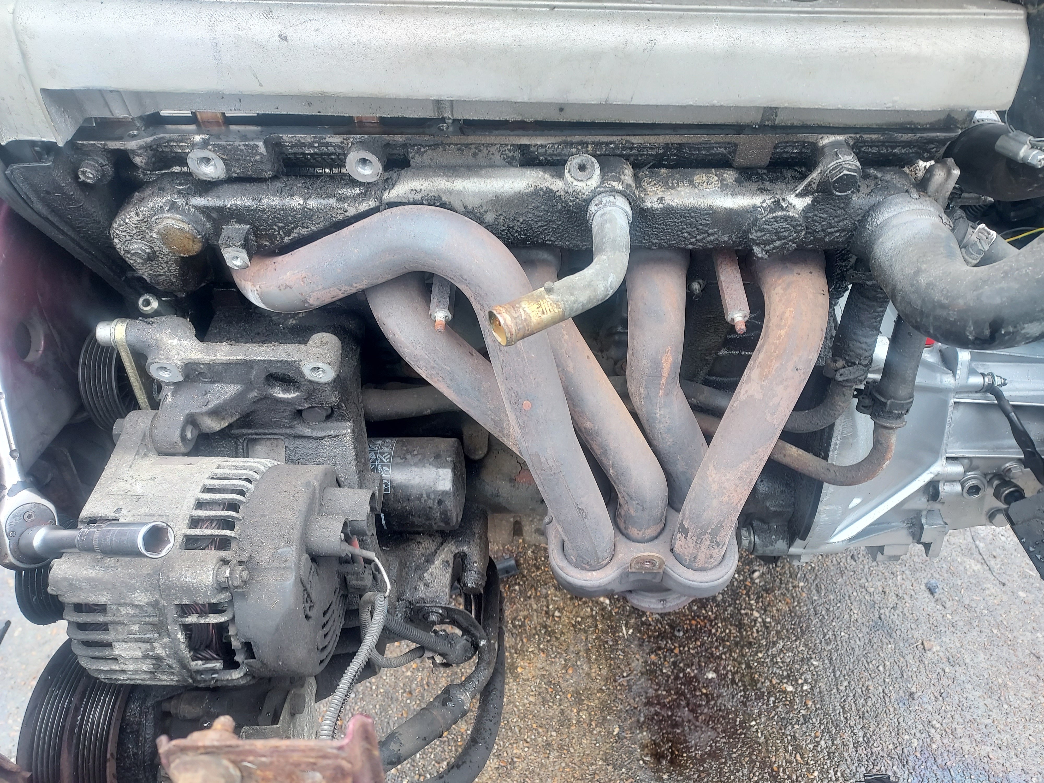

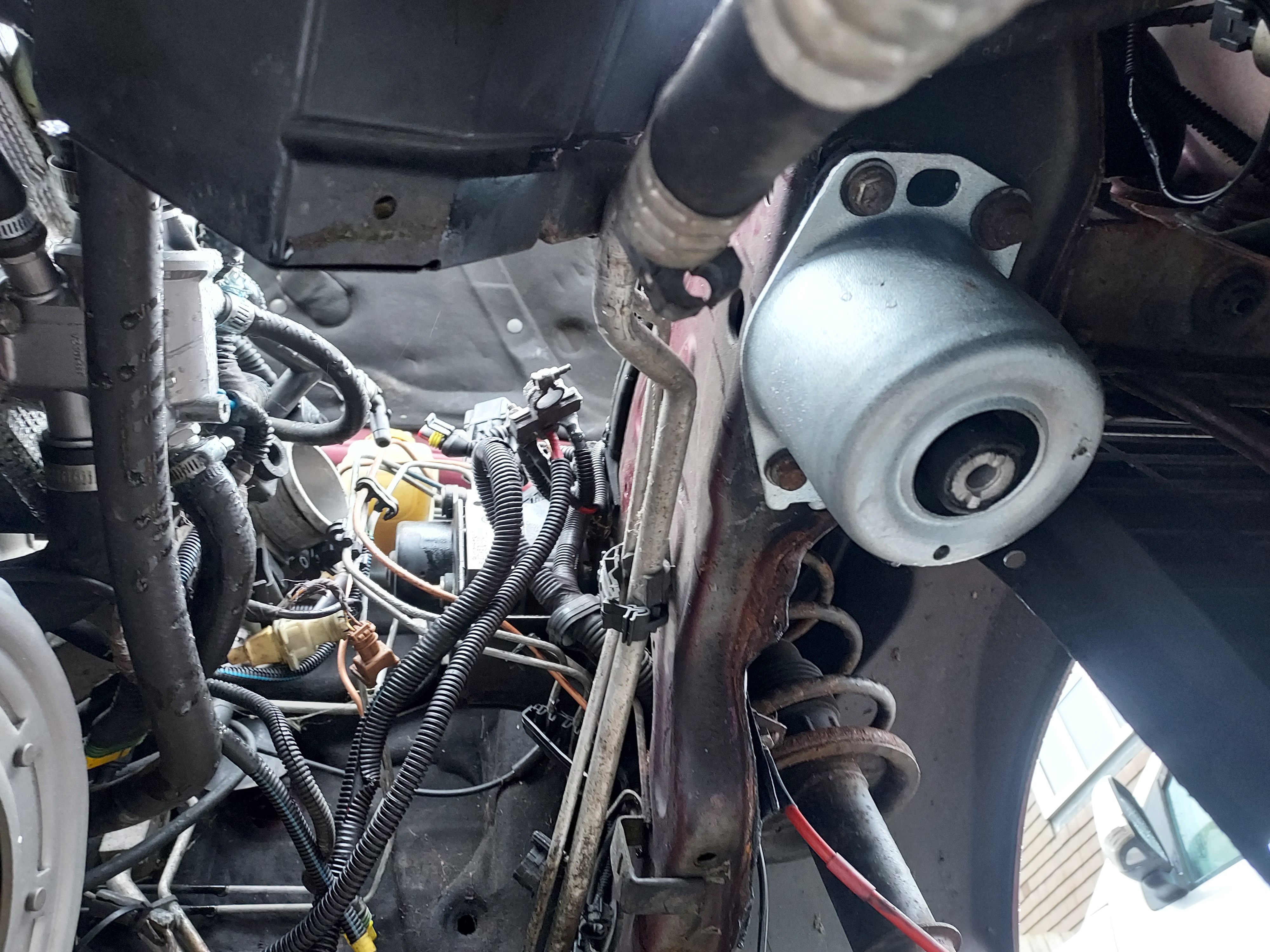

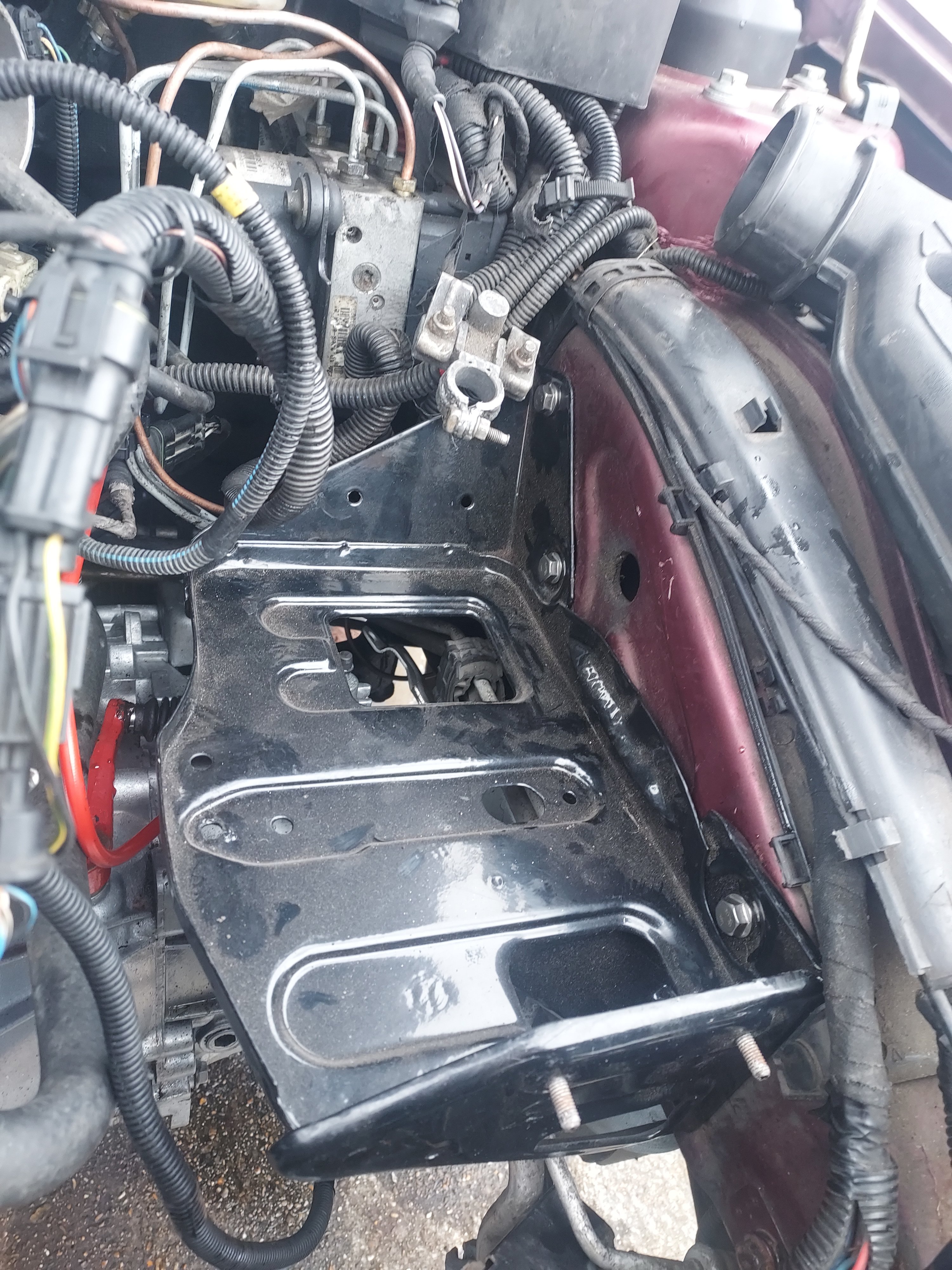

next I replaced all the engine mounts apart from the stabiliser bar as I'm waiting for Powerflex to make a custom one for me .... rest were genuine Fiat items that I managed to find.....

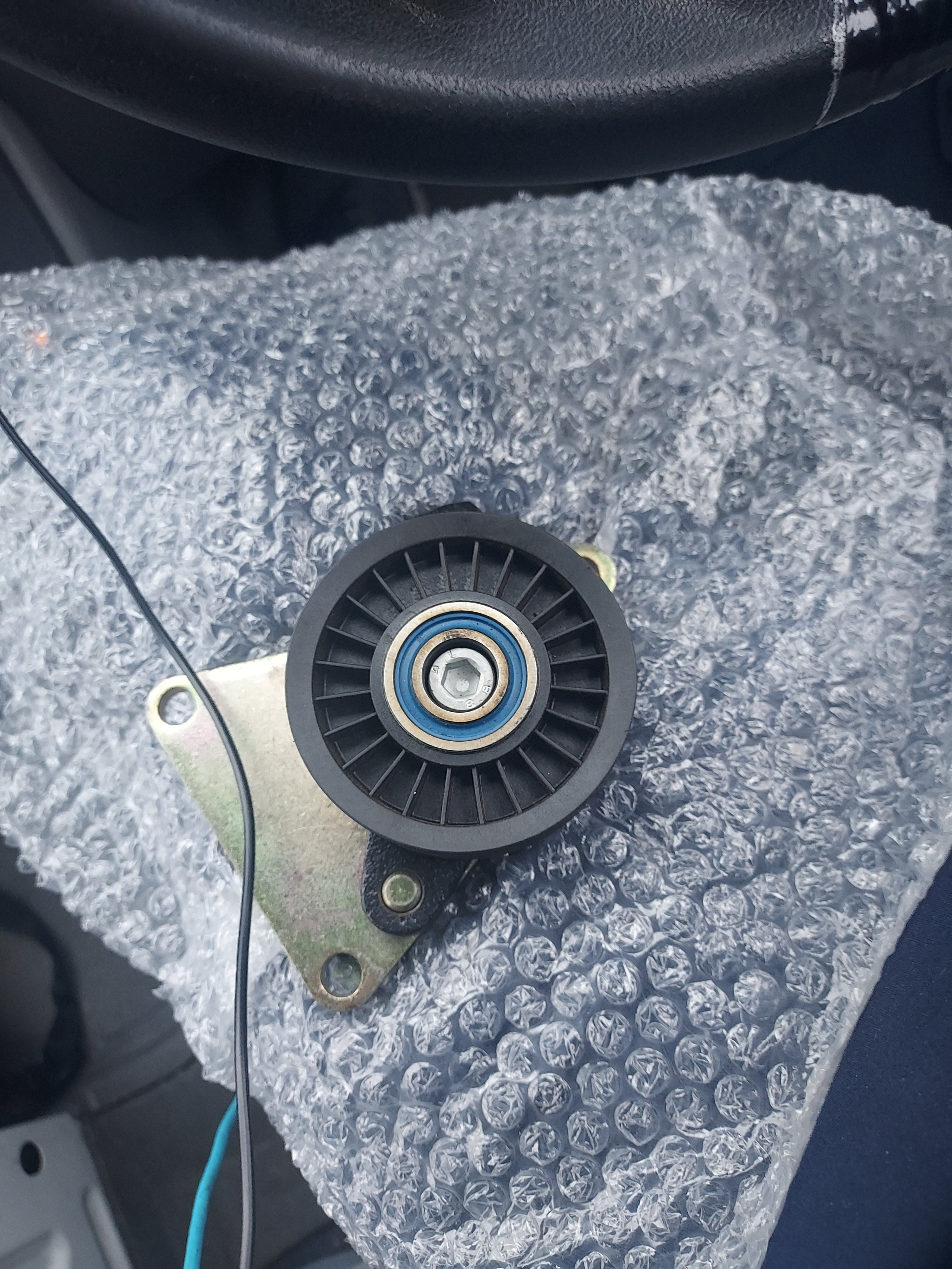

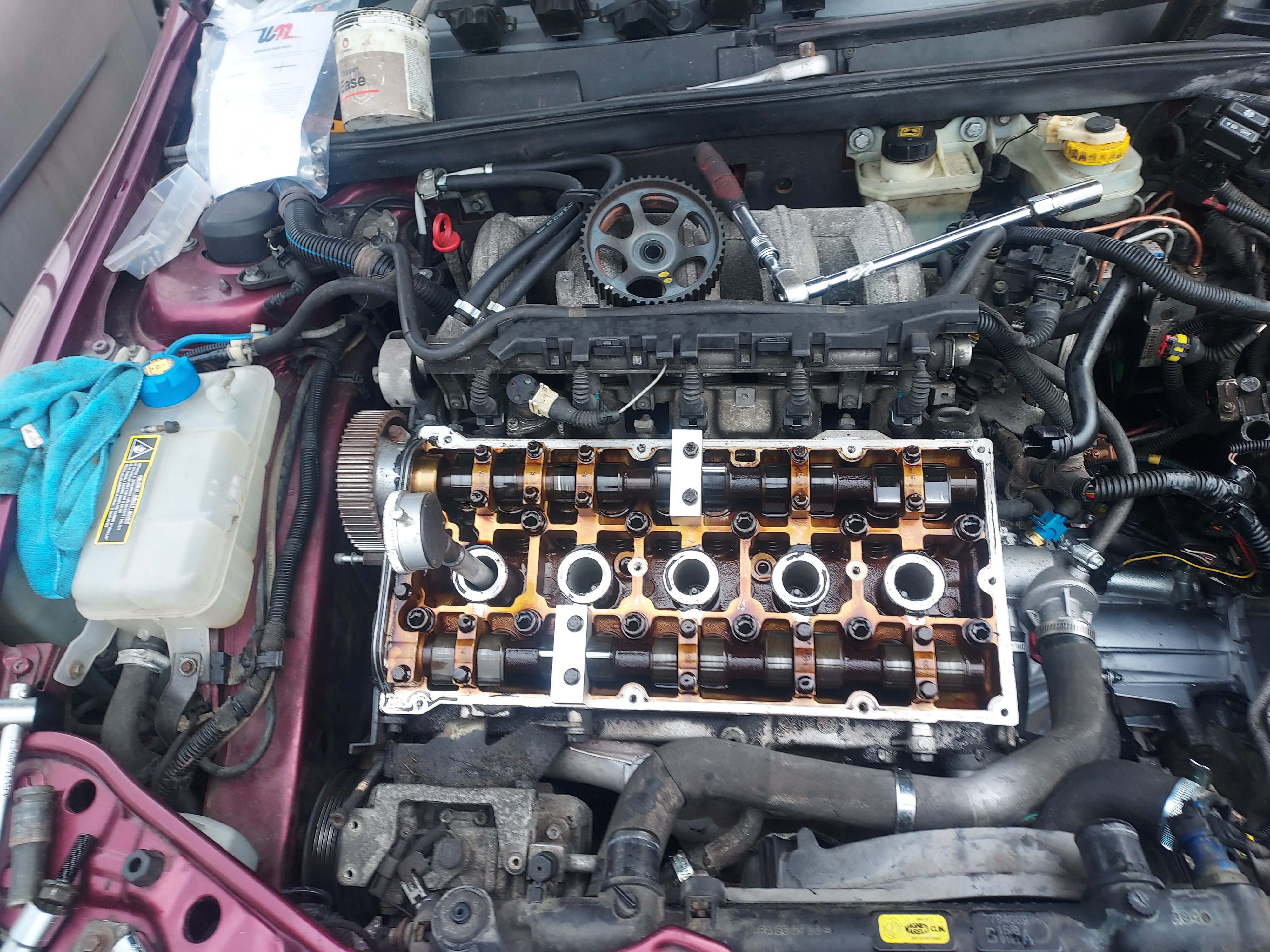

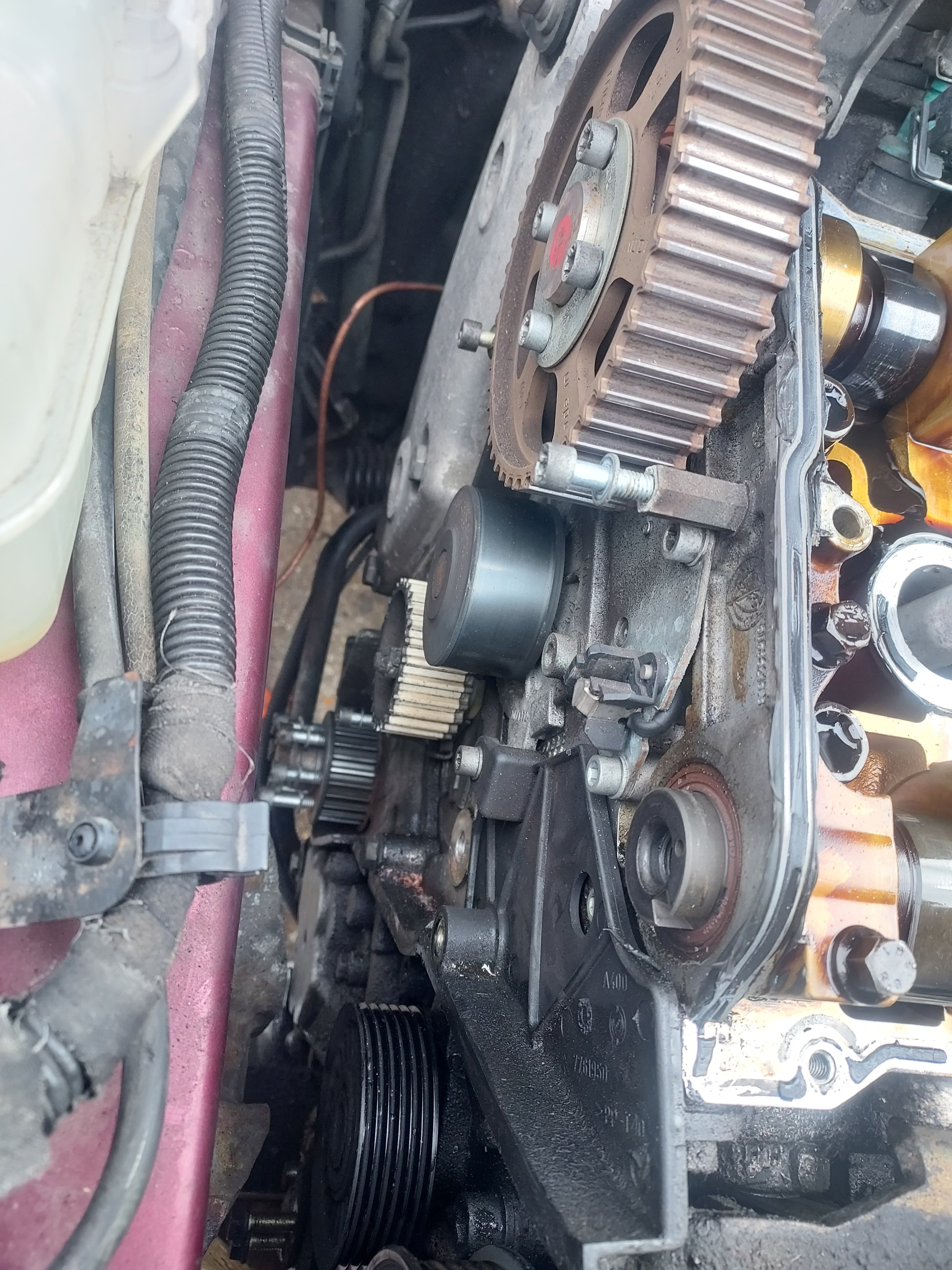

I moved onto the timing belt and replaced all the idlers, even a genuine AC tensioner which is like hens teeth ....
the whole cam side of the engine was fully deagreased and cleaned and all nice and shiny 🤣

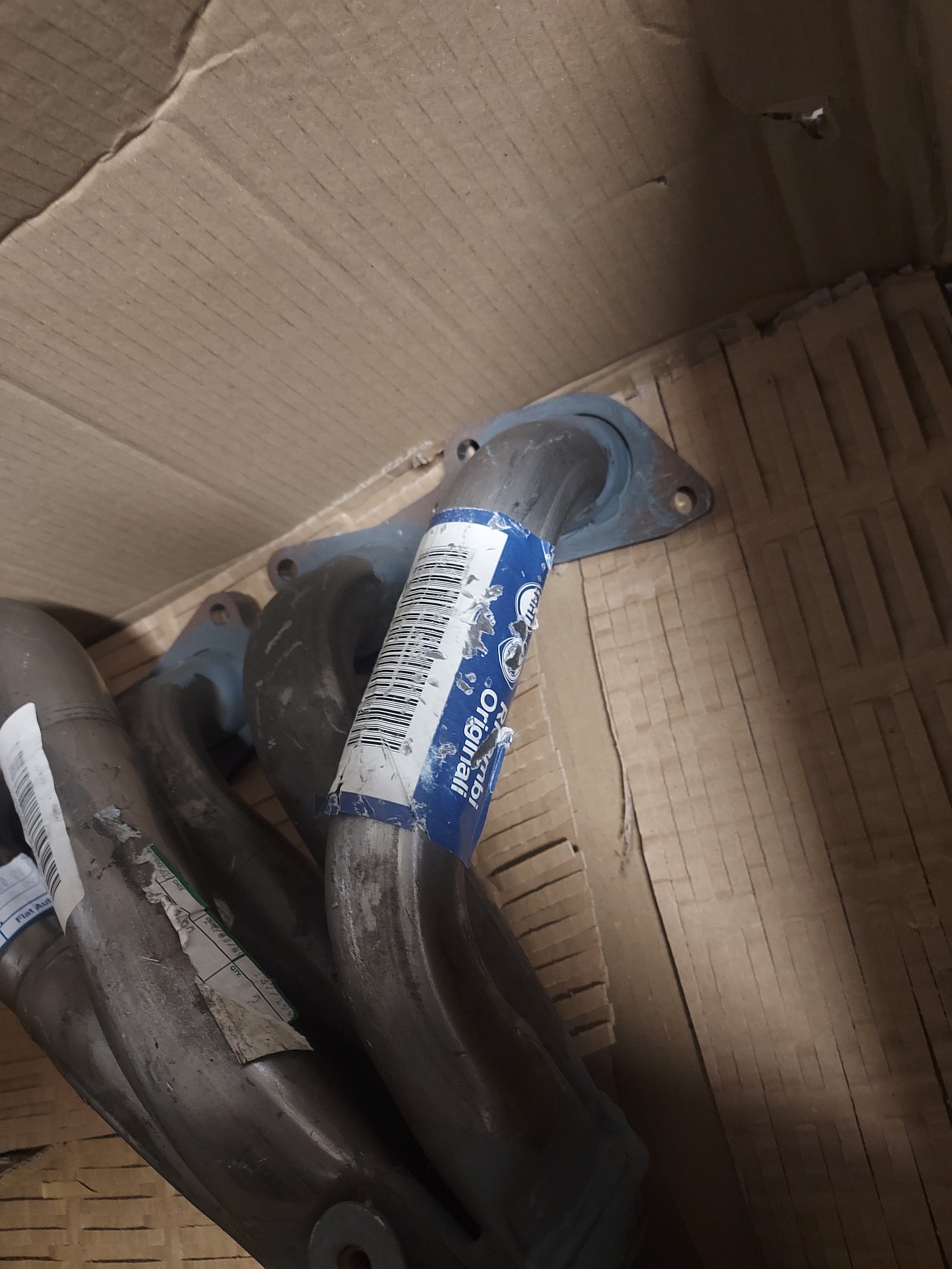

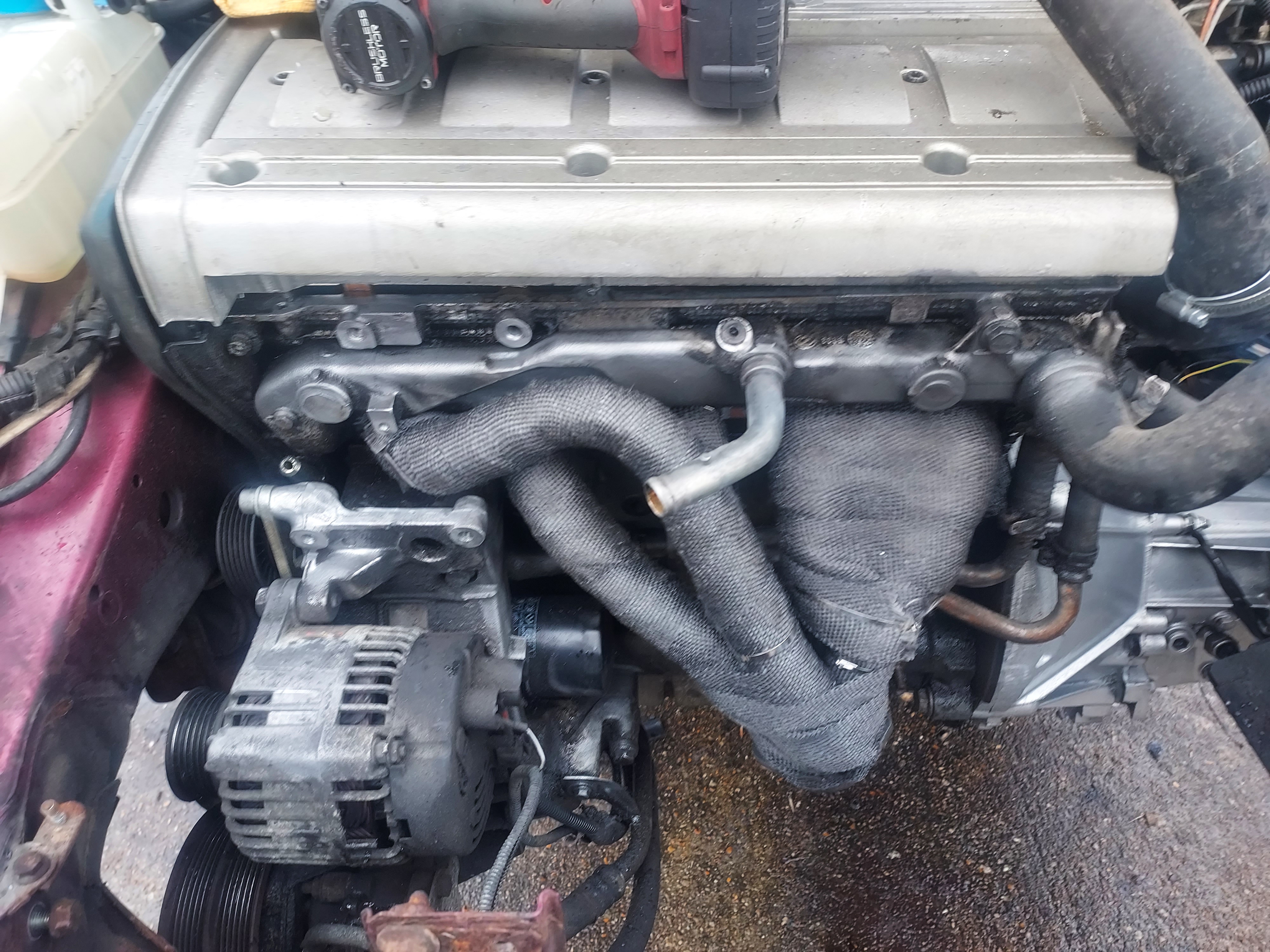

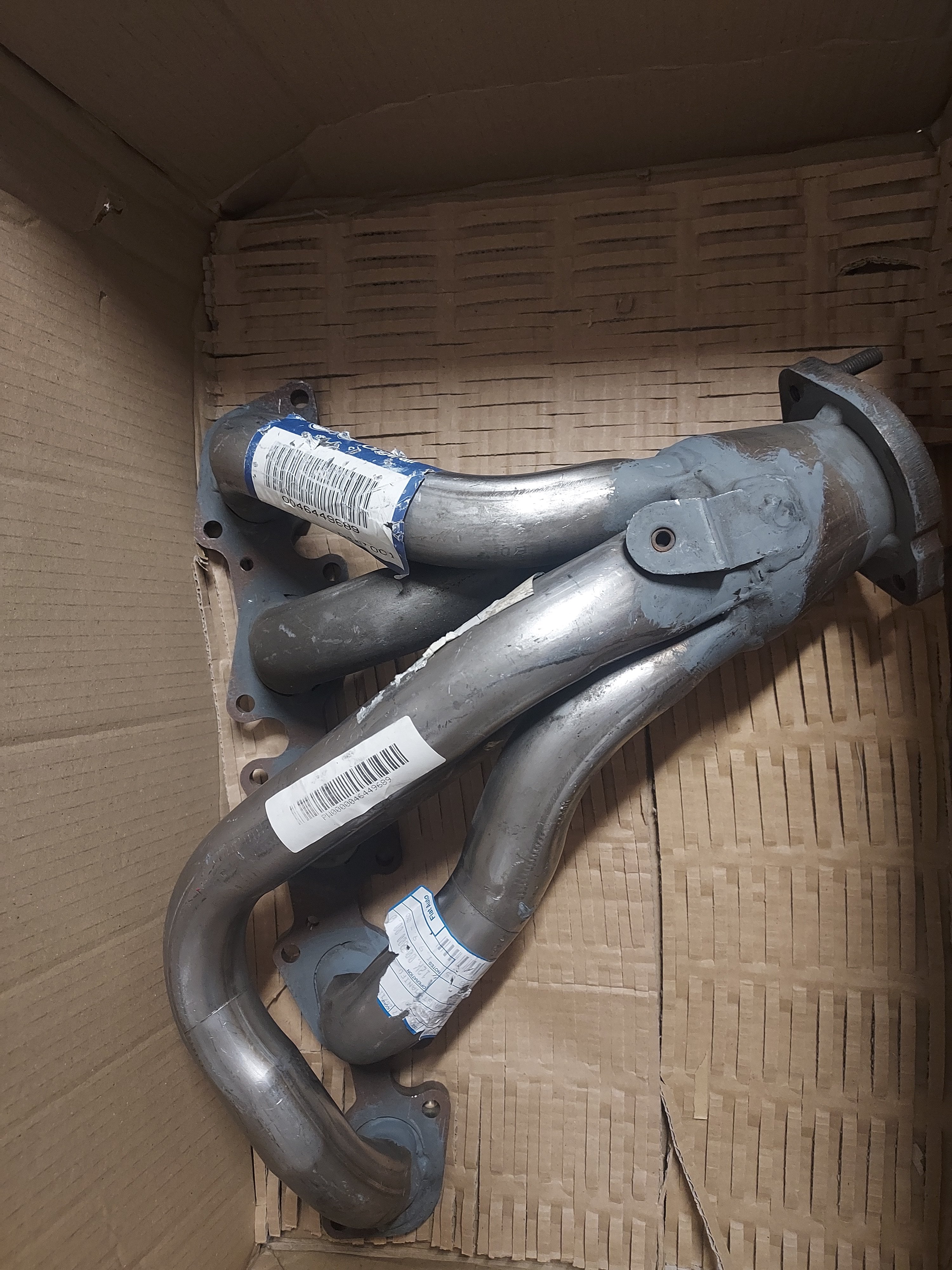

Also brand new 155 manifold that was heat wrapped to keep bay temps low and until I can find some bramd new genuine 155 heat shields it will have to do! lol .....

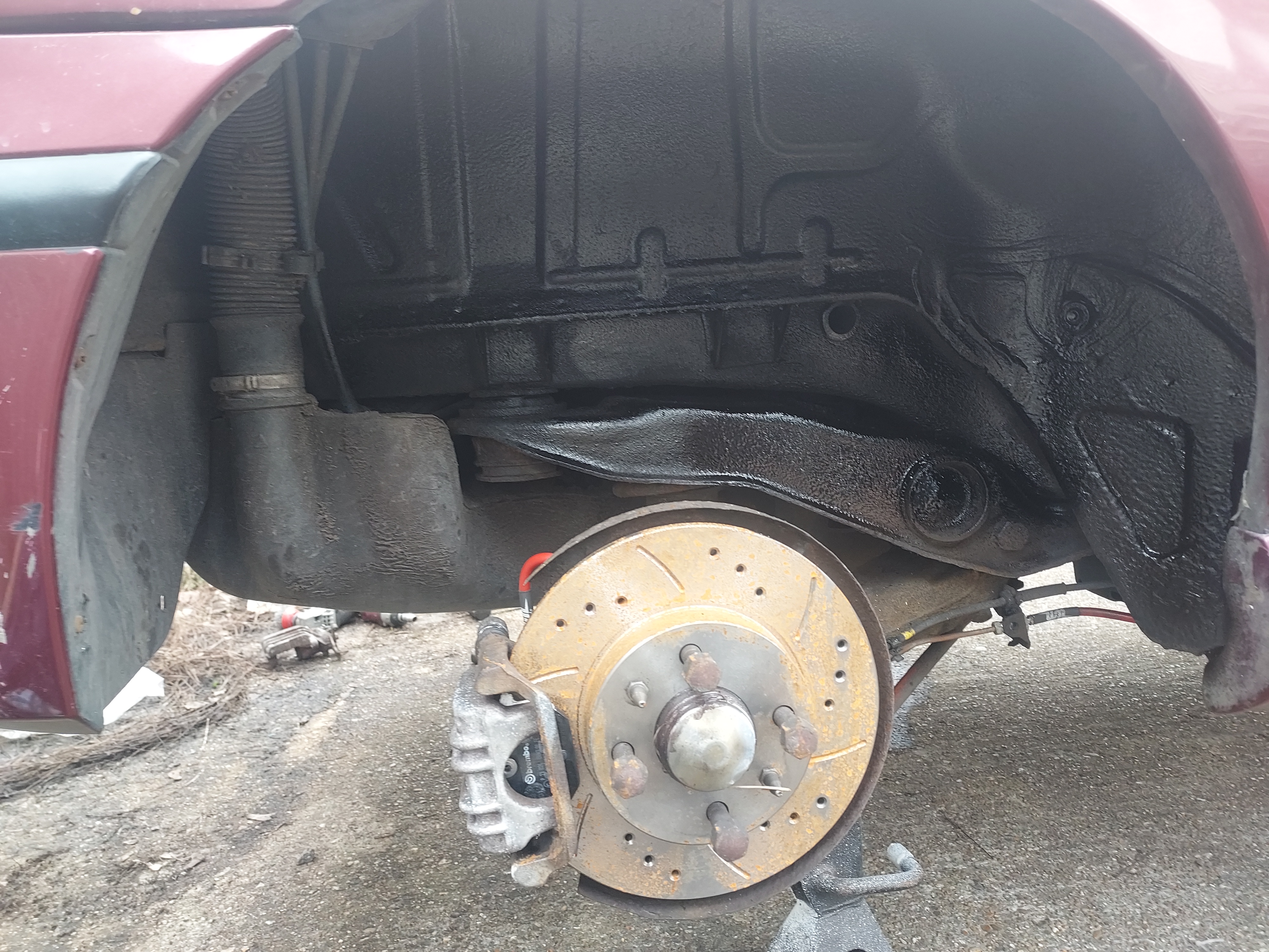

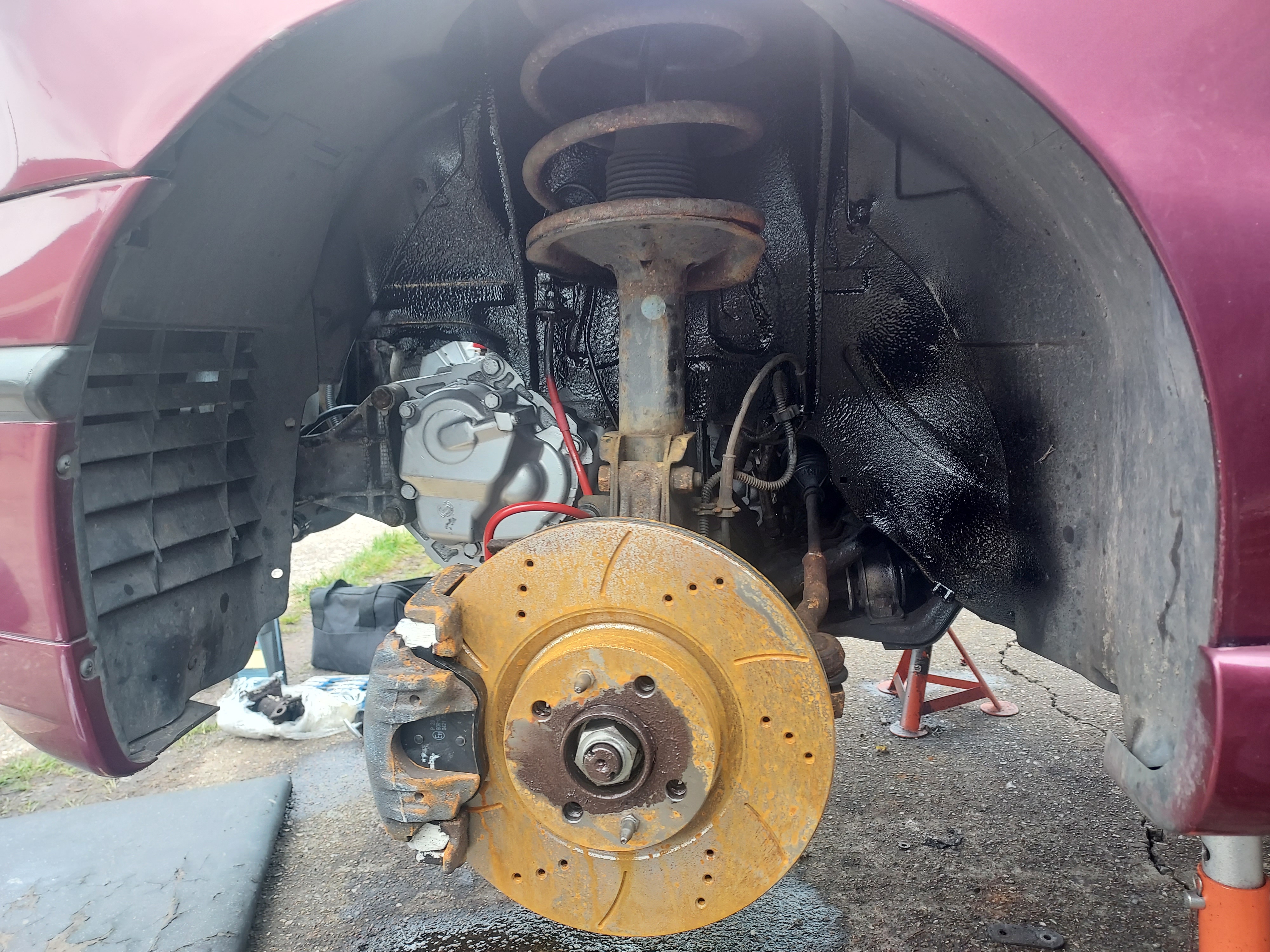

whilst the subframe was off it was a perfect time to wire wheel the whole of the underside and the arches, treat the rust and epoxy prime the spots that needed it ..... covered in 4 coats of hammerrite black and then some 3m schultz to top it all off

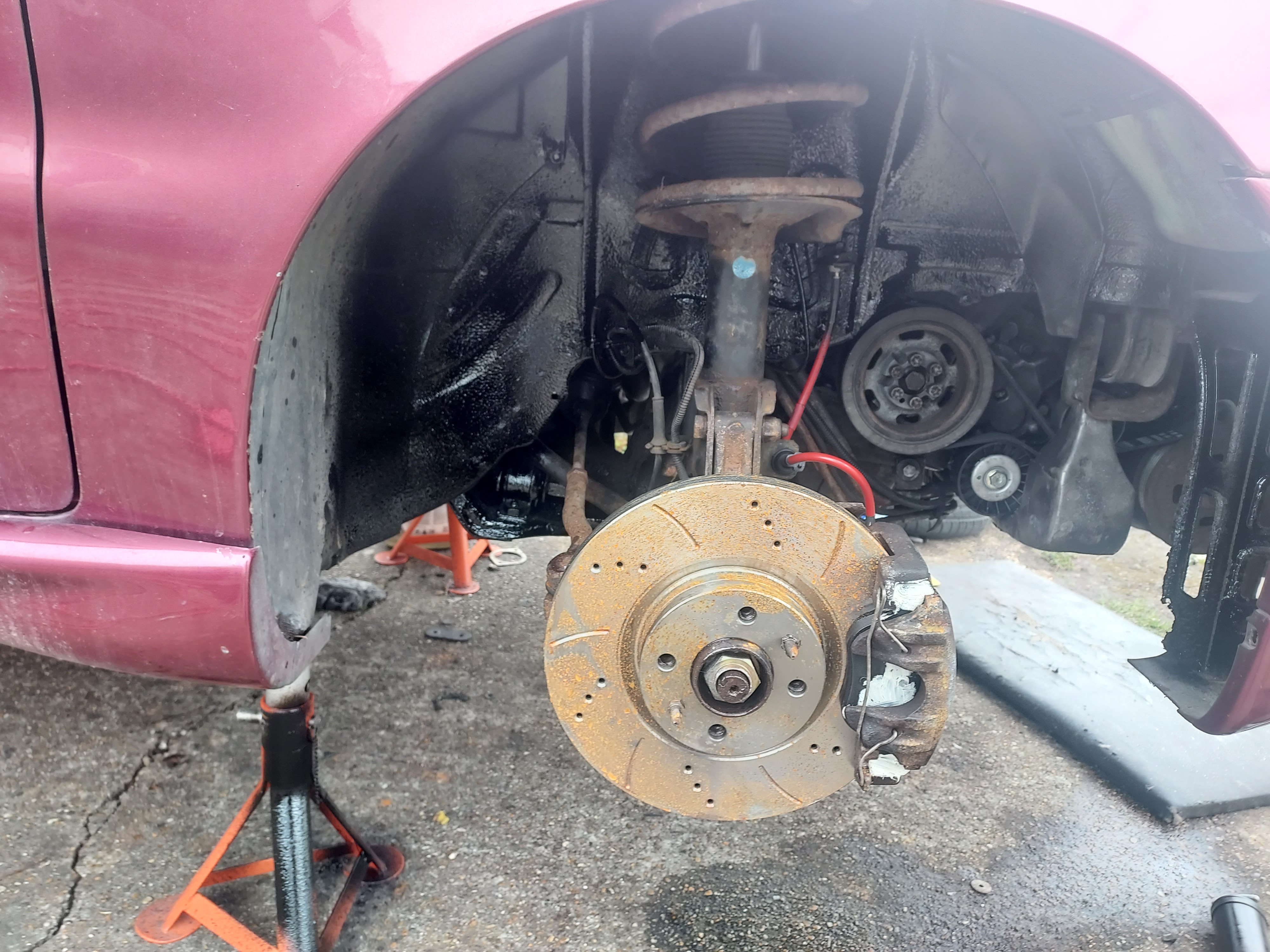

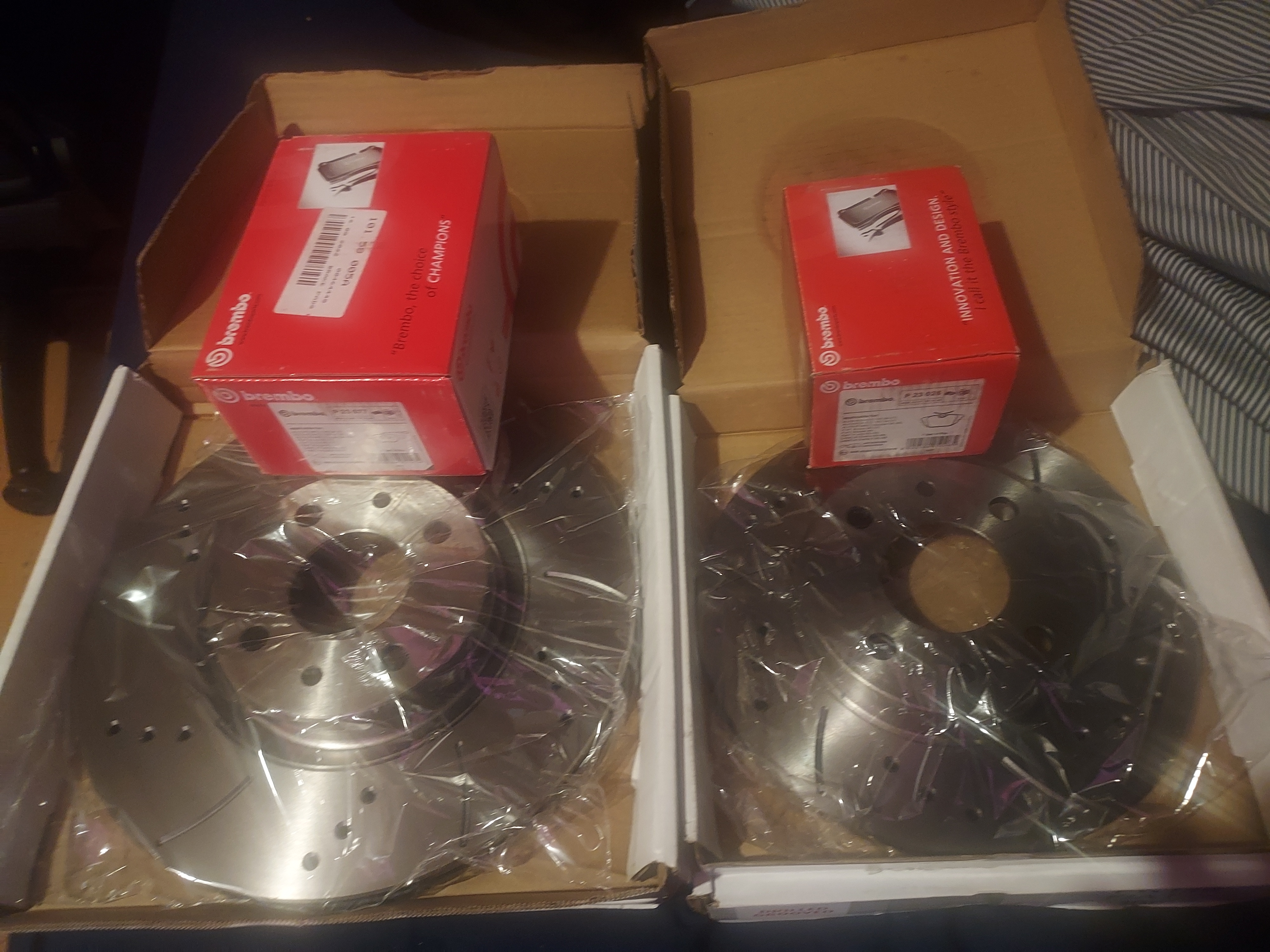

finally the brakes were tended to with a full set of Mtec discs with some Brembo pads ....
I replaced a few of the steel lines with some copper hoses and all rubber was changed for braided hoses, cleaned the calipers as best as I could and used some proper ceramic brake grease and now stops as it should ....
rear calipers were changed as I had small issues with the bleed nipples.... which now means I have a full set of front and rear calipers which I will be sending off to get fully refurbished and powder coated in Silver at a later date.....
Next for the HGT is suspension......
I have some rear trailing arms that are currently at the powder coaters and will be coming back at some point in a nice coat of black .....
a Full set of TRW shocks are on order with some H&R springs also on the way ...
another pair of front arms and droplinks from TRW will be ordered at some point and steering components will be refreshed also .....
few pics of how it all went
