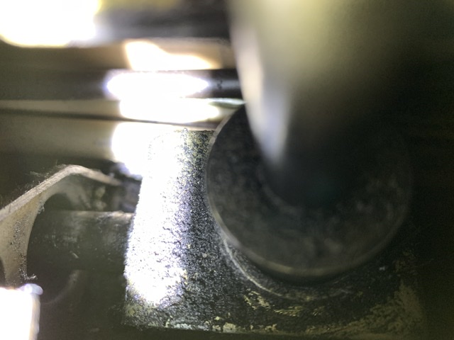

I have read about poor shifting and bushes on the forum so decided to have a look in the tunnel.
Do I have a missing Bush from my gearshift rod in the attached pic looking down the gearstick? I can see a hole in the bracket where the rod passes through but no Bush .
Thanks

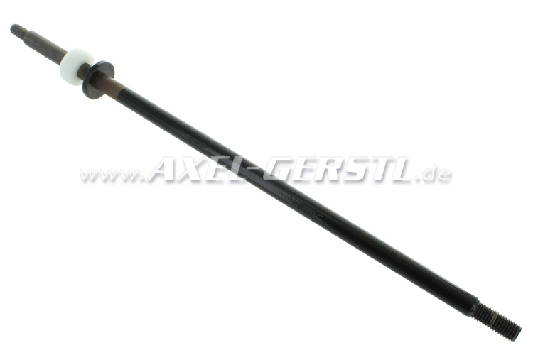

Picture of 500R / 126 gear stick with the white bush.

Definitely looks like the bush is missing. There should also be another one at the gearbox end where the rod exits the body

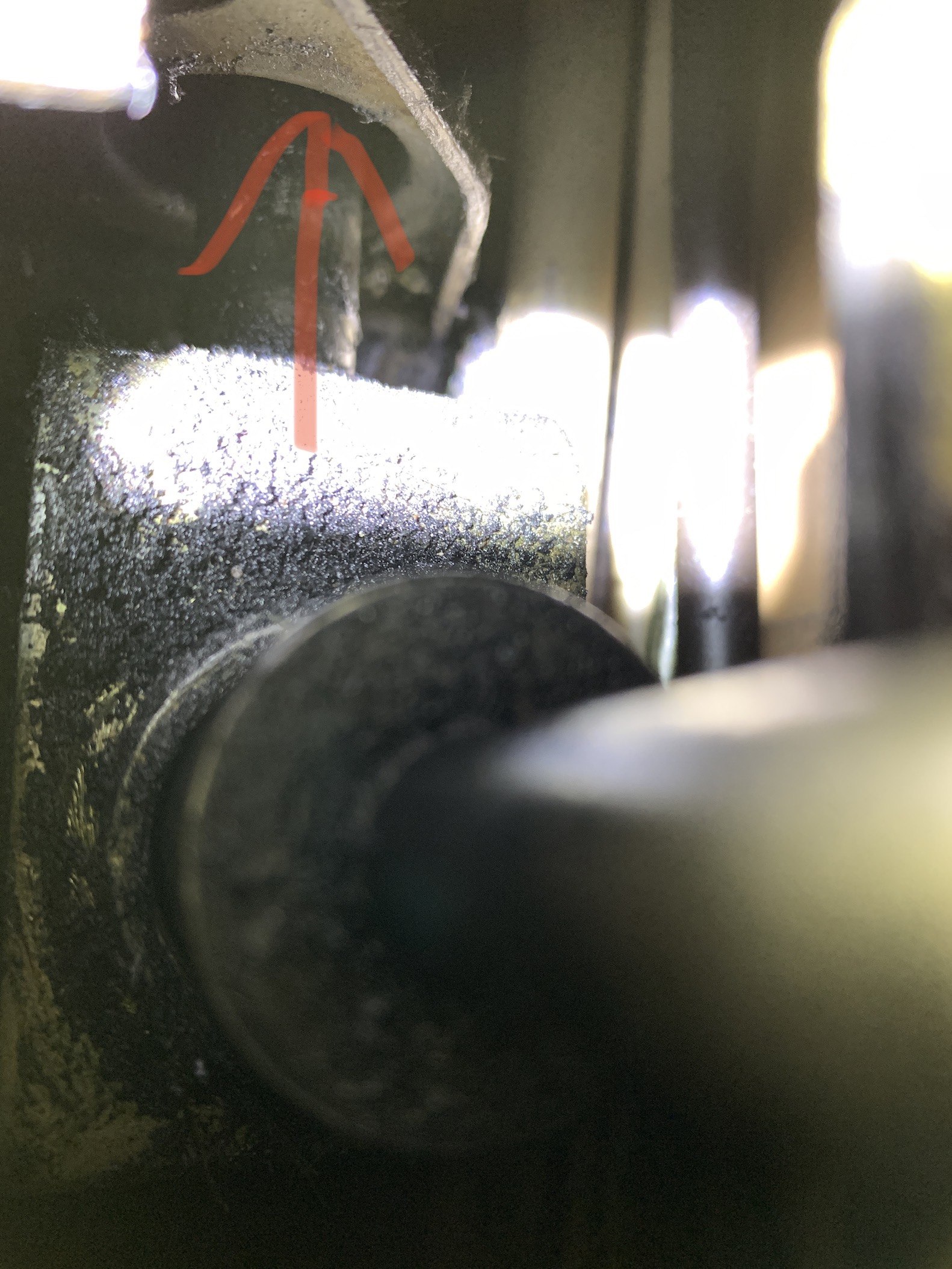

That’s good news , ive marked it in my pic now where I think the Bush should be . My Haynes doesn’t show anything for some reason!
Would anyone have link which would show me how to get the gearstick bracket mechanism wotsit out as there does not seem much room to work inside the tunnel ,
Thanks again

My 500 Haynes manual has an exploded diagram of the gear lever mechanism on page 106 and shows the two bushes on the rod. At the gear lever end the bush fits into the large hole you have highlighted.

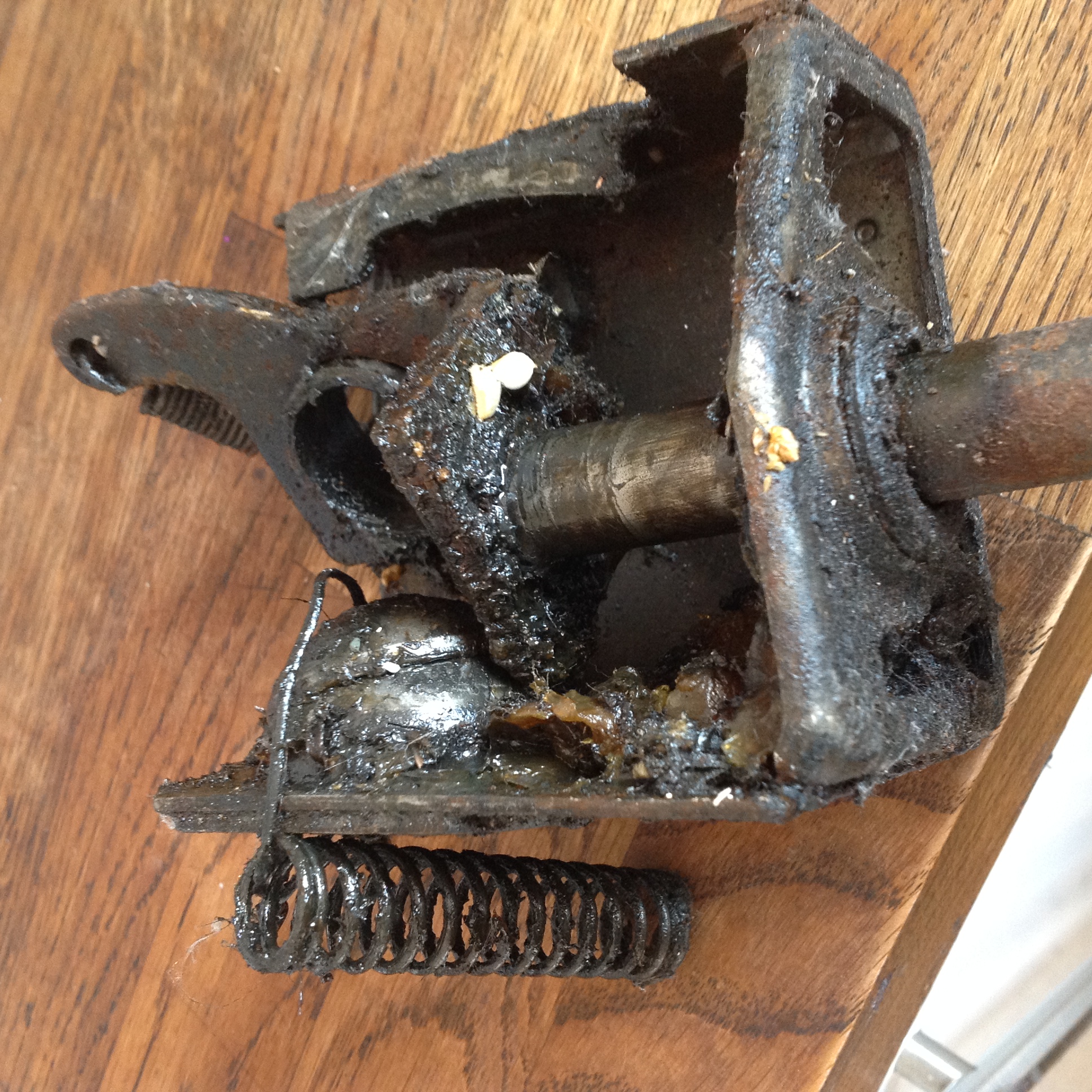

This is very greasy one showing the bush in place. The gear lever itself has been removed from this one and it is the later 126 version with the anti rattle spring

Thanks Toshi ,
Your advice is priceless , I was going to ask about the spring next as mine does not have one but you already answered that one?
I just ordered two bushes and new lollipop, I will be attempting to remove the assembly as soon as they arrive.
