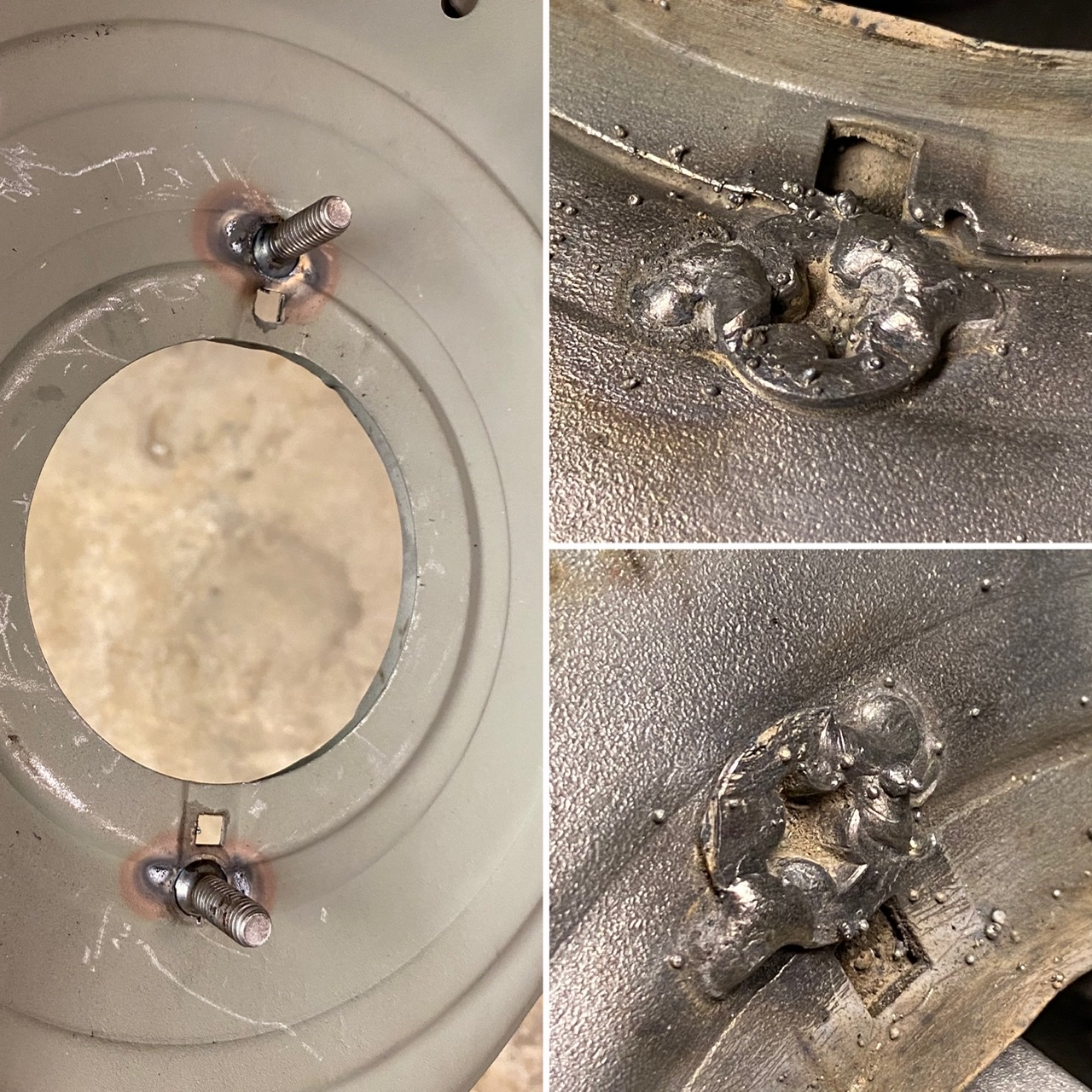

Progress! The spacers arrived and fit perfectly (a break at last!). I went ahead and used all four and wound up with about 2.5mm of standoff between the fan mount and the alternator housing.
With that situated, it was time to mock it up and check the fan fit. As suspected, my previous riv-nuts wouldn't clear the fan, so I cut them out and followed Tom's advice to use the countersunk main bearing bolts as stud stand-ins. I debated using the star washers that accompany them and forgoing the welding, but I know that would come back to bite me some day. Man, those are some close tolerances between the shrouds, but everything is clearing. You can see that sometime in the past, someone else did some ugly welding on the front side of the fan housing. It's ugly, but doesn't interfere.
Next step is to tack weld those two bolts into place and continue on. I just unboxed my new FCAW welder last night, and haven't done any sort of welding in ~25 years, so a little practice is in order before I tackle the real deal. It doesn't have to be pretty, but I don't want to burn through the housing.

Not pretty, but they should hold... and they’re hidden anyhow.

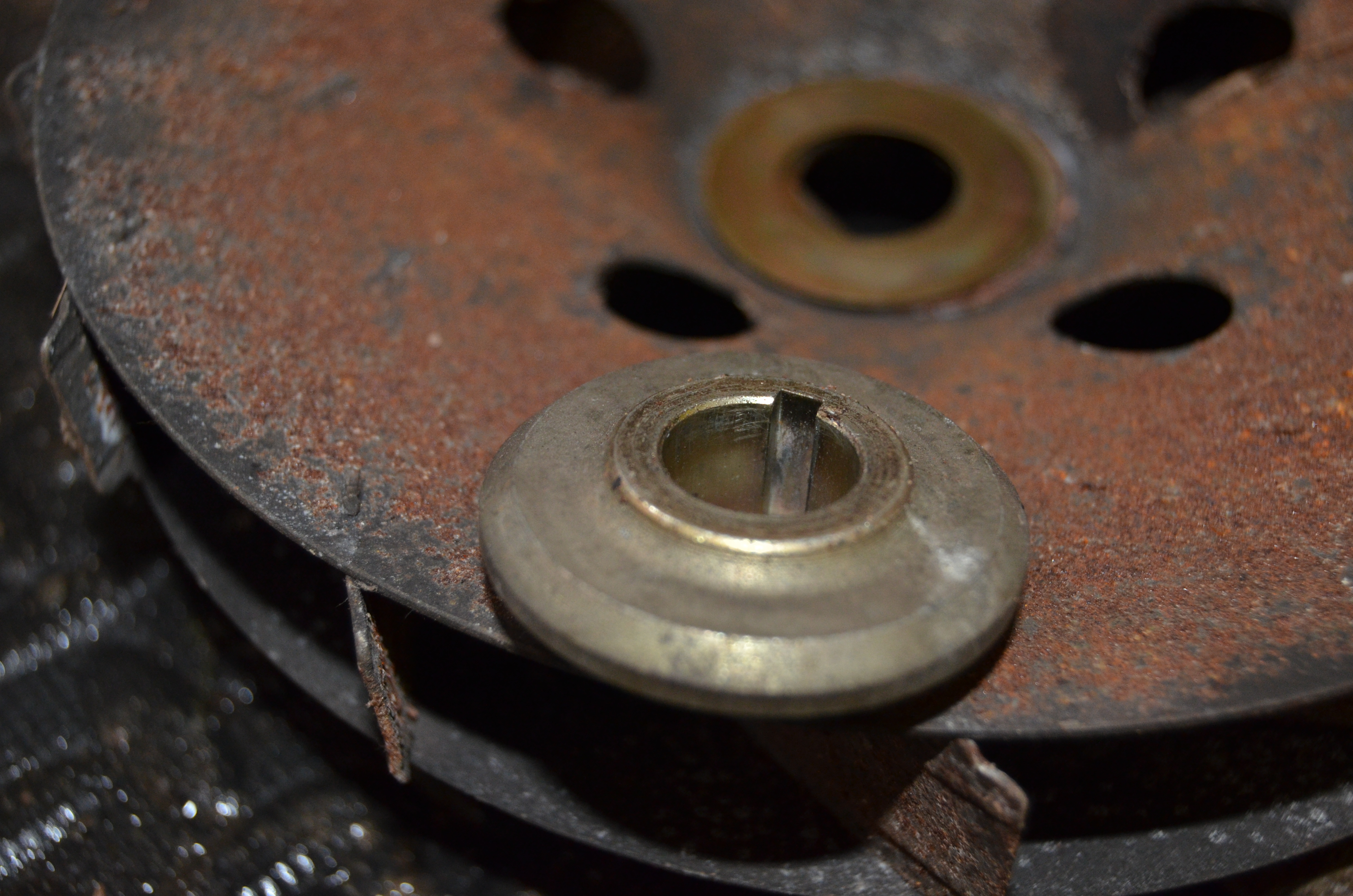

Behold, I am now rebuilding a Marelli alternator. The spacer washer in question is now removed and measures at 2.5mm thickness. It is simply placed before fitting the impeller and removable whilst the bearing is in place.

Well, would you look at that! Last-pass quality control was lacking at the refurb facility I suppose. Probably why mine was lacking the nuts and woodruff keys too.
