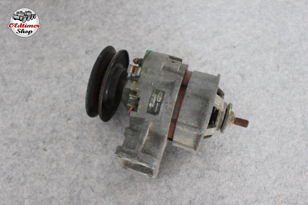

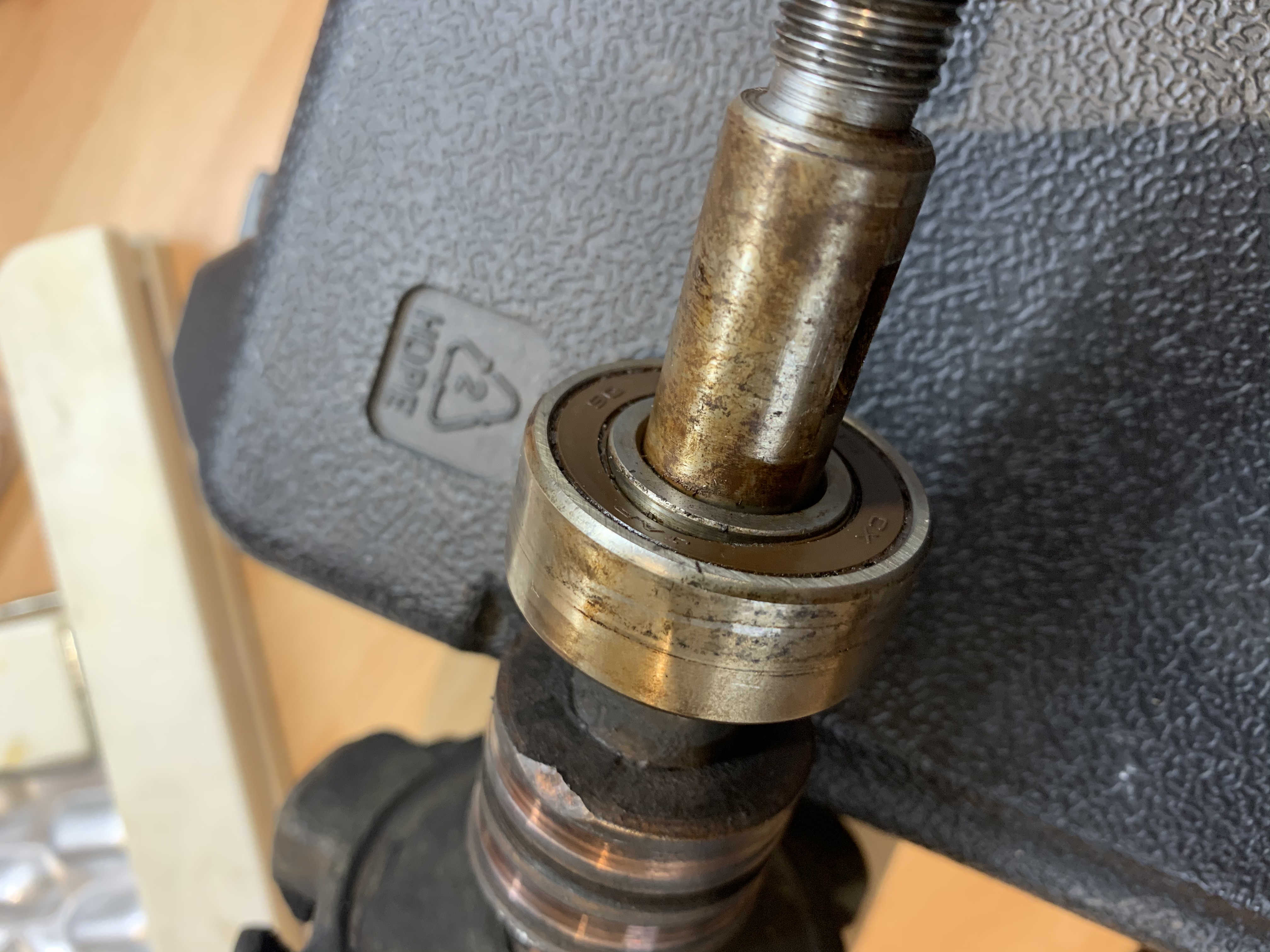

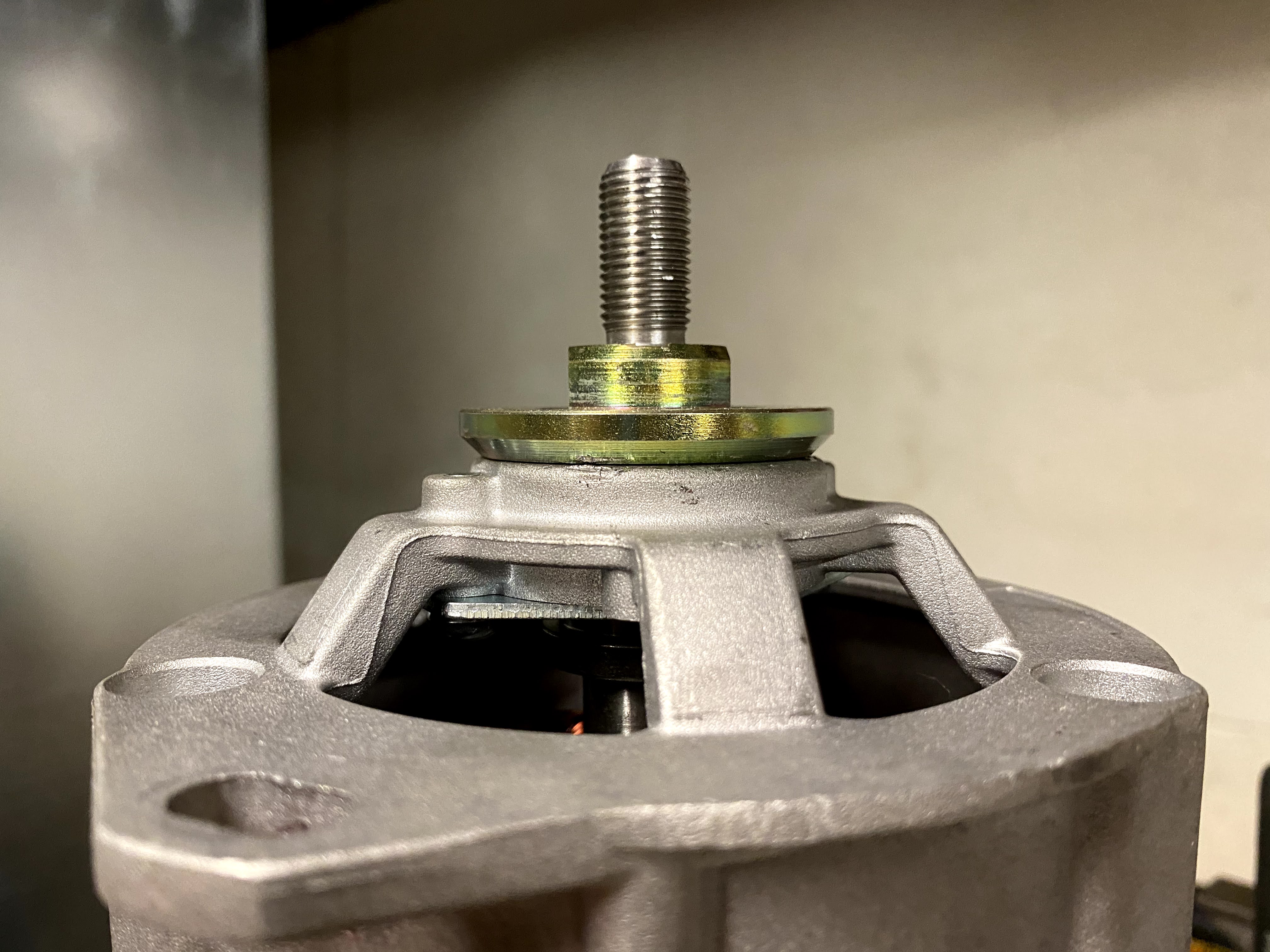

I've run into a little problem with my alternator project. The fan spacer I purchased from Ricambio doesn't have enough standoff from the rear of the alternator housing to full seat to the bearing, so fully seating it on the shaft makes it come into contact with the housing itself. The spacer has .097in standoff, but there's .125in of a gap between the housing and the bearing (pic 1). I didn't measure this at first and tapped it home (pic 2), but was thankfully able to get it off without damaging the alternator.
Is there supposed to be a washer or spacer to add sufficient standoff? Does anyone know the specific distance needed or what the installed clearance between the fan spacer and the alternator body is? It feels like the spacer should be installed the other way around, but then it's not keyed for the fan.
I'm a little stuck here, so would appreciate any help you can provide.

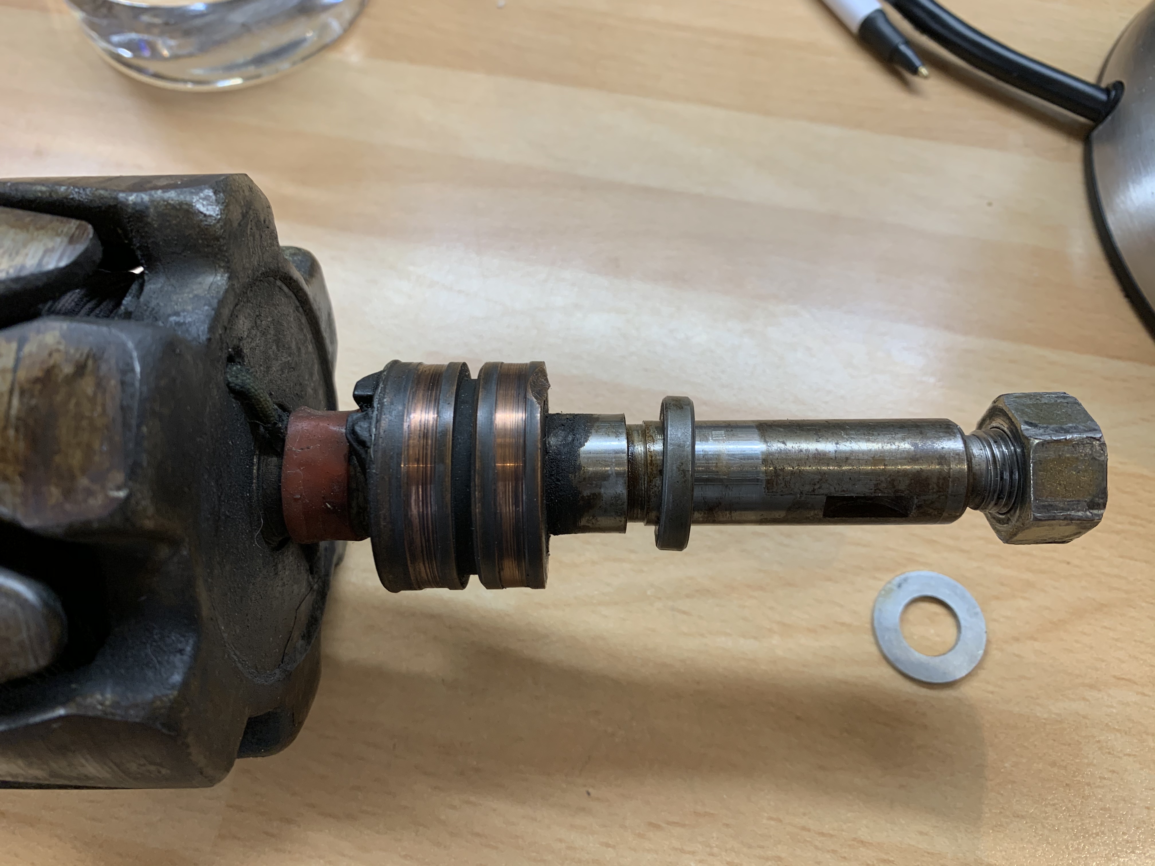

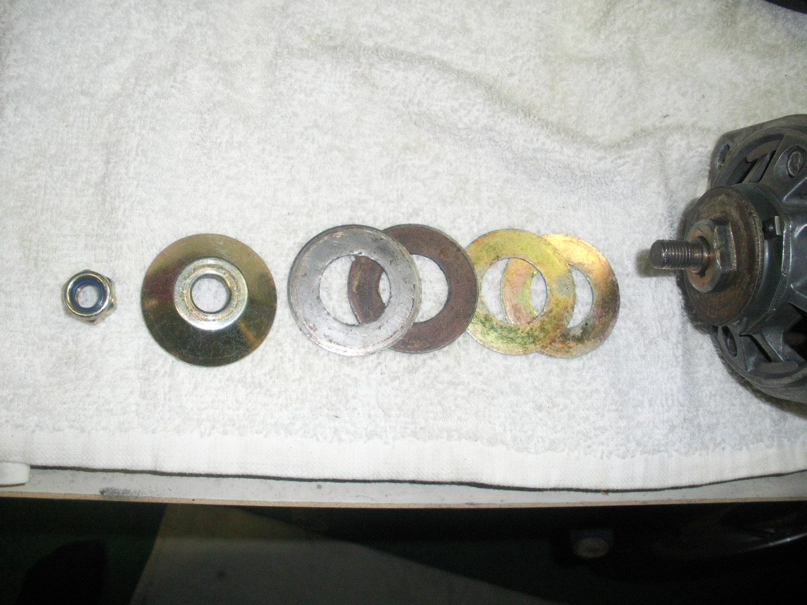

Hi Matt,
do these help? The first photo shows the hub still attached to the shaft. I can't tell if that hub is what you are showing in your pictures. The hub is internally keyed (Woodruff key) onto the generator shaft and it then has flat machined edges that key onto the fan itself.
On the white towell are four thin washers that get used if the fan rubs inside the housing and then finally on the towell a big cone shaped washer and a nut that holds it all together.
Highlighted on the parts diagram is the hub that is still attached to the shaft in the first photo and one of the thinner washers.
(The parts manual refers to the parts as hub, and washers).

Back from the dentist,and I have had a good look at MY fan installation. I can't (easily) remove the fan-drive adaptor, but it would seem to have quite a fair bit longer 'shank' than the adaptor you have been supplied with. The only sensible way that I can think of for easily getting round the problem is to remove the 'woodfruff' key and then make some thin shims (or even 1 washer of the required thickness) to bring the adaptor out enough to enable it to turn without fouling the alternator body. If I can come up with a puller to remove the adaptor on my alternator, I will remove it, and measure the depth of the shank for you.
Hi Matt, just looked at an alternator I had to hand and the recess at that end is almost non existent , probably about 0.5mm so you may well have a missing spacer. On the other hand there is quite a deep recess at the pulley end.
I have managed to find my spare adapter (for a 'steel' fan)and like your one, the shoulder is less than the amount that the bearing is in from the edge of the alternator. My '695' fan is an alloy item, and it came with an adapter, which seems to have a much longer 'shank'. Being that the alternator shaft has a shoulder at the inner end of the thread (which the washer and nut at the outer side of the fan abut), I wonder of the factory push the adapter all the way down the shaft---only to the point that the outer edge of the adapter is flush with the shoulder. I still think that my "plan A" is the most sensible way to go if you are worried.
Thanks for the responses gents. I debated just pressing it until it's good enough, but any tightening of the nut would compress it closer to the alternator body. This appears to be the same adapter that all of the various parts places sell - it was marked "Made in Italy" and came in a generic bag from Ricambio.
tjmra - not entirely. I have the rubber pads that sandwich the fan itself. My problem is the fit between the 'lower' fan mount and the alternator body/bearing. It does give me an idea of how much threaded shaft remains with the fan fitted, but I don't know how universal the shaft length is.
I think I'll try to find some washers/spacers that fit as close as possible without rubbing any moving surface.

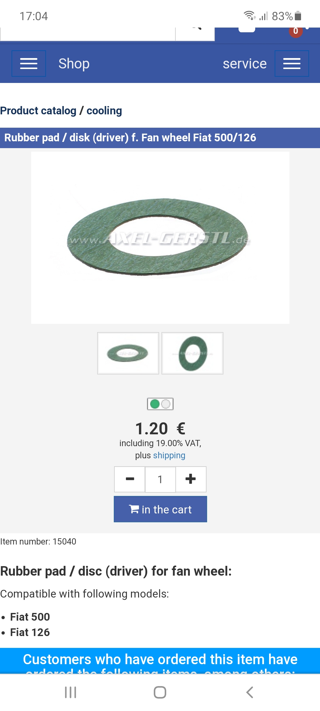

I think that there is a plastic material type washer item 4018701 on tjmra picture which fits before the fan. If this helps
This is the part on Axel site
I have that piece from the old dynamo install, but that isn't the issue at hand. That provides a damper between the fan spacer and the fan itself. My issue is clearance between the spacer and the alternator body.
