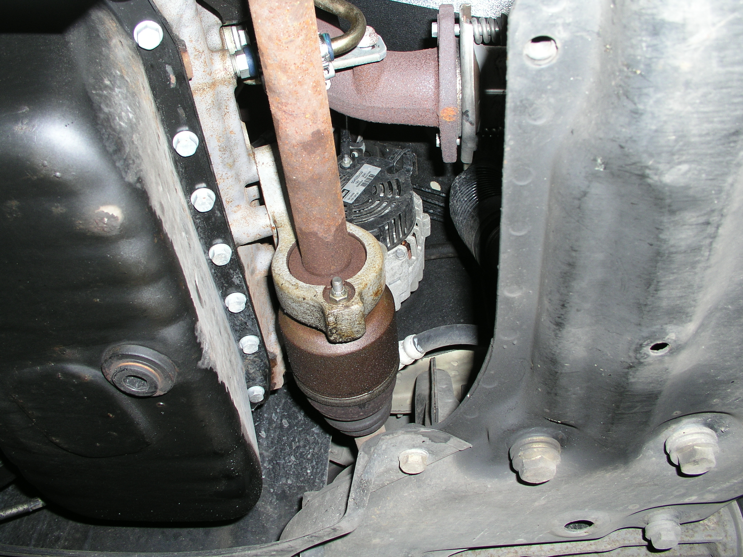

Wondering if anyone has knowledge of changing the regulator or brushes in these alternators? I'm assuming these are internally regulated? I've heard just removing the alternator is a fun job that involves taking out sections of exhaust or steering components?
Here is a photo of the mounted alternator. There have been reports of it being removed without removing other components. Perhaps over the chassis cross member, and thats after you get the bolts out.
Thanks for the pic, it looks like they built the van around the alternator.. I'll have a closer look when I get it in the shed tomorrow. Cheers.
