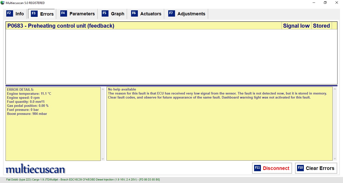

MultiScan - shows Fault - Preheating Control Unit ( feedback) - 'low signal' - see Attachment Image 'NO START 1'
eLearn not showing much for that sort of thing.
Engine Started OK using squirt of EasyStart into Air Inlet System - first time I ever used - however product description states >>
"Warning: Diesel and petrol start must not be used for diesel engines with preheater" - 1st Question does the Doblo have preheater?
I have found images ref Heater Plugs and their placement on Doblo Engine - but as MultiScan states problem is a 'low signal' - see Attachment - can that be caused by Faulty Heater Plug/s or better to first look at wiring and connections?

First thing I would check is power going to the glow plugs at the correct time, I think the control unit for the glow plugs can play up on these engines.
