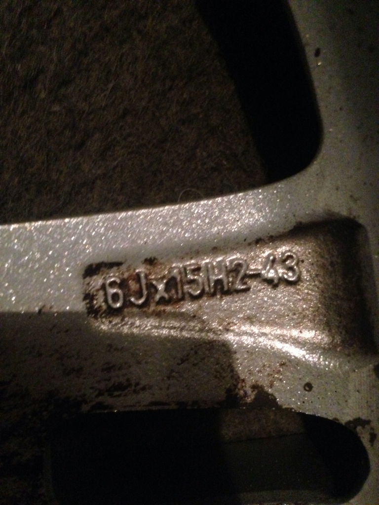

ImageUploadedByFIAT Forum1414349290.098856.jpgImageUploadedByFIAT Forum1414349313.431388.jpg i went in my garage and looked at the back of them and got these numbers
51732813 is the part number of the wheel
6J is the width
15 is the diameter in inches
I'd take the advice given earlier, sell them on (probably for a profit!) and buy some mk2 wheels
6J is the width
And 43 is the ET.
Do a trial fit of one and you'll find that the PCD is wrong -- your wheelnuts won't fit.
