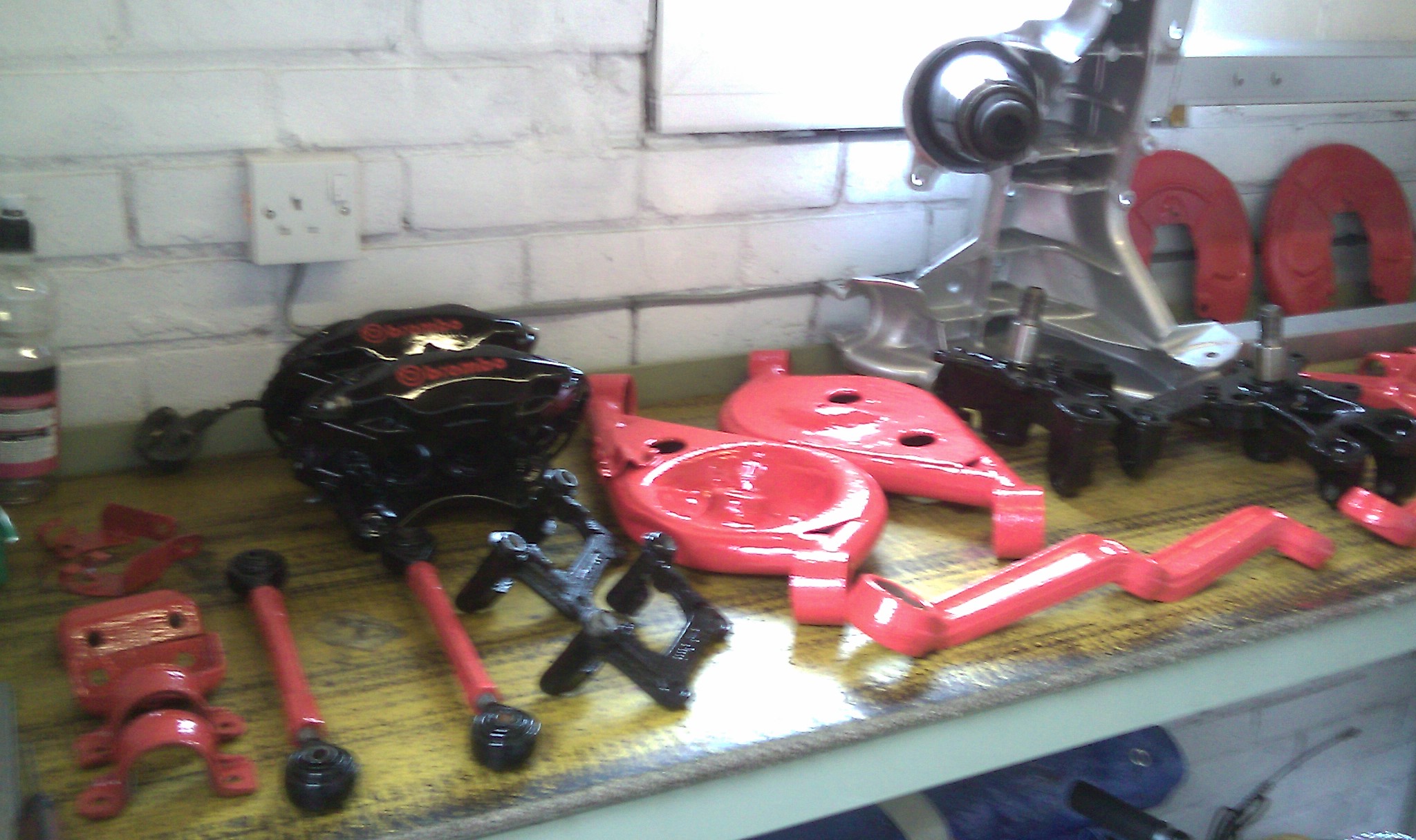

G gassy1974 Patron member Parked in the garage Joined Nov 22, 2008 Messages 31 Points 13 May 30, 2011 #1 I AM CONVERTING MY TIPO 20VT TO INDEPENDANT REAR SUSPENSION TAKEN FROM ALFA GTV FITTED WITH POWERFLEX BUSHES TO IMPROVE THE HANDLING

lewey All go, no show Parked in the garage Joined Sep 27, 2005 Messages 2,468 Points 546 Location South Birmingham Jul 25, 2011 #4 Any progress on this? Can you explain or show photos of the conversion? I have plans to do this in my next project.
Hellcat zombie nation Parked in the garage Written a guide Joined Jul 8, 2005 Messages 28,510 Points 5,262 Location on the A684 Jul 25, 2011 #5 Do you need to chop much of the underside off to fit this? The thread for the 4x4 conversion had all sorts of bits getting removed to fit the rear diff.
OP OP G gassy1974 Patron member Parked in the garage Joined Nov 22, 2008 Messages 31 Points 13 Jul 26, 2011 #6 the spare wheel well has to go petrol tank aswell i will get some photos sorted soon
