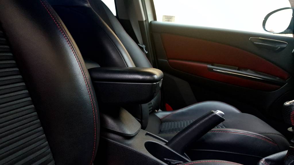

Im wondering if Yorkshire007's seats are the alpha ones.
They look similar to these in this post... very comfy and look lurvley.
They look great - was it difficult to do?
No not at all straight got rears don't fit though. But it's okay they look good still as the interior is red and black and the alfa seats are black with red stitching. Only thing is the height if the seat if your short it doesn't pump right up as the old seats but you'd have to be a hobbit to have trouble
