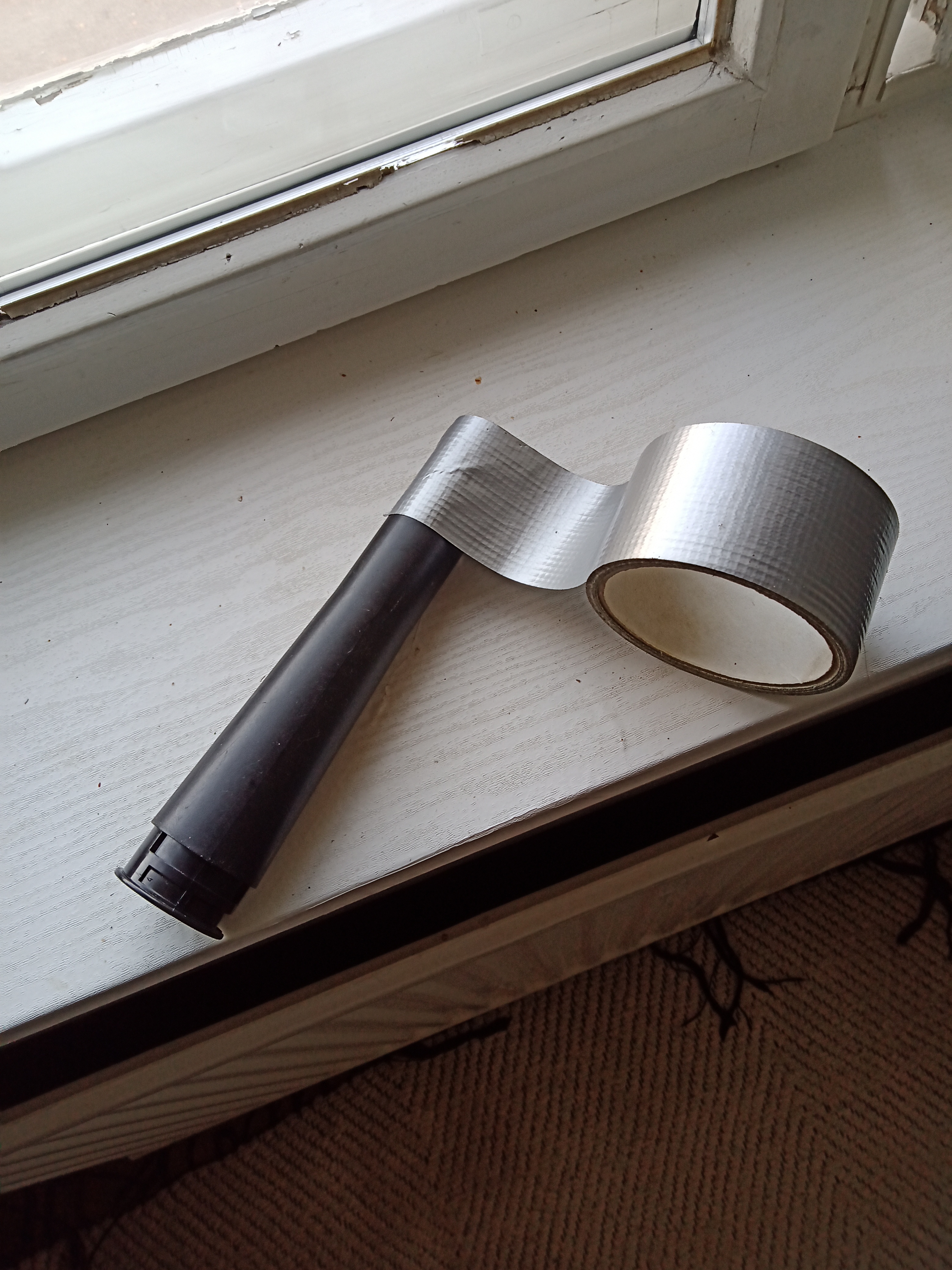

Hi all! I'm new here and I was excatly same issue as many have with that airlock in coolant system (my car Fiat Punto 2004 1.2 8V MK2/2B) after water pump replacement. I tried all methods to get that air off but air still stay hardly stuck in somewhere. Airlock in coolant system was cause even for rough idle and many more issues. Untill I just start trying some desperate method. And amazingly It worked. And it's easy as can be. First You need plastic (or metal pipe) pipe witch one fit inside of filling tank pipe. Maybe You can also use ducktape over pipe avoiding air leaks (see attached picture). In this case I use somekind of part from vacuum cleaner. Next open cap and put Your pipe into tank pipe. Test first there is no air leaks (tiny leak doesn't matter) by blowing gently to pipe. Locate rear bleeding screw and open it little bit so it's easy work with it. Blow Your self made pipe gently and feel the pressure, same time keep opening more bleeding screw. First air coming out with burbling sound. When You can feel only liquid coming out and no burbling sound, start closing screw. Keep the pressure untill screw is closed. Start the engine and 2500-3000rpm, try to hear sloshing sound. If not any sounds, You're done. If sounds sloshing noise, repeat all once again (sometimes tree times). That helped for me.
