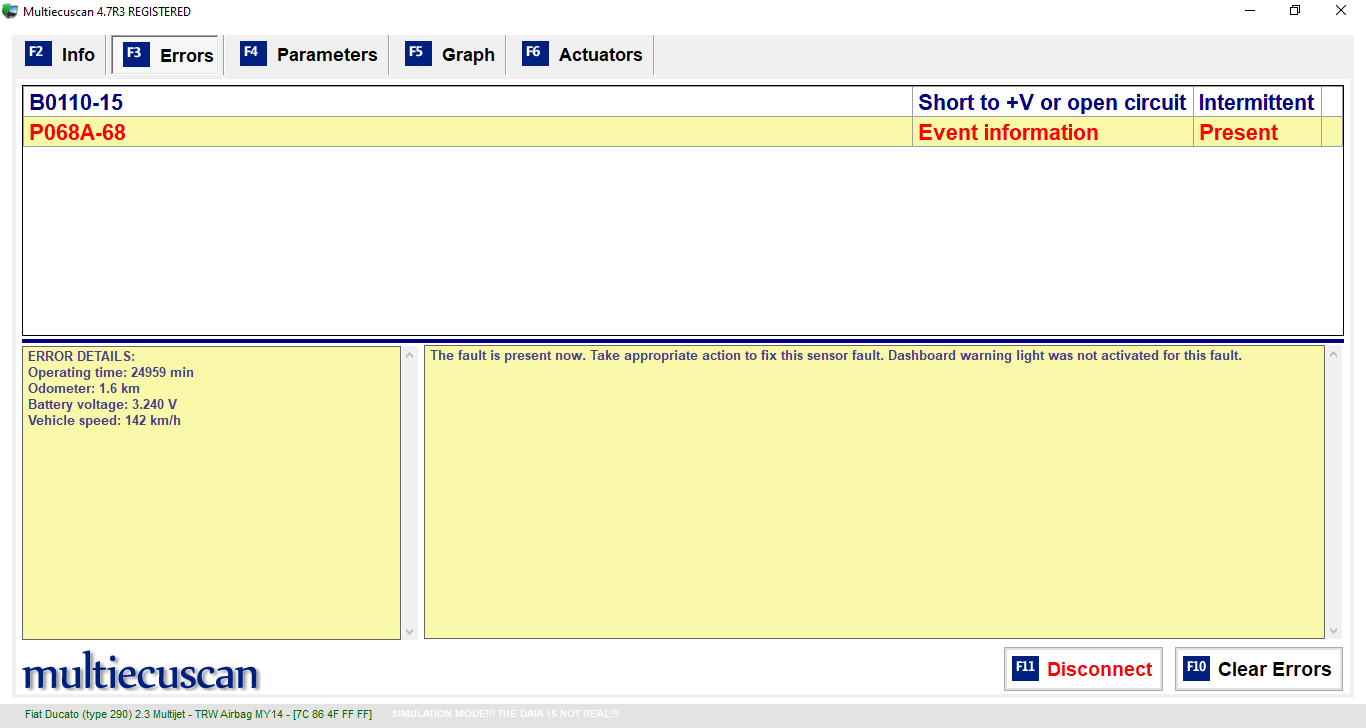

I have received my multiecuscan kit from Gendan. It has two usb leads, one a red lead is in a bag with a label that says once opened I can't have a full refund. Running the Multiecuscan free software tells me I need to use the ELM lead which is the red one. Should I open it to to scan the Airbag group or have I miss understood? There is also a note that 2017 + vehicles have a security gateway module and my van was registered Oct 2017.
Thanks
Use the red usb cable and the free version of the software. (your 2017 ducato does not have the security gateway module) connect initially to the engine. once it all works you can register the software. then try doing a full scan or connecting to other modules. some ask for the yellow adaptor (inc airbag)
F3 will show you error messages take a screen shot with each item highlighted.
to clear errors press F10 or click on button on bottom right hand side.

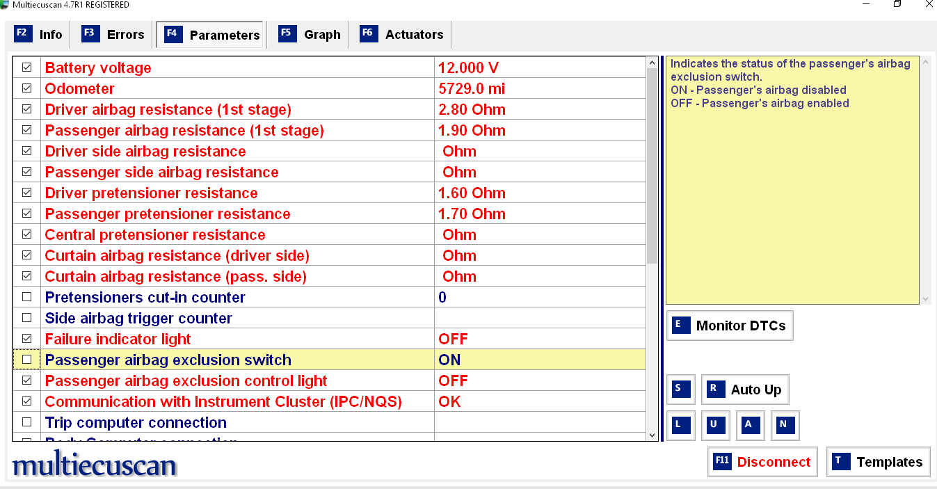

F4 parameters as example to measure values
View attachment 415574View attachment 415575
@theoneandonly , thanks for your help.
After some initial problems (my fault) I have the below. I guess that means ordering a new airbag module which I prefer over a repaired one, unless someone can advice me better.

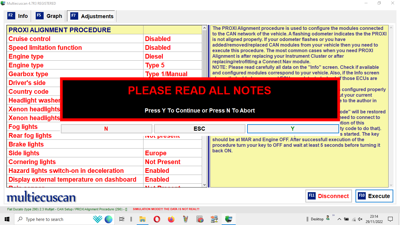

After replacing the airbag module do I just write the original/copied proxi file back?
No, you do a new proxi alignment.
body can setup /proxi alignment F10
F7
F10
read notes press Y to continue
F7, then F10
Says writing then completed
turn key to off Y
