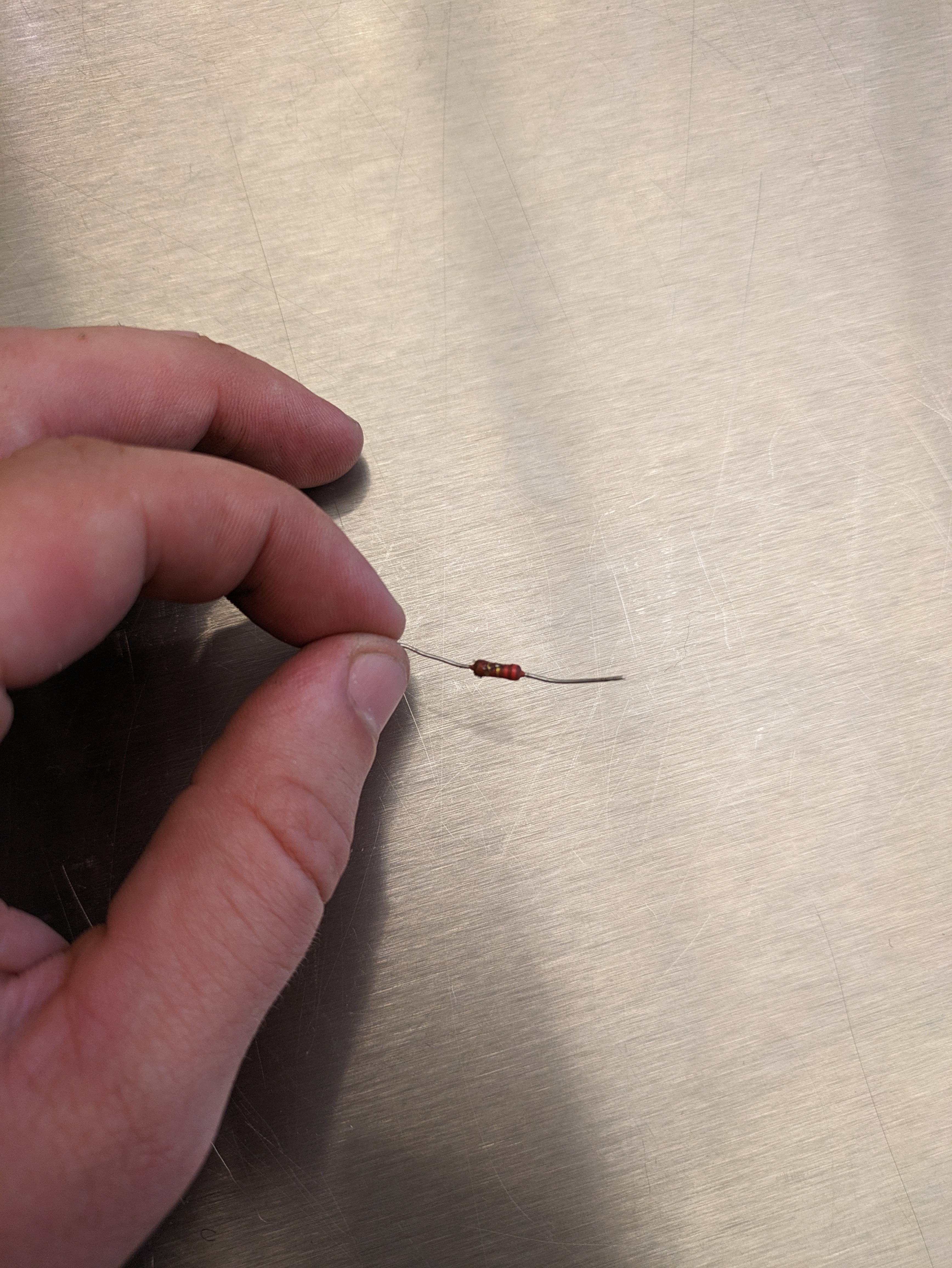

Solved! Followed the cable from the airbag connector. Under the carpet in front of the passenger seat, there was 7 cm of electrical tape in a different colour, than the rest. Removed it, and in there, voila. A resistor soldered in between two wires.
Cut it off with small pliers, new electrical tape in each wire, and then new around the whole bunch after.
Airbag error gone!
Yes , that makes sense, if the previous owner had had a non standard seat with no airbag system / seat sensor connected then having a resistor in the circuit made the BCM think it was connected but seat not occupied, so when you reconnected it then it probably had two lots of resistors in the circuit. As I mentioned on my daughters car I replaced the previous owners damaged seat sensor with a cheap basic sensor but had to fit the resistor from the damaged seat sensor to activate. In your case you were fortunate that there was no damage to the BCM.:)
