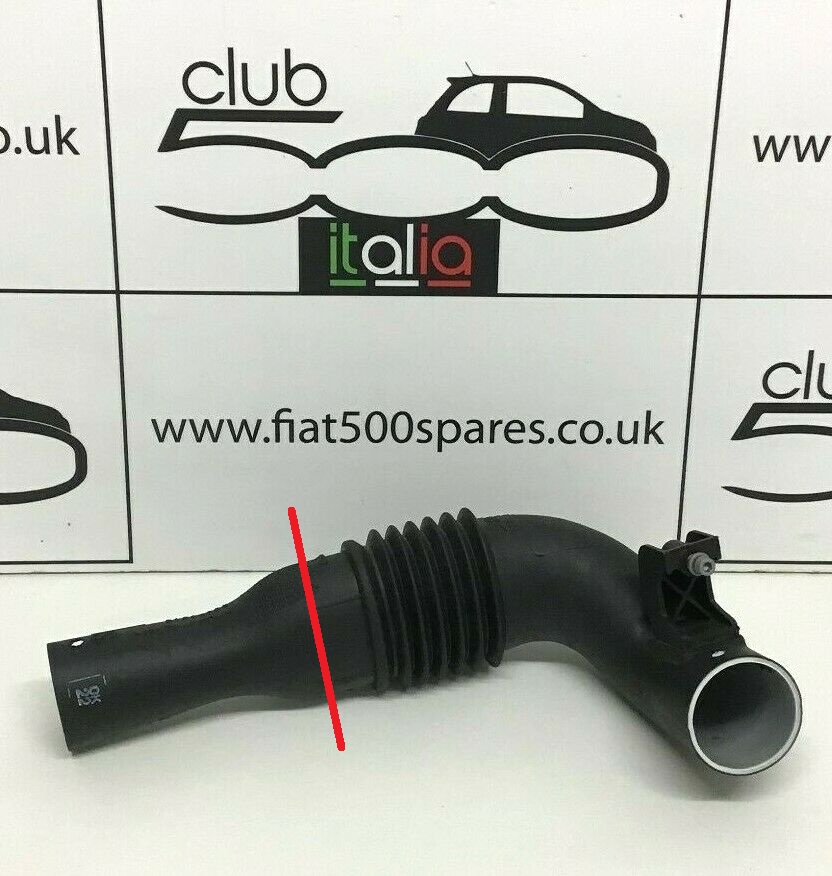

The air intake pipe (I think that's what it is) is missing from my daughter's Fiat 500 Lounge 2010.
Does anyone have a photo of what needs replacing, please? I am not sure if these pipes differ according to model and year?

Double check with others for your particular engine, but this might be it?

Have a look at this.

A local car breaker has one which I will go and see at the weekend, so the photos above are really helpful as I can check to see if it looks like these.

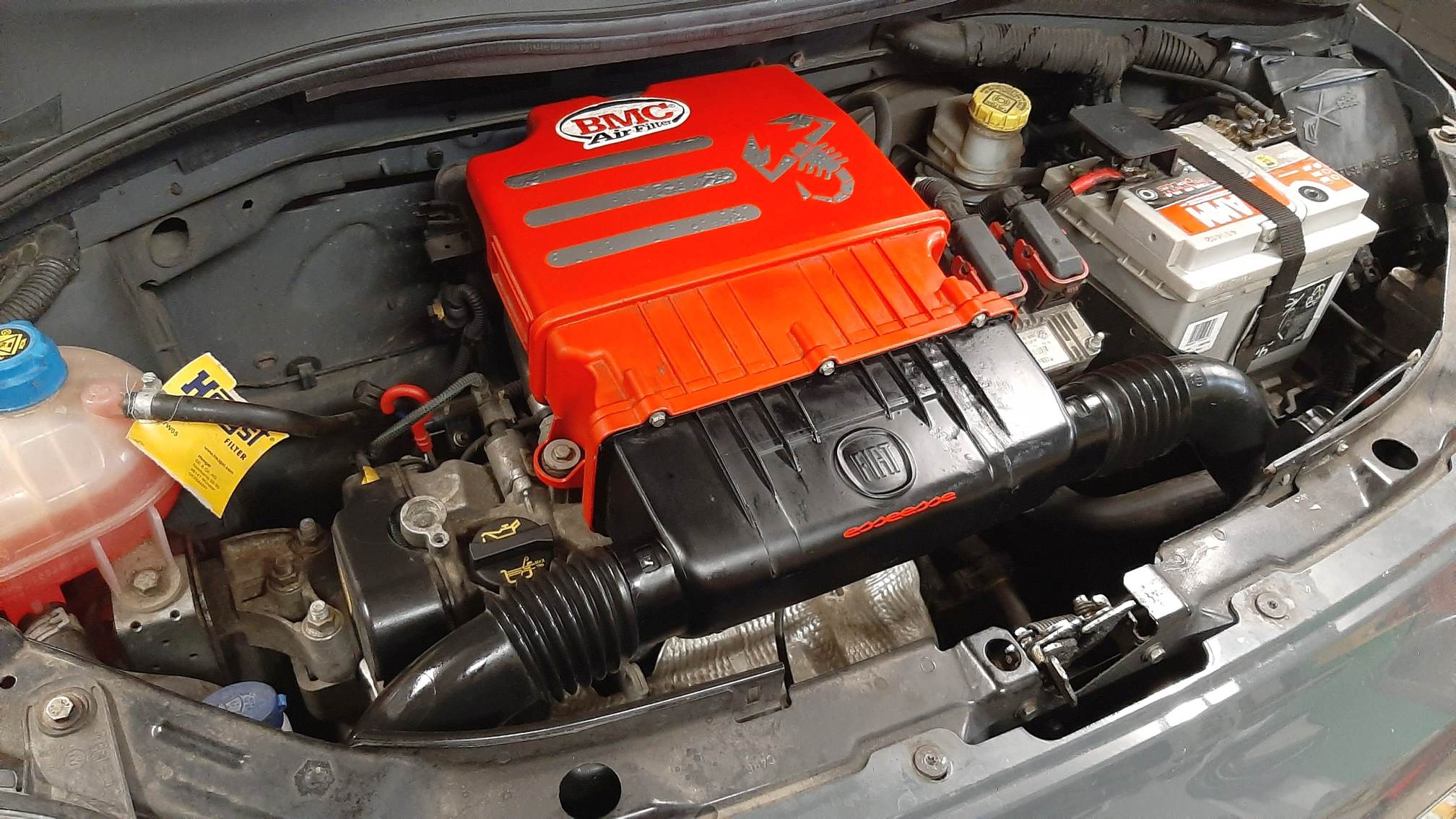

Ive looked at the original picture wrong it looked like you had cut the section off before it connects to the front of the grill off
So the air would be sucked in from the engine bay and not the front grill
