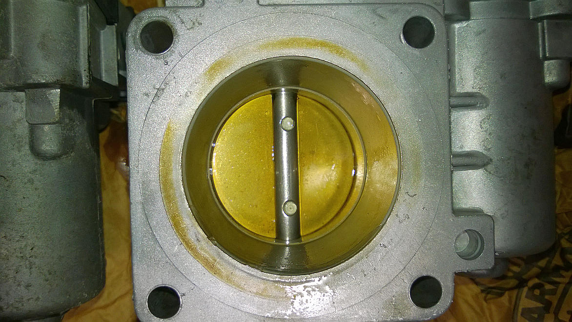

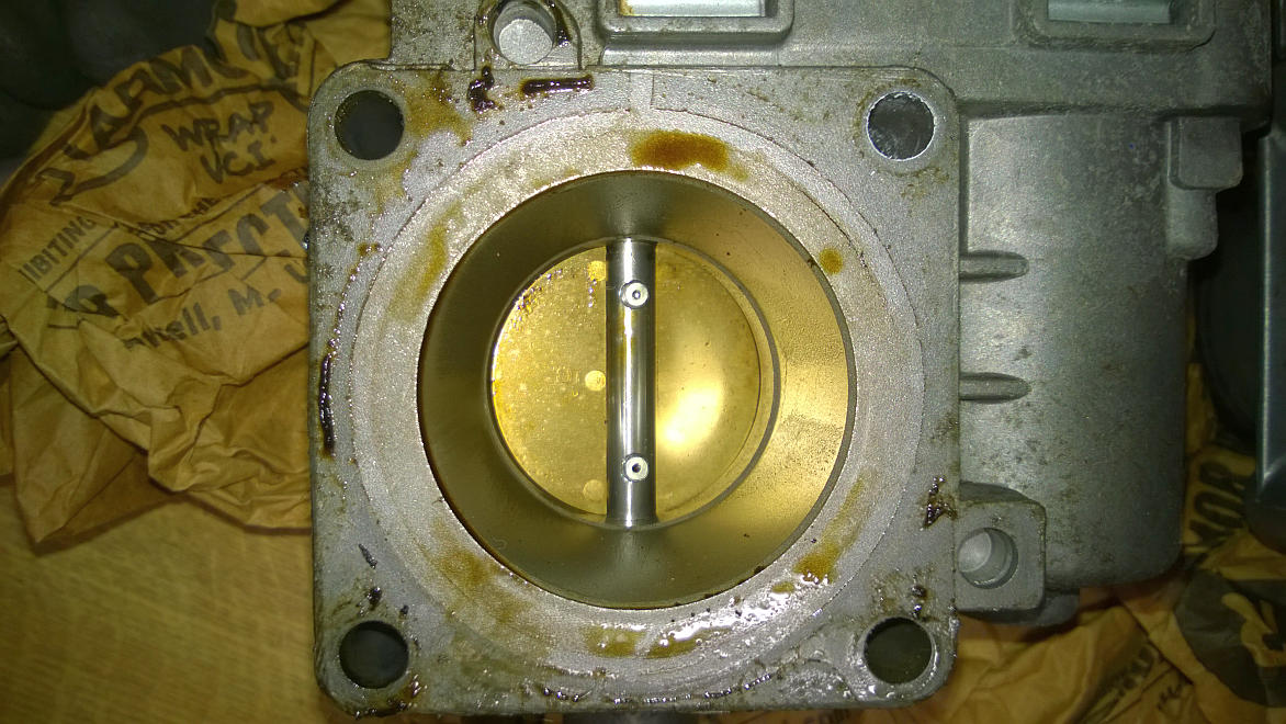

Things you can do by yourself are modification to the airbox and the throttel body of the 1.4l 8V engine. The Fiat parts catalogue offers also some alternative exhaust solutions...;)
Yes I got mine from a Grande Punto 1.4 8V and it did fit plug'n'play. Even no adaptation procedure was necessary with mine (2009 model). To improve breething further by keeping the OEM look, I merged the lid of the air-filter housing of the 1.2 500 with that of the Grande Punto 1.4 8V that has the inlet on the the other side, so that I had then two inlets. In addition I did cut away the restirictors that you find in both snorkels where they stick inside the filter housing. And I got a BMC replacement filter. This setup improves breathing a lot.

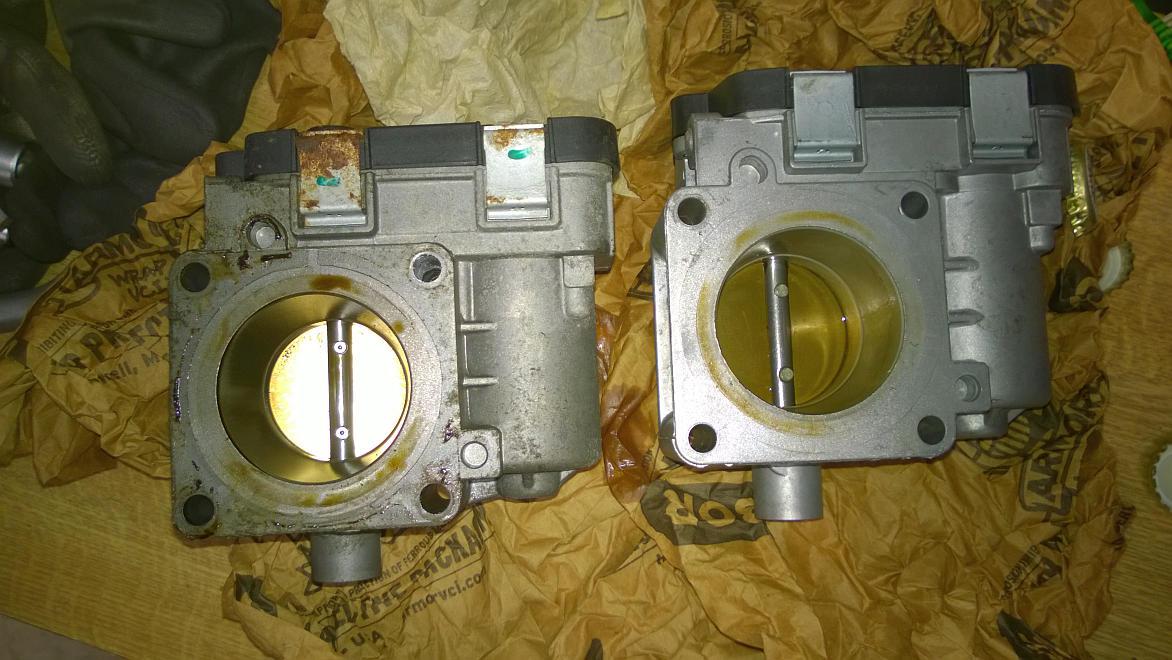

The 1.2 throttle has a dia of 40mm, the one of the 1.4 has 44mm.
What this means in regards of cross section, shows the picture attached.
It´s a little bit comparable with those gas pedal boosters, that change the ratio of the gas pedal and so create a better response, plus with the bigger throttle little better filling at high revs.
The mounting holes are 1:1 the same. I had it in my 2009 500C 1.2Pop, there I only changed it, no other actions necessary. Sometimes it might be necessary to run the adaption, like shown in this video:
