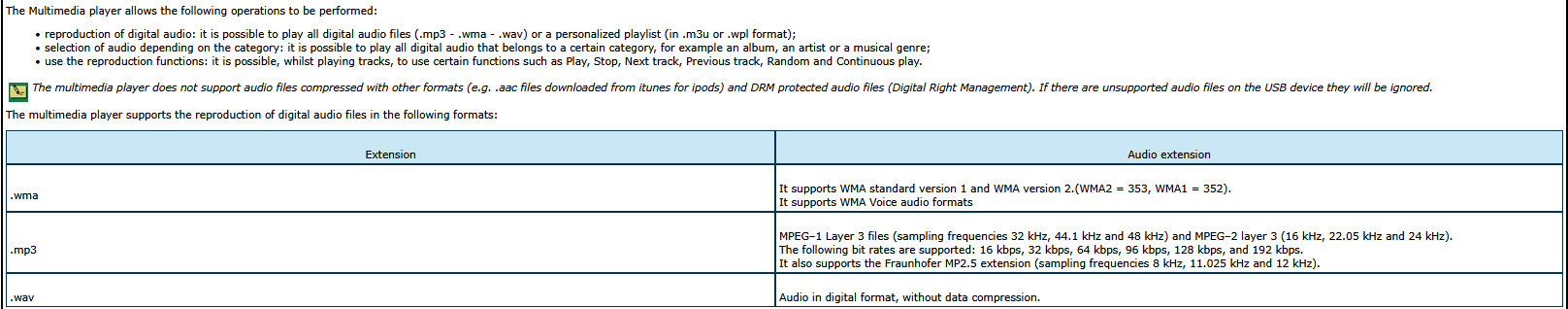

I haven't tried obviously, all my music is on .mp3, but here's a quote from an on-line manual;
I understand there are ways to convert files to .mp3 but I have no experience of such. 🙃
