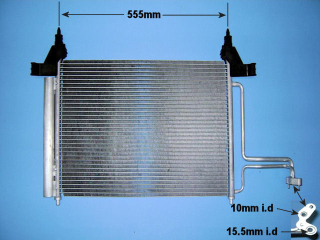

Just to confuse the dimension issue, picture below is the one I fitted several years ago.
As I remember, you don't need to remove the bumper. There'a a plastic panel under the condenser that holds it in. However, the bolts that hold the plastic panel are likely to be rusted. Disconnect the pipes and remove the panel, then the condenser drops out from below. You'll need to jack the front of the car up fairly high.
Make sure the condenser comes with (or you get) new "O" rings. A/c "O" rings are usually green.
That's the one that seems most common... it has lugs which are 555mm apart (although one brand says 560mm... I reckon it's the same thing).
The other sizes are probably the width of the finned section, or the width of the entire cooler (one edge to the other) so most of them are probably all the same thing, just measured differently.
But Hella list two distinct part numbers for the same car, so while I suspect mine is the bigger 530x340 size (in Hella terms) I'm just curious what the smaller one is. My car usually takes the "usual" or more common option for everything but you never know.
