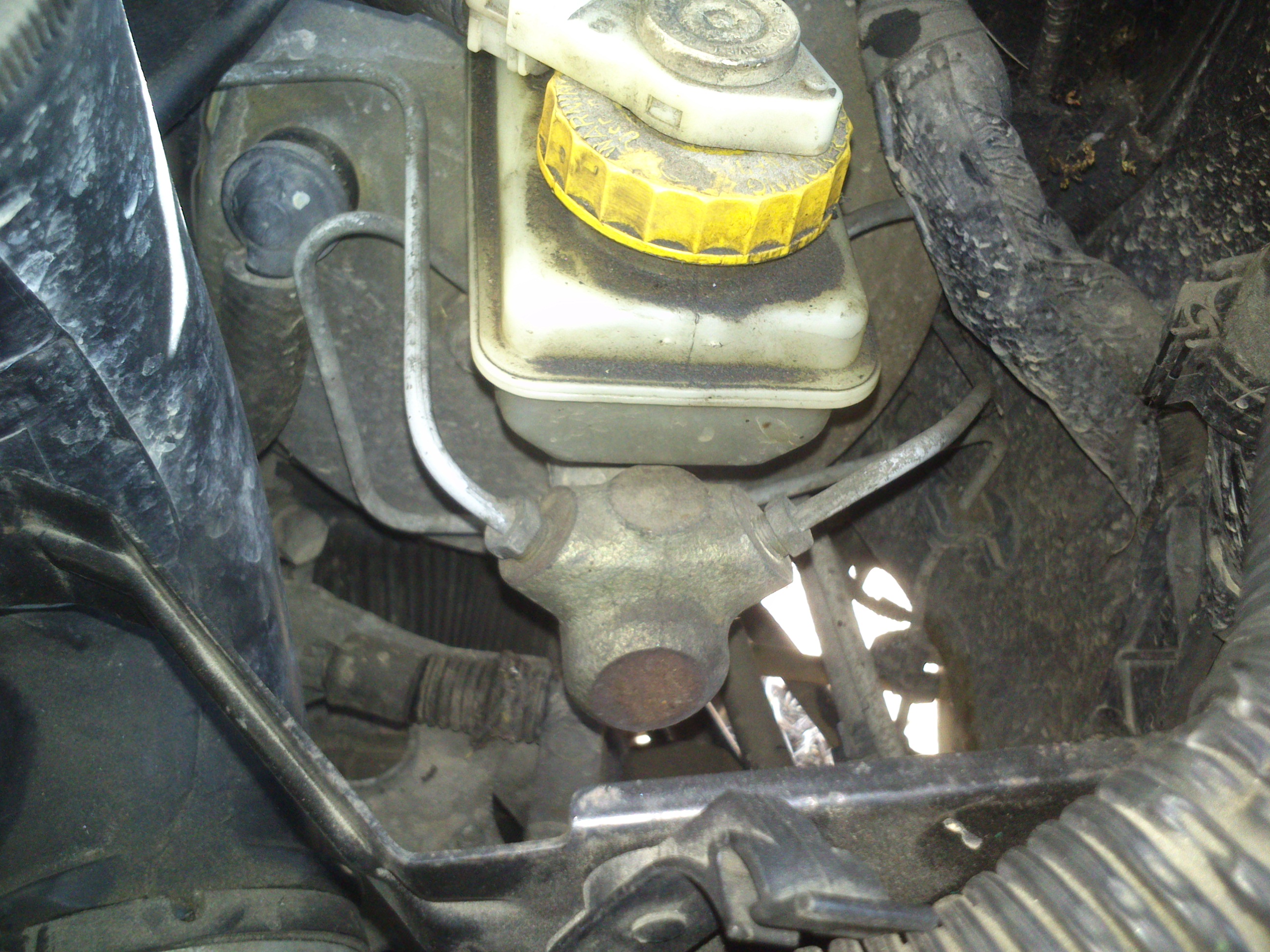

seeing as this is an old thread and has already been hijacked, i thought it might be a good place to ask a (silly?) simple question.
i have had the ABS light on since i bought the car, but i have never actually paid ANY attention to it (to the point i never noticed the lack of ABS unit, or the 4 brake lines on the master cylinder), but now i have managed to make my diagnostics adapter work, i thought i might like to identify the problem.
well, i think i have found the problem, i don't have ABS, and have never had, ABS.
what i think has happened is that before i bought the car, the previous owner changed the cluster for the MOT, due to it having bad connections, they must have changed it with one that is expecting ABS to be present.
my question is therefore, is there an electronic way to get the cluster to not expect ABS, or should i just take the thing apart and remove the bulb?
many thanks in advance.

If it's an early one it's just a case of taking the bulb out. On my late Brava cluster the warning lamps are LEDs. Which I suppose you cut just snip off.
The cluster is easy to get out. I think it's just four 4mm Allen bolts and a screw under the vent for the cover and then four 4mm Allen bolts for the cluster.
ABS warning light is LED and cannot be removed.
But on the back of the cluster, there are two holes for bulbs which are fitted with white, empty caps (they look the same as regular bulb holder, they are just white).
This empty holes can be used to short circuit (bridge) and turn off ABS and airbag warning lights. You can just do it with a piece of wire soldered on the empty bulb holder.
I found this information in Marea's service and repair manual. If you'll need more detailed explanation, I can copy this section from the manual.
BTW; Multiecuscan cannot connect to ABS unit fitted on Mareas built before '99. (Marea 2.0 147 in example). I was able to connect to it with professional diagnostic tool. Both of my front sensors are gone. :(
Also, this old type of Lucas ABS unit is known to fry relays inside of the control unit. Info about it and how to repair it can be found on this forum. (y)
i had the cluster out a couple of weeks ago and written on the back, in messy handwriting on an old sticker is "Marea JTD" so it looks like the garage that changed the cluster weren't fussy with what they put in. i do wonder, could this explain why my radiator fan comes on when the needle is only half way?
i can comfirm that on the JTD cluster, the important ones are L.E.Ds, i might have another look and see if the white bulb holder trick works, although i dont have the best memory, i dont think i saw any white ones.
Yeah, it may be that there are no white ones. In that case just pull them out one by one and look for the blank ones.
From your photo, I can see that cluster is from the "facelift model". I've used one like that from Marea 155 on my Marea 147 but returned to original one because temperature gauge would not go over half no matter how hot the engine was. Also, speed readings were off and I had trouble with check panel.
I suspect that coolant temperature sensor might be different on older and newer models so you could try to change the sensor for one from JTD.
