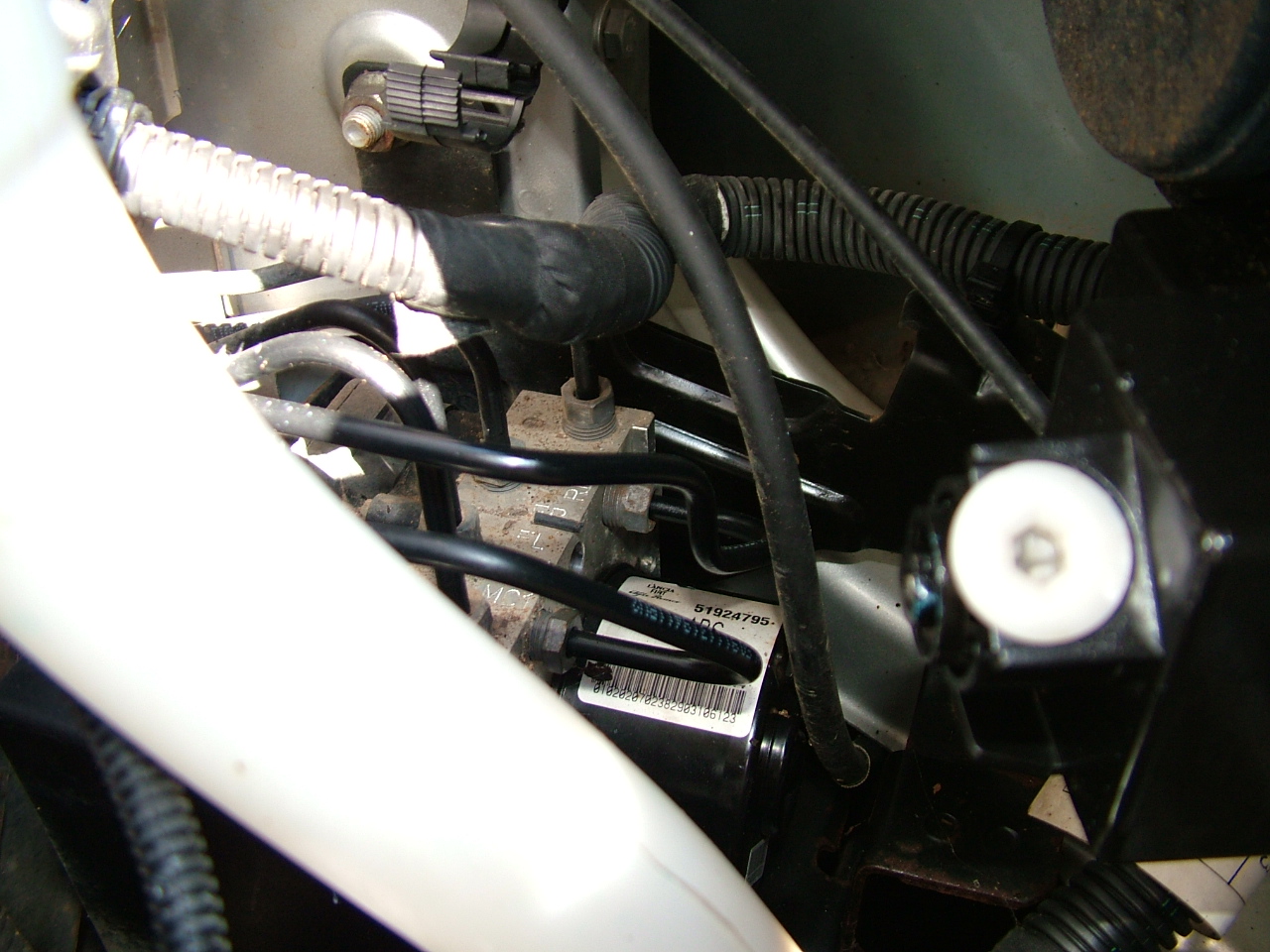

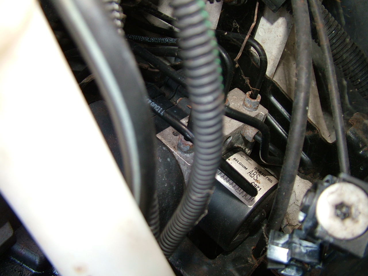

Does your ABS unit look anything like these? It is situated roughly between the battery and headlight.
The first one is on a 2010 1.6 Fiat Doblo and the second one is on a 2014 Vauxhall Combo 1.3 Multijet which is a "badge engineered " Fiat Doblo although the Fiat software cannot read it just to be awkward?
