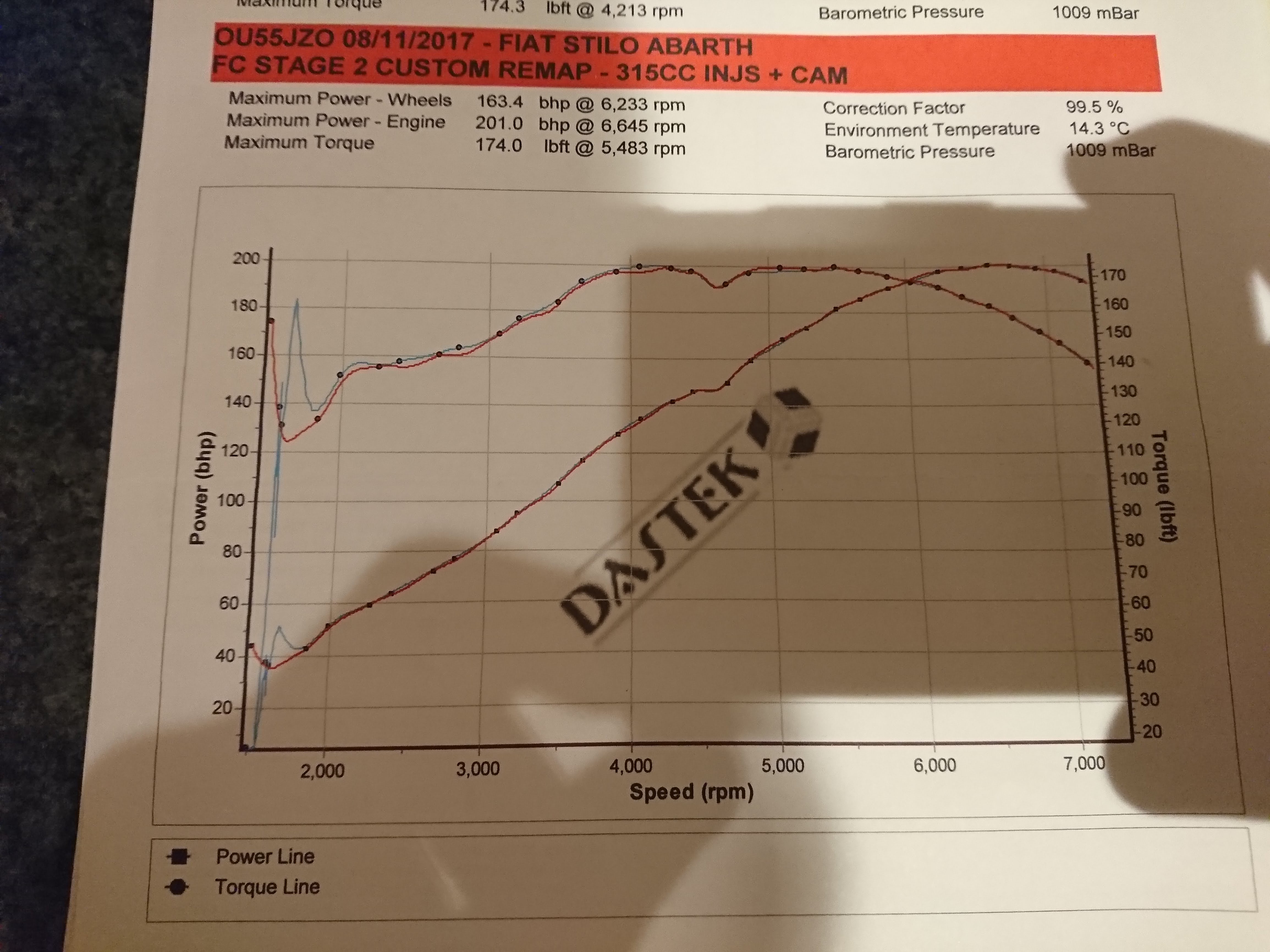

Hi I’ve done something similar to what your planning to do engine wise I’ve got a Schumacher gp with c and b cams 2nd cat removed k and n typhoon and 315cc injectors redline raised to 7200 stage 2 Live Road/rolling road mapping You be looking at around 200 bhp. I can highly recommend Leighton Wilson at Castle Combe race circuit for your mapping.
Hey, thanks for the reply. Its getting alot harder to find anyone who's into modding the stilo abarth/schumi cars nowadays. I've found somewhere pretty local to me who say they can remap the car for me, so hopefully I'll get to see what she can do in pretty standard form. I've read lots on the forum from years ago and on the coupe forum too abt the dreaded 2.4, seems some parts can be swapped over from the coupe. Im looking for a coupe inlet manifold to get rid of this plastic vis one(on the stilo), for now itl b pretty standard until more funds come in for the cams, and hopefully some head work. Ideally next year go for forged engine internals and maybe look at supercharging it, got a mate who's pretty handy at that type o stuff. In my head 300+bhp would be mega!
