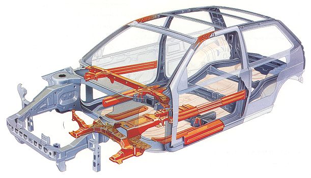

Wondering if the modified shell introduced in 93 is actually beneficial for handling. Seems like it is certainly heavier, which is a little undesirable. What are people's opinion?

'Modified shell' apart from door numbers there's no real difference.
At the carsfromitaly.net website there is a paragraph that says
"The second series of the Tipo arrived in 1993. A major overhaul of the product was most immediately recogniseable by its new grille. The main changes were concentrated on improving the safety of the car, with a heavily revised structure including side impact bars, deformable zones, height adjustable seatbelts, seatbelt pre-tensioners, energy absorbing steering wheel, airbags etc."
A picture is provided indicating the changes.
Press talk, loose the side impact bars and the 2 are unrecognisably different, picture shows crumple zones and the door bars. For example the subframes as pictured are identical. You can have some faith in what I say for sure I've done a couple of jobs with both types of car.
