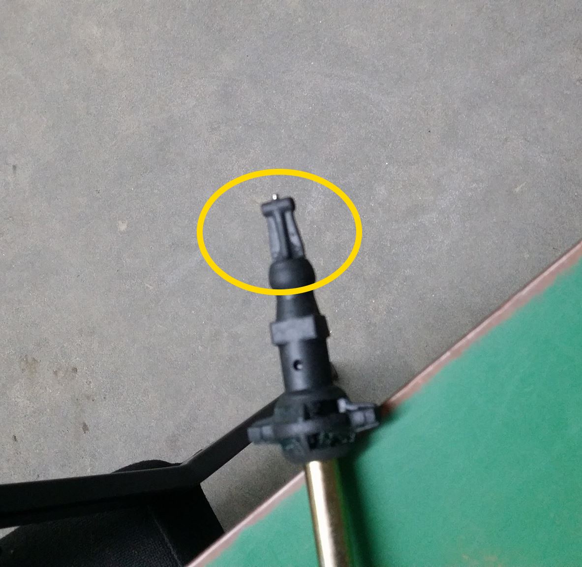

Finally pulled it apart, does appear to be the joystick at fault.
Also found that the gearbox defaults to 1st gear when the joystick is not plugged in!
Managed to drive it around in auto mode without it.
The was a whole lot of oily residue underneath where it was mounted, anyone got any ideas on where that would of some from?
Opened it up, the plastic tip of the selector rod had almost totally broken off.
Oil residue was the grease inside coming out.
We put a hole through the middle of it and drove a nail through (had to grind the tip that stuck out off).
attachment.php
Superglued the plastic back together so it should now be stronger than new.
Issue resolved!
