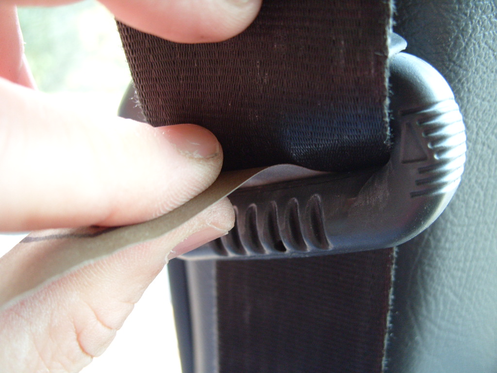

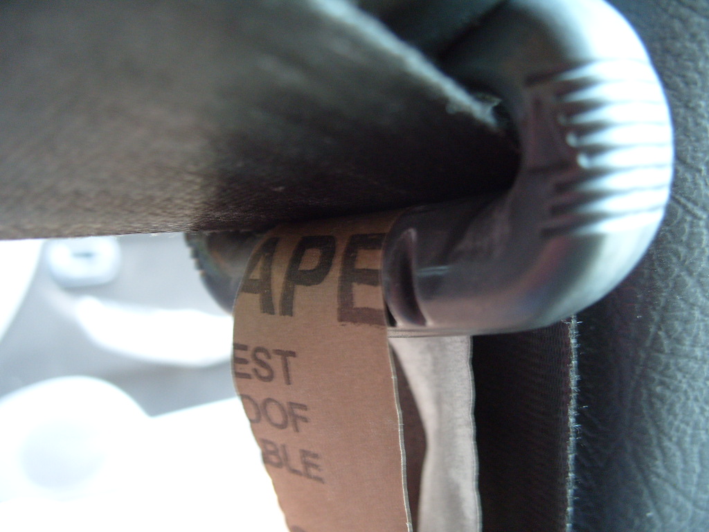

Step 1 - see photo. Put the front seat forward that you will be working behind and sit yourself on the back seat. Take a long narrow strip of wet n dry paper at least 1000/1200 grit dont go too coarse. Pull out some of the belt from the pillar and hold it out with your knee against the rear quarter trim panel. Put the rest around your neck to hold both parts of the belt as loose as possible leaving both hands free for the next bit.
Take your emery paper and insert it in so that the grit side is facing downwards onto the belt holder lower slot on the B pillar. Using a push and pull movement for a few minutes sand the lower part and try to keep the emery paper central to the holder (the holder will try and swing to the left or right as you push and pull the sandpaper through it unless you get a mate to hold it steady) and as you do it keep the door open and blow the dust away (you dont really want it on the belt or to go down to the mechanism) - loads of white/grey dust will come off and probably years of grease, sweat, oil, dirt and other nasties too but my view is that this part is too tight anyway and this is the pinch point that seems to slow the belt down when you unclip. I also think part of the hold up is the way the holder is made - these are bonded around the belt at the factory and I reckon its the flashing along the join that sometimes good on some cars and bad on others. The sanding will get the top of this
curve nice and smooth.

If like me you've got fed up of unclipping your seat belt before getting out and finding a whole ream of it lying in a curled up heap behind your seat instead of retracting back into the mechanism then give these 3 steps a go. It has worked on mine today and they are better now than when new IMHO! Absolutely no doubts at all. You can also end all those times where you close your door on a floppy belt part of which keeps getting caught in the door meaning you have to open the door again to pull the errant belt back inside.
