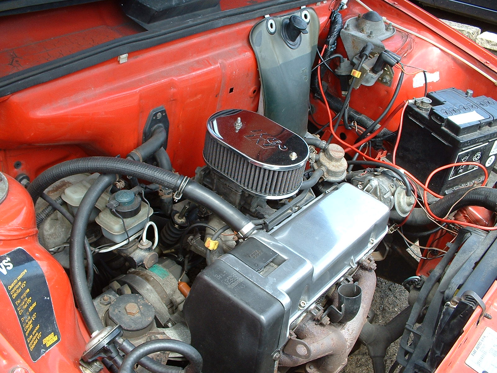

I have a K&N fitted to my Uno. Was given it (thanks Louie (y) ) so have no idea how much it costs to buy new.
It gives a nice induction noise, and makes the throttle response a bit crisper, but the engine still performs much the same. Biggest advantage is making the engine bay less cluttered and looks nicer than the original airbox.
However, as the carburetor Unos are known for carb icing, come October it's coming off and the original airbox will back on for the winter months.
Here's a picture of mine:

Also, unless a cold air feed is located in a direct air stream at the front of the car where air can be rammed through, they don't really work. The original airbox is sealed, and the cold air pipe to airbox gets cold air by the suction process caused by the carburetor/ throttle body.
Think of it like the pipe going to a vacuum cleaner. If you disconnect the pipe from the vacuum cleaner and hold it a few inches away from the suction hole, very little air will be drawn in through the pipe as the vacuum process will have been lost.
Therefore, unless you fit a pipe that gets air rammed in, very little air will reach the aftermarket air filter. Air will be drawn in from all around the filter, and the 'cold' air pipe in front of it will have little suction effect acting on it.
And also, if the pipe IS fitted so it rams air in, then that means everything else will get rammed in as well. That includes rain, leaves, insects and dirt, which will soon block up a nice new filter and make an engine bay very dirty...
The best way is to run a sealed intake tube from the top of the carburetor/ throttle body to the furthest point in the engine bay, normally behind a headlight, and fit the filter to the end of the tube here. A look in a lot of modern cars and you will see that this is what a lot of manufacturers do these days.
As the area behind the headlight is not in the direct air stream of the radiator, nor near a hot engine, the filter will draw in colder air without the risk of getting wet or dirty.
Mine is pretty much for show, and I'm under no delusions that I'm getting more power! It does sound nice, and it does make the throttle response a little crisper too.
Anyway, in about a month when the weather turns chilly I'll be fitting my original airbox because it's coming up to carb icing weather! :p

So yes, carburetor icing can occur as I know only too well. That's why come October my fancy K&N is coming off and the original air box with hot air pipe is going back on. (y)
And I agree, I don't get any more power with the K&N, but I do get a crisper throttle, a nice induction noise and it makes my engine bay look nicer :D
