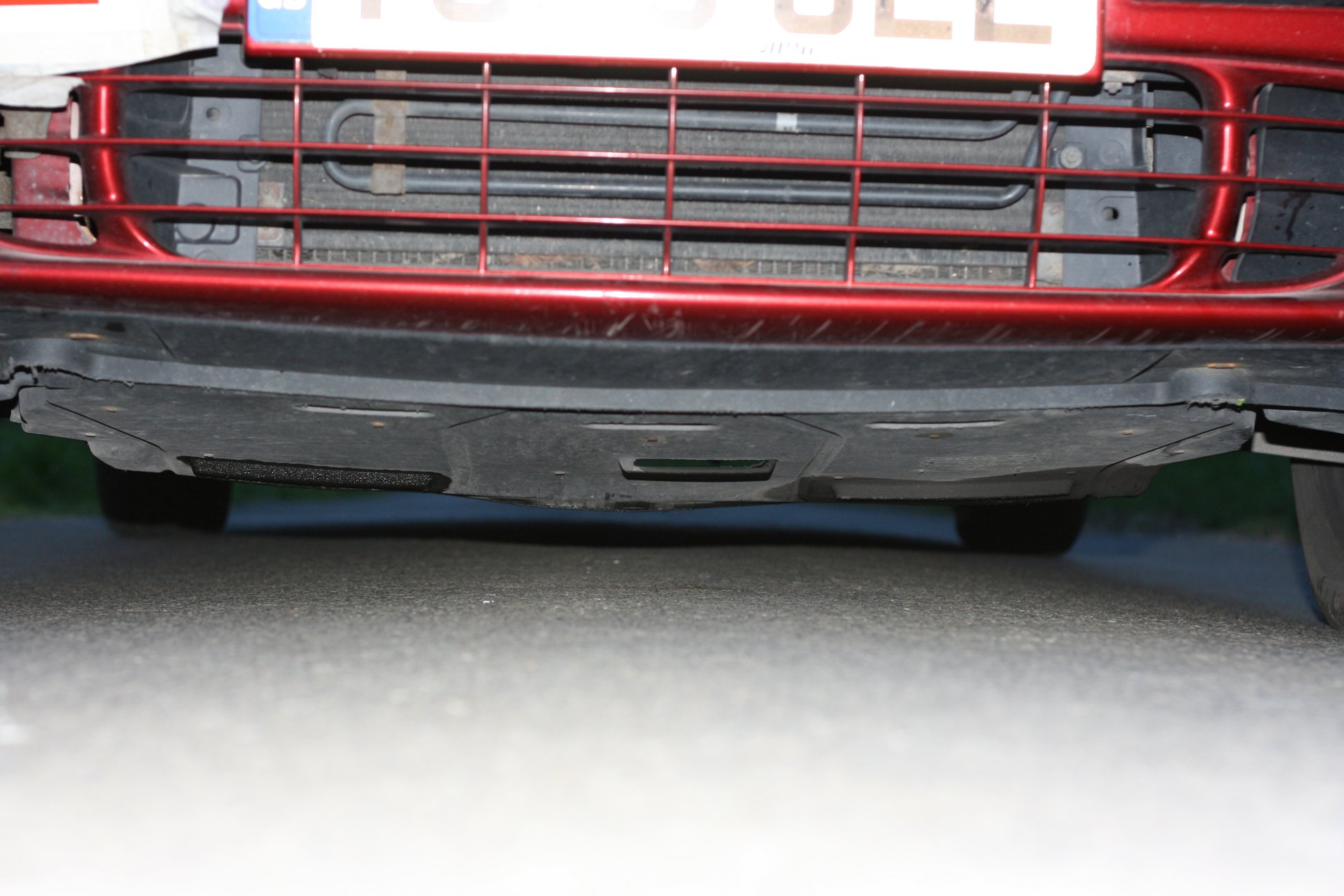

4. I had a look under the car last night after doing a little bit of driving locally and noticing what sounds like the underside of the car scraping along the road surface ... I took a few pics of the underside, but I can't remember for the life of me if the tray is:
  • Supposed to be this low
  • Supposed to have this dark fluid on it
I applied pressure to the tray thing and it doesn't seem to travel up v. far (the bolts at the front are still holding it, but I couldn't get a good look at the back). I ran my hand along the fluid too and as far as I can tell, it isn't oily. Is it normal for the engines to lose a little bit of fluid due to condensation? (It's been bone dry here in sunny Derbyshire for a few days now).

4. you can check if the tray is supposed ot be that low by simply trying to push it up. it should be bolted to the sump and there will be no movement. if the bolt has coem loose, is missing, or snapped off, you should do something about it before the tray ends up getting ripped off.
you would expect to find oil on the undertray because when you remove the oil filter with the tray in place, oil pisses everywhere. however you should consider keeping a close eye on the engine oil level to make sure there is no leak, and also look at the oil filter to check that it is not leaking.
