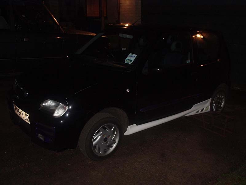

stuck mine on wiv some metal to matal mastic and resins and self tapper into my sills are solid now i now have wheel spacers so the back wheels now fit the arch
:cool: wow wat arches and skirts are those and where did u get them from?
that is EXACTLY what i am lookin for to go on my cinq! (y)
with bigger spacers an wider tyres at the back that would look truly awesome! :worship:
i made them myself u may rememver a while ago i posted some pices without the aches i then found a set of mini sportspack arches and put ek on backward with a bit of chopping :D the a whole lot of sticking and smothing and the from i made the shape with expanding foam the fibreglassed it and filled and smothed i have now got some 32mm spacers from grayston and have fitted em will post pics soon
well... i am very very impressed dude, top quality job! :worship:
