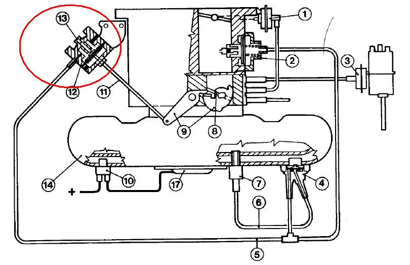

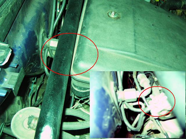

hi there, greeting from jakarta :) seems you have problem with a/c idle vacuum device. is yours is carb version? if so, then you might try this.
mine is uno 1.4 carb and the idle vacuum attached on the backside of carb. the vacuum can be set by using a screwdriver, turn CW or CCW will adjust how much lever to pull to allow additional fuel in.
to adjust it, i always warm up the engine first to get 'engine running condition' then turn on the a/c and start fiddling.
if it doesnt do any change in rpm then yours might be leaked/damaged.
