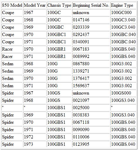

Listing says 1966 Fiat Arbath 850TC. I'd like to input the VIN somewhere to tell if this is the actual car?
Do you know where i can input a 9 digit VIN?
I don't think there is anywhere that you can input an early VIN to get details of the car.
This is the only serial number information I have for 850 models.
