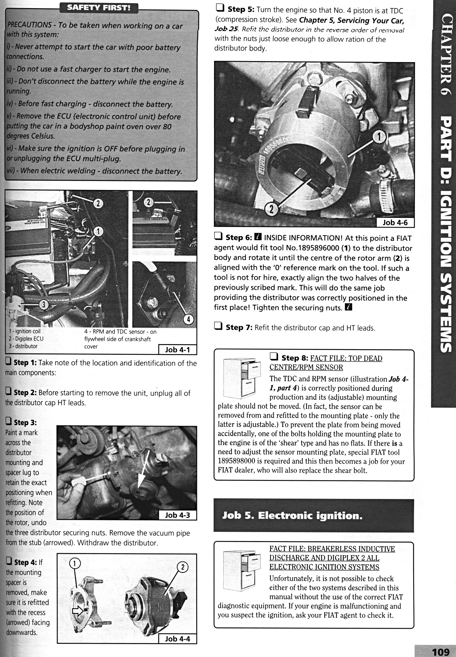

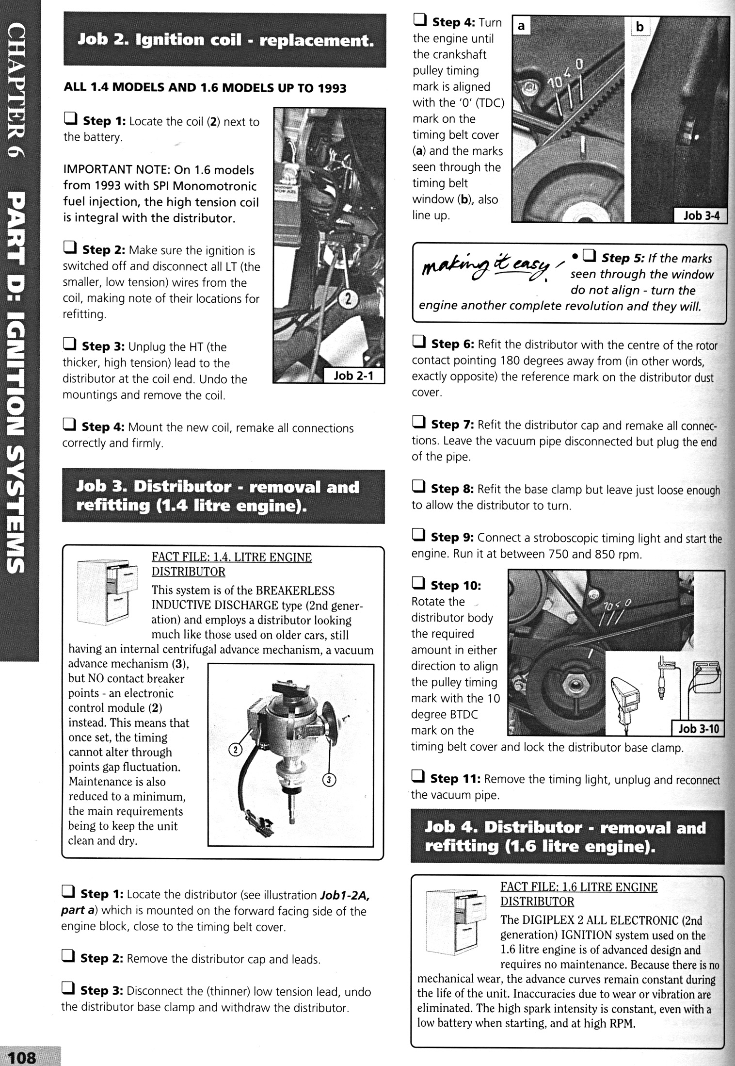

For various complicated reasons I need to retime my Tipo ignoring current spark plug lead order. I need to set the system up from scratch without referring to any present positions and settings.
The manual says:
firing order: 1 - 3 - 4 - 2
rotor arm rotation: anti-clockwise
firing at 10deg BTDC
no. 1 cylinder is nearest the timing belt (I assume this is at the fanbelt/crankcase end of the engine and not the clutch bellhousing end?)
Here's a summary of my intended actions. I'd appreciate any warnings, comments, advice, shortcuts, before I blow the car up! Oh, the distributor is at present on the kitchen table (wife none too pleased!). The viewpoint is from a mechanic's rather than a driver's i.e. bonnet up and looking at the engine from the front, battery to the right and fanbelt to the left.
1. Fit the distributor cap and, starting top-left and working anti-clockwise, with the distributor in roughly the right position in relation to the engine, put on the leads to cylinders 1, 3, 4 then 2. This will mean that 1 is at NW (nearest no. 1 plug), 2 is at NE, 3 is at SW and 4 is at SE.
2. Remove no. 4 plug (easiest to access!) and with distributor removed, spanner on crankshaft pulley wheel nut with left hand, and right thumb over no. 4 spark plug hole, rotate the engine. I should feel the increase in air pressure on my thumb when no. 4 piston is on its compression stroke, yes?
3. With no. 4 on its compression stroke, keep rotating engine till engine timing marks align.
4. Turn distributor rotor arm until brass tipped contact is pointing towards where the no. 4 contact point will be when the cap is fitted (SE).
5. Replace distributor in approximately 'normal' position and lightly clamp.
6. Replace all other bits and bobs: plug, cap, vacuum pipe, ignition module plug, battery ...
7. Store the bits left over in a Tesco carrier bag, light blue touchpaper and retire to a safe distance (kidding! :D )
Whaddya reckon guys - will it work or will I need a new car after I get out of hospital?
If it does work then obviously I'll fine-tune it with a strobe and tighten the distributor clamp as a last thing.
Thanks for any help! :)
Look at these....
