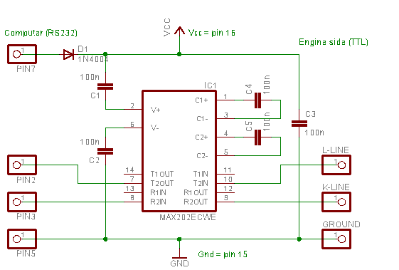

I've attached the converter diagram, if it's any use.

Thanks peteu,
The circuit diagram you have attached does seem to confirm that the ECU outputs TTL levels to the interface. If this is the case then my ECU is doing something strange.
I have definitely obtained a reading of just over 10volts repeatedly, between pin 3 (K) and GND.
I am not sure that the circuit diagram attached though will work as expected, but anyone please feel free to correct me if I am wrong.
AFAIK, the K line is the data output from the ECU - the L line in the data input to the ECU.
The pins on the MAX202 and MAX232, etc are labelled from the perspective of the TTL (the ECU) side of the chip . i.e. T1IN is the TTL input (going towards the MAX chip) for transmission channel 1. T1OUT is the RS232 output of transmission channel 1. R1IN is the RS232 input of reception channel 1 and R1OUT is the TTL output (going to the ECU) of reception channel 1.
That is, whenever the ECU transmits on the K line, the K line is connected to T1IN, the MAX chip converts this to RS232, outputs it on T1OUT and T1OUT is connected to the receive pin on the computer serial port.
In the attached diagram the L line is connected to T2IN, meaning that the ECU should be transmitting on the L line. The K line is connected to R2OUT, indicating that the ECU will receive on the K line.
It is my opinion that these two lines have been mixed up and K should go to T2IN and L to R2OUT. The RS232 side of things looks fine.
Can someone confirm my assumptions about the direction of the K and L lines and the pin assignments for the MAX202/232?

Hi Cinqsporting97, sorry for the delay in replying, had a busy day yesterday.
Thanks peteu,
I dont know much about the cinq ecu, and the rest of this is from what I can remember from 5 years ago with the coupe, but the coupe ecu definately outputs ttl levels. I'd imagine the cinq is the same, but then again it is a fiat!
Hmm yes you are right, looking at it the K and L lines are the wrong way round on the diagram above, the attached diagram here is from the max202 spec sheet and shows the chip pin labelling.
peteu, it would be great if you could check your K line voltage. However, if the output is indeed TTL it would be quite possible to get a reading of 0v with the ignition on, when the K line is idling (not outputing the ISO code).
What I mean to say is you might miss the voltage flickering up to 5V as the ECU outputs the ISO code and then falls back to zero. Make sure you can see the multimeter clearly whenever you turn on the ignition.
If I can get my communications issues cleared up I would be more than happy to start developing a device like barnacle's widget.
If you look at the max202 info you will see that there is an inverted output,
ie when the rs232 line is idle (-12v) the ttl o/p is idle at +5v. Likewise when
the ecu is at idle its tx line will be high but at a shifted level, believe me I've done loads of testing on them. If the crossover point at the i/p to ecu is 7v then ttl logic is not going to work without shifting.
