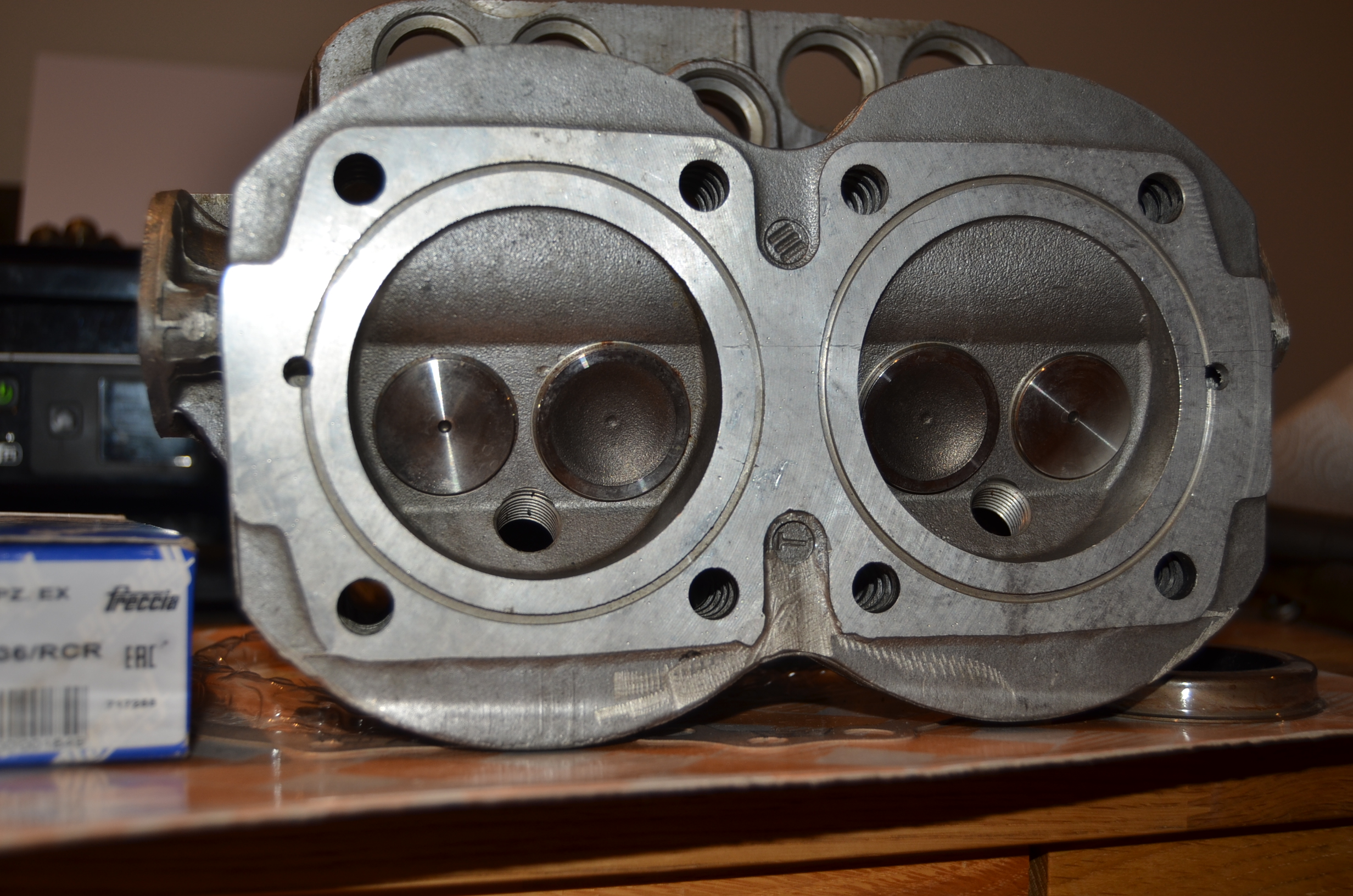

With the pistons/barrels, timing-chain and gears installed, I'm now ready to fit the cylinder-head. My own head is in conflict over this; as the Fiat head is brand new, this would be a good time to have "bulletproof" valve-seats fitted. But it doesn't seem likely that I'll be able to have them machined at any point within the next six months. I want to get this job tidied up whilst I have the time, so I'll probably be fitting the valve-springs and fitting the head without having the head work done. :(
Still, it won't be a bad thing to have a new head, valves and springs fitted to this engine.:)

It's possible that native, micro-pitting of aluminium is mistaken for damage from other causes. The attached close-up of the combustion-chamber of my unused head shows a very roughly pimpled surface which I take to be the impressions of the casting sand.

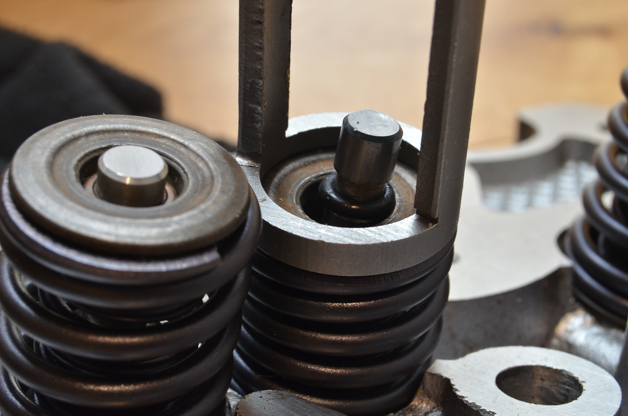

I did some reading-up on fitting these valve-stem "O"-rings and I think I might have done it wrong in the past. All the instructions I can find, which are for different cars from the Fiat 500/126, indicate that they are placed directly below the valve-collets and get trapped by the retainer-cup. Previously I've slid them over the valve stem just above the end of the valve-guide.
I see the sense in effectively sealing the retainer cup because that makes it into an "umbrella" deflector which impedes the oil which will be dripping down from the rocker-arm above. It's quite a fiddly job made harder because those tiny "O"-rings need a fair old stretch to make them fit over the valve-stem.

After reading your comments as to where valve-seals are fitted (on the valve), I looked up a number of BMC sites (the Classic car garage where I work, when I am allowed to, specialises in MG and Austin Healey) and they ALL say that the seal sits on the valve stem just above the valve guide. As the valve goes up and down, it will find its own position on the valve stem.
Whilst I won't argue with an official workshop manual for a specific marque, it's interesting that you quote MG. It was when I followed a link, out of pure interest, which was to one man's very detailed account of the rebuild of an XPAG engine, that I became hooked on the idea that this might be a correct way to fit those rings.
The man, a Neil Cairns, gives a very convincing and almost overly detailed explanation of his every move. His thoughts carry some weight particularly since, as he says, he comes from an aeronatical engineering background. The "O"-ring is a part of a design intended to reduce the amount of splashed oil running down the valve-stem; it's unlike the positive seals as fitted to later Fiat and more modern cylinder heads.
If, as you say, and as I have done previously, you fit it loosely to the main part of the valve-stem, it will be pushed upwards as the valve opens and will always stay at that height. It will only make contact with the top of the valve-guide and make a momentary seal when the valve is at maximum opening. At all other points it is merely a passenger on the valve-stem.
If you fit the ring as I have done so that it is a fixed seal on the base of the collet-retainer, the oil dripping from the rocker-arm is completely deflected by the now sealed, collet retaining cup from running down the valve.
Of course, this is a pretty crude device in itself and doesn't prevent oil and vapour from being drawn down the valve-guide, particularly when the valves and guides are worn. The only real way to sort that out, (apart from fitting new valves and guides), is to fit modern, positive, sprung valve-guide seals for which (as you know from experience), can only be fitted on certain types of later head or ones which have been specially fitted with the correct, step-grooved valve-guides.
Obviously, the Fiat 500 engine is different in some ways from many other engines but the Laws of Physics with respect to flowing liquids remain the same. This is why I was so bold as to transfer the concept to my engine. No-one need follow my advice and I welcome any practical explanation as to why ALL the manuals you have read instruct that the rings be fitted as you describe. But in any case, right or wrong, I doubt it makes much difference anyway. :)

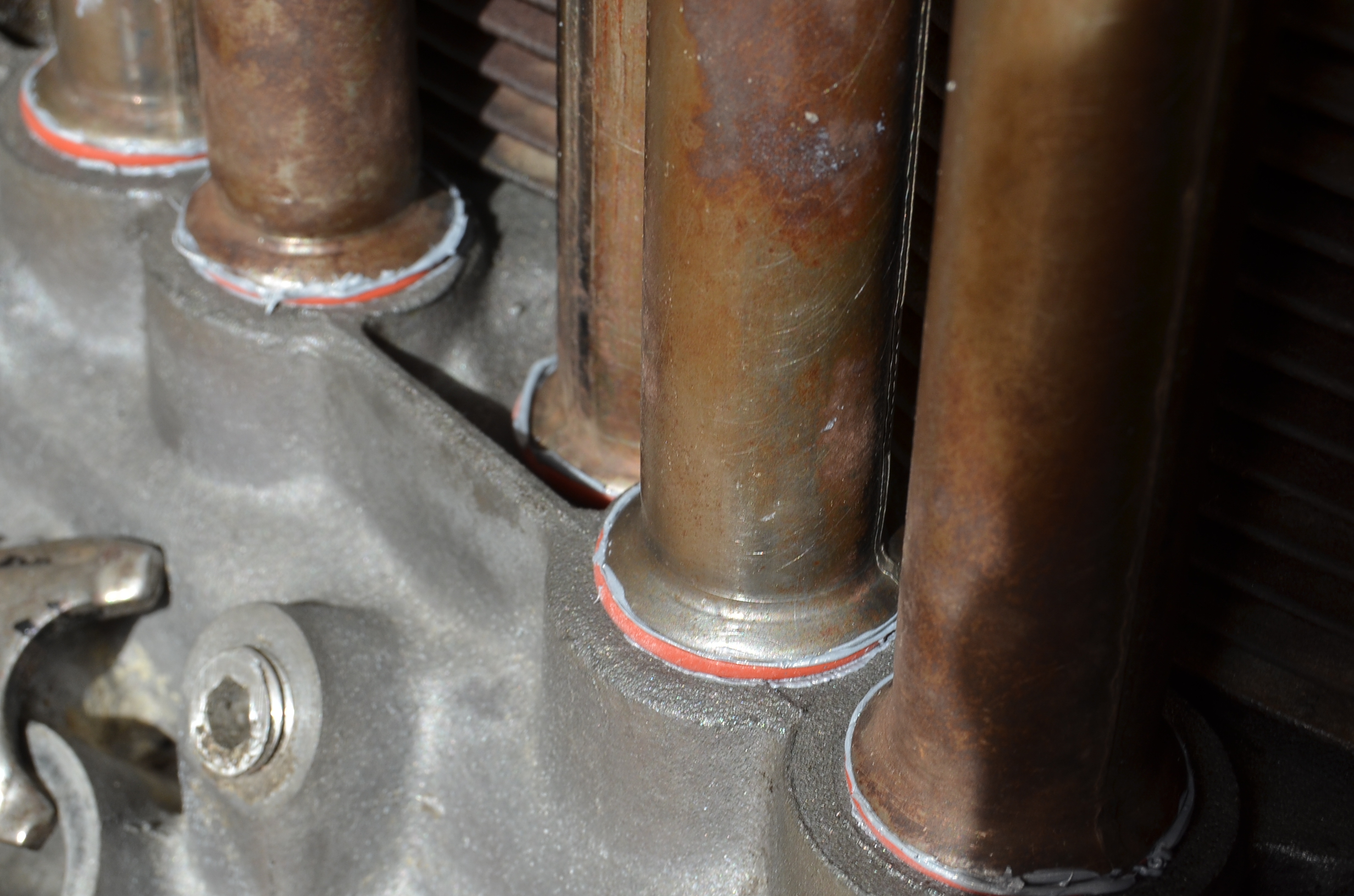

.. You can see my belt-and-braces approach with the thin wipe of sealant I've used to supplement the leak-proofing on these notorious seals. I'll be going round it with a fine blade to remove the surplus. You may see that I have aligned all of the tubes to ensure that both of the slots on each of them has access to the surplus oil pooling on the surface of the head.
Looks like the build is coming along well Peter, like you I have resorted to the sealant game on the seals, even after changing the top 'in head' ones. I've even had to use sealant on the VW tubes I'm using with a decent dab on the threads to aid oil leak prevention (y)(y)(y) I note with interest the way your pushrod tubes 'protrude' above the level of the head. With the Panda head they are flush making it easier for the lubricating oil to reach the followers I suppose. Just another subtle way the evolution of this engine progressed with time. (y)
Ian.
Thank-you Ian; I didn't know that and perhaps it's mod that might be worth trying. But I'll save it for a future engine; I hate to think what the in-situ grinding process would do to the engine. :eek:
