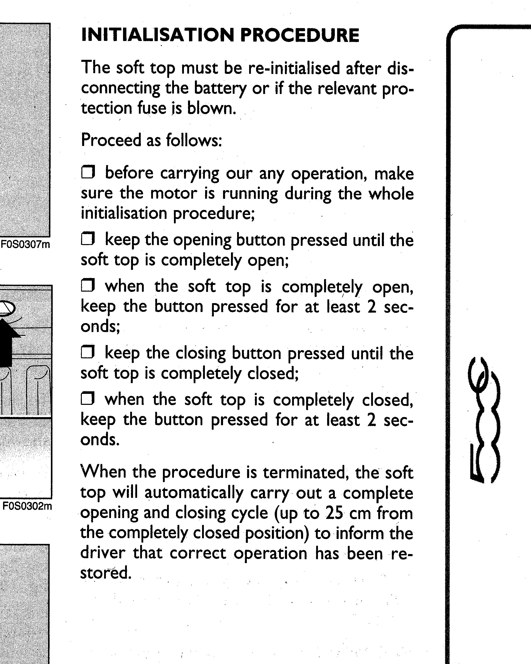

Generally speaking, the roof is not prone to any chronic faults. Mine is now over 11 years old and is opened regularly - almost every trip. I'd suggest running the roof initialization (below) to check for full and free movement, listening for any grinding noises or clunks or hesitation and make sure it runs straight and shuts fully. Note that the final 250mm of closing travel is always done manually by holding the 'Close' button.
The roof can also be opened by pressing and holding the 'Open' button on the key remote but cannot be closed that way.

PS: Also attached is a copy of the 500C Supplement I got with my car.🙃
  • FIAT 500C Supplement.pdf
