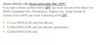

One way to assess the quality of an oil is to look at the TBN. This is a measure of how good an oil is at neutralising acids. The attached chart came from here.
Since the 500 requires a C3 spec (low ash) this has caused the TBN to drop - this can be seen in this spec list on Valvoline (highly regarded oil does well for a Class III in Sheer tests) where the ACEA C3 spec was 7.5 and the standard 5W40 for older engines is 10.3
TBN figures for the following...
Selenia is stated as > 7
Castrol Edge is 7.6, Amsoil European spec is 8.0
M1 has a high TBN but did poorly in a Sheer test and does not do an ACEA C3.
So IMHO one can do better than the Selenia particularly given the price. Once the oil has the Fiat Spec Approval 9.55535.S2 you're fully covered.
With the requirement of ACEA C3 for the new range of 'Fiat' engines it would appear that the oil needs changing more regularly given the drop in TBN.
Lastly, Mobil 1 only guarantee their oils for 10K and for 12 months. Any more requires a long life filter. If the TA filter costs £20 odd it would be wishful thinking that it was one.

I thought the TBNs quoted above was useful and seeing that the Selenia is in & around the 7 I thought that was OK but not for the price that I've had to pay at my local Fiat dealer. I did double check some of the figures on the attachment and it does seem correct. I quoted the source of the table & really can't see how it's unreliable.:confused:
The reference to C3 (Low ash) is correct since although C2 is a mid-SAPS it is still referred to as a low ash at 0.8%. C2 is a requirement for the diesel at that same figure and that's referred to as needing low ash. Attachment came for the AA.

The C3 rating isn't low SAPS (Sulfated Ash, Phosphorus, Sulfur), it's actually mid SAPS and the C3 rating actually encapsulates a few other ratings like A1,A3 (fuel economy and long life for petrol engines) and B1,B3 and B4 (Fuel economy, extended drain and being for direct injection diesels)
