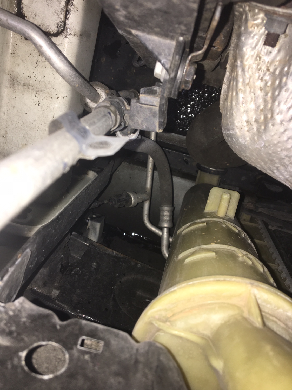

Car up to temp been under no obvious leaks ??!! You would think I’d be seeing pink residue

Hi John, by the photo leak seems to be on cambelt side of the engine it would seem. Leaks are buggers to spot sometimes, I don't evny her today.
Could well be John. She mentioned it loses quite a lot of coolant & quickly - and this seems to have started quite suddenly. My bet is a cracked radiator or split rubber pipe but i'm just speculating!
As mentioned already by someone else that metal pipe behind the exhaust manifold can rust through - possibly finding it's way to where the water is collecting also.

Well given it a good shot today up on ramps I’ve checked everywhere where ever the leak is I cannot get to it so off to garage to book it in I’ll kick myself if it’s something I could have fixed but I’ll let you know what it turns out to be!
IMG_2345.JPG just got back from my mums (17) miles back down to min and looks like liquid under bottom trim! Who knows with all the rain anyhow booked into garage tomorrow
