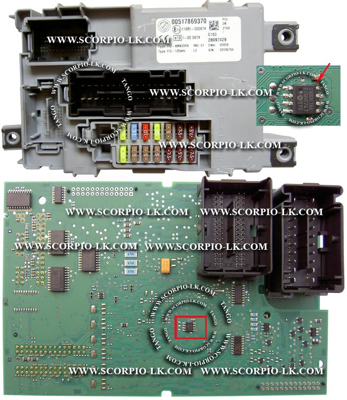

Alternatively assuming the spare unit you have bought is the same part number and dependent on the reason you need to replace it. You can clone your existing unit by having the eprom in your unit read and the file written into the new unit. Or by physically removing the eprom from yours and fitting it to the replacement.
This is what the inside of the computer looks like and shows the 93c86 eprom that holds all the information that makes it specific to each car. There are several variations on the hardware depending on year and specification of the car. But the eprom is roughly in the same area.
