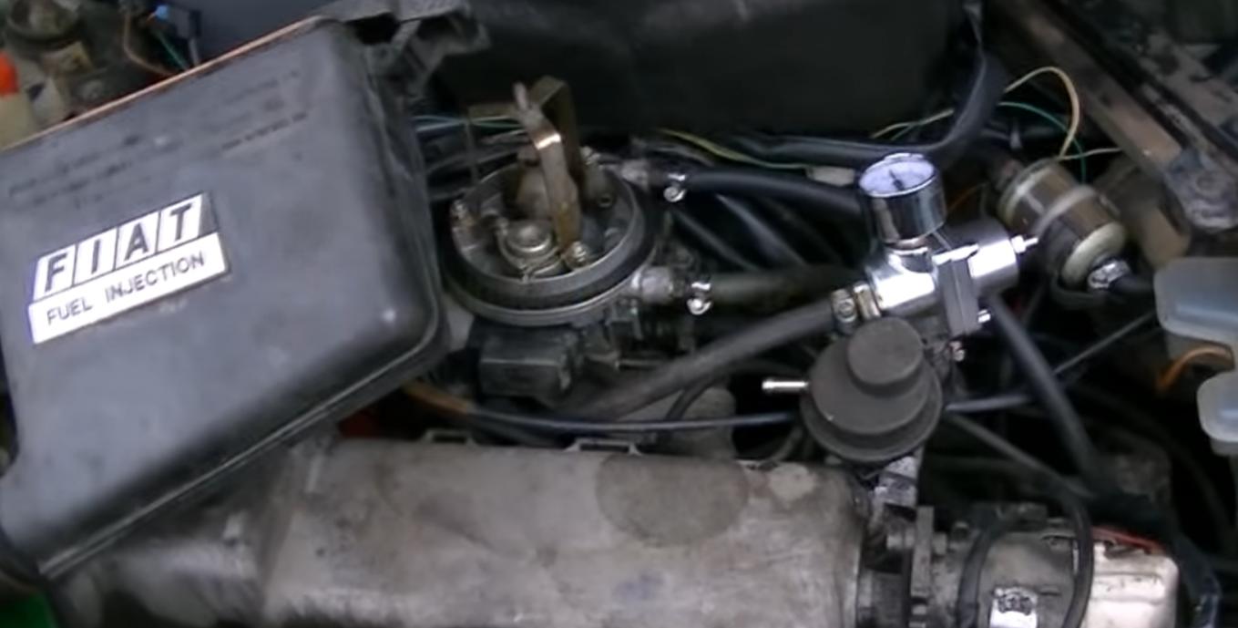

Here is picture on how exactly my engine looks and with same carburetor. (not my panda in picture, I dont have this pressure regulator)

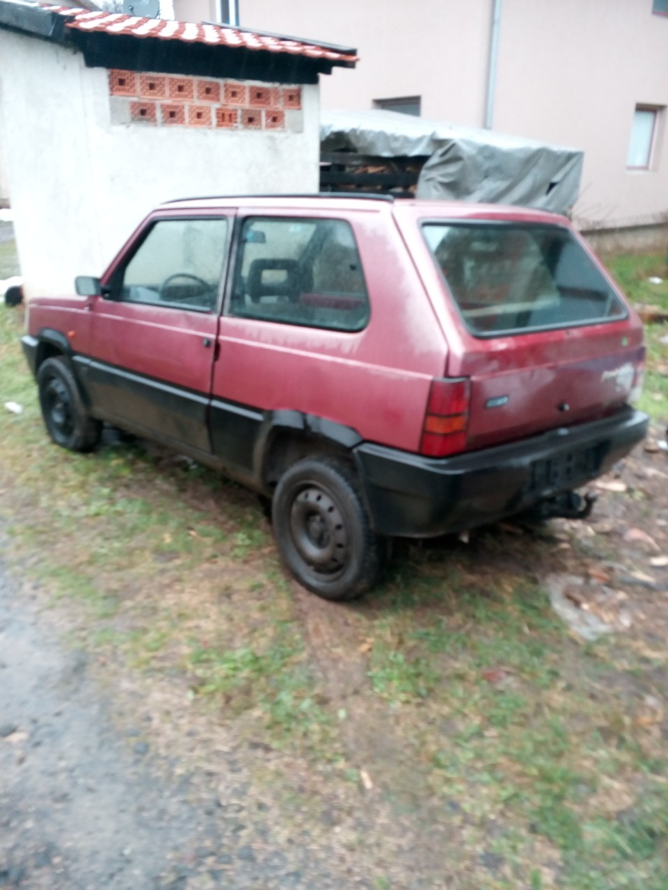

I will soon add pictures of my panda and progress as I go thru with it.

that looks very familiar, hmm..
looks like the Bosch injection system. i actually tried to convert my sisley to run from it but could never get it to work right. i took the system from a scrap fiat Uno 999cc ie. (turns out the system was originally intended for use on VWs as it has a VW stamp engraved on the aluminium intake manifold)
the stock cam/engine driven fuel pump wont run that injection system. you need a minimum of 0.8 bar from an electric pump. make sure you have a clean fuel filter, and a good fuel pump.
this injection system does not use a crank position sensor, it ONLY uses the spark signal from the distributor to fire the injector. (you will have 2 green wires attached to the coil pack one goes to the distributor, one goes to the ECU)
the throttle body has a little idle adjuster motor on it that the ECU uses.. this often fails causing loads of issues (this was the issue with mine)
if not running right, make sure the distributor is 100%.
most likely cause will be down to the "UFO" or vacuum advance actuator failing. pull the original vacuum pope off and put another or something else on it and suck on the pipe. if the "points" or magnetic pickup inside the distributor turns it should be fine. you should be able to suck on the pipe and eventually become unable to suck any more air from it. if you find you can keep sucking air, it has failed.
the AFC (auto fuel cutoff) is also triggered by vacuum, when the vacuum is high enough, it cuts the injector off. if your panda has a catalytic converter this is what stops it poising it. if the vacuum is not good due to bad seals or bad vacuum lines, this will cause issues and excessive fuel use. look out for any vacuum leaks anywhere. they cause hell.
the distributor needs an ignition switched +12v through the orange or red wire. (connected to the coil). both coil and distributor need to have a +12V switched live in order to work correctly!
its a well known thing that the "ignition module" fails on the/this distributor system that does not use points. if it fails you will get no spark and no injector firing. the injector fires with 12v. somewhere you will have 2 relays, one for a fuel pump and one for the injector. make sure both relays are good. (swap them over with the rear heated window relay as that is the same relay type)
the lambda (exhaust gas) sensor may have also failed.. this system uses a easy to source 3 wire narrow band lambda, 2x white wires are its built in heater, and one black wire which is the sensing wire. the thread is also a common size so should be easy to get.
correct me if i am wrong, but i do believe that the picture you have uploaded.. is my panda, Talon :D
if so the engine is a 999cc. i dont think they ever did a smaller engine with fuel injection in the panda 4x4.
i am happy to tell you that if this fuel injection system has completely failed, you can very easy convert the engine to good old carburettor.
all you need is the carb and an intake manifold from any other carbed panda with 999cc engine.
hope this helps, gives you some things to check up on!

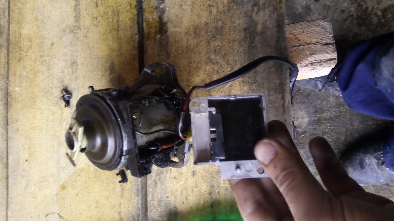

I managed to get it fixed. problem was with electronics on distributor (we call it c-module), swapped it. and worked perfectly fine.
After you explained which lines take what, it was easy to debug the issue. so thank you :worship:

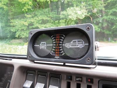

Can anyone tell me how this part is exactly called. (the thingy that shows tilt of car - check attachments). Would love to get this in my sisley. I almost have complete list of parts I need and this one is missing on it.
