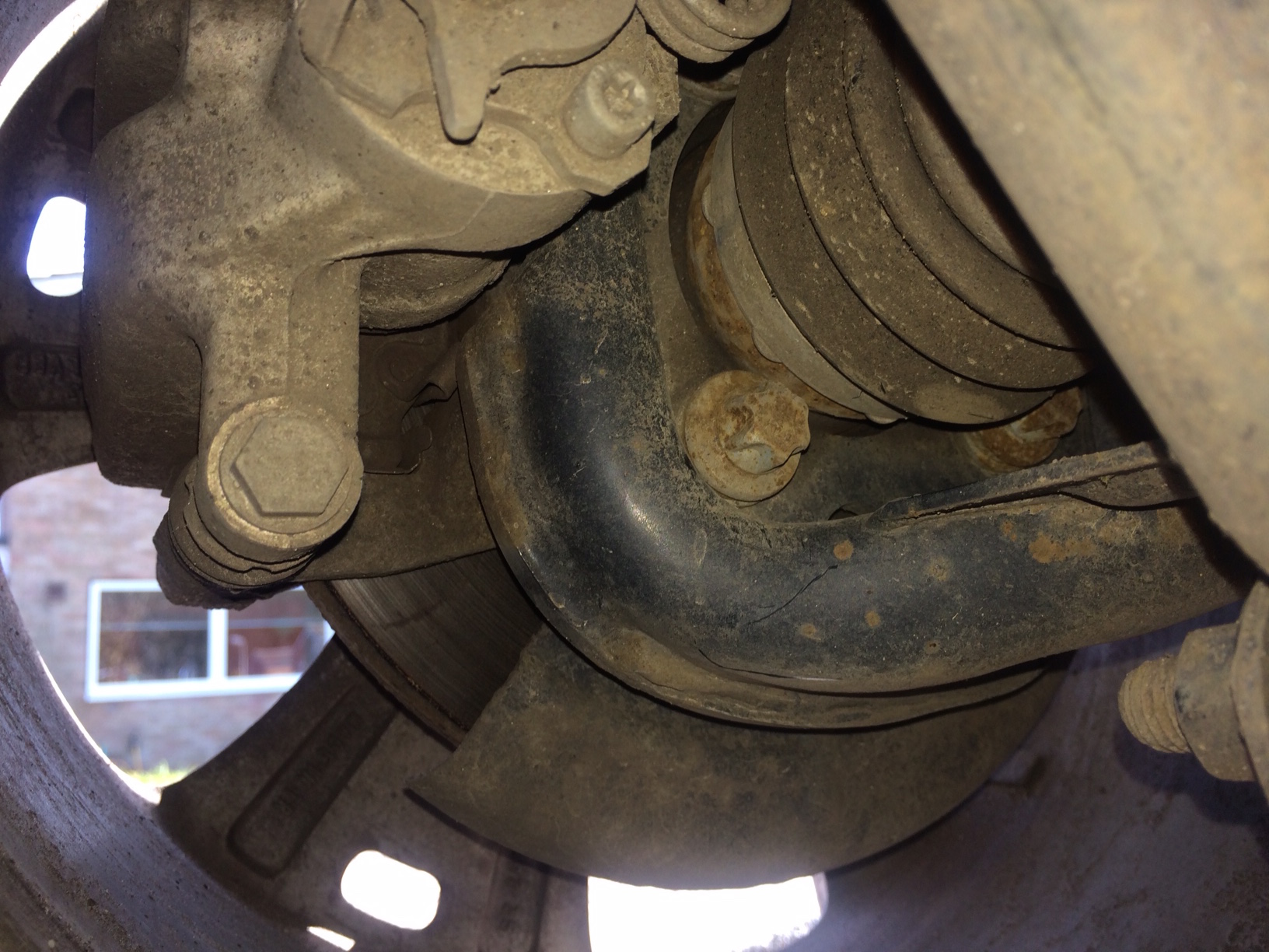

Prompted by this discussion, I've been to have a look.
On the previous 4x4, you could remove the rear callipers by unscrewing two hex bolts with a big Allen key (item 5 in this digram https://www.fiatdalys.lt/en/catalog...917M051870/ZFA31200003210975/0/0/0/brake-pads ) that secured the calliper brackets to the rear suspension arm.
But, as has been said here, those two bolts cannot be accessed on the post 2012 car as they are obstructed by the casting/box section of the new 4x4's rear arm design (my finger is pointing at one of them in the second photo below). It does indeed seem that you need to remove the 'inverted Torx' bolts (see first photo - the lower of the two 'hidden' hex bolts is behind the Torx bolt you can see) and pull the whole hub carrier away in order to reach those two hex socket-headed bolts securing the callipers! (This new design does, on the other hand, mean you can remove the rear diff unit without removing rear arms. I am sure they've designed the hubs to come away 'easily' though, once you've managed to undo those Torx bolts and the hub nut - it should slide clear of the splines of the driveshaft. The bearing shouldn't split as it's retained within the casting by the circlip, and the whole hub/bearing /calliper unit should come off in one piece (item number 1 in this diagram is the main carrier part https://www.fiatdalys.lt/diagrams/B4/B49C013895D6806719BC14527D2319CA.png - by the way, the '1' actually points to the hole I believe the brake calliper bolt passes through)
My pads are 'half worn' but the discs still pretty sound, so I hope that I can replace the pads once without needing to replace the discs as well (they shouldn't really need replacing every time the pads are)

Thanks Herts Hillhopper for posting the pics, you've saved me from having to dodge the showers and get under the car. I was going to have another scrabble about to see if a I had missed a hidden cover or hole to access the calliper bolts.
