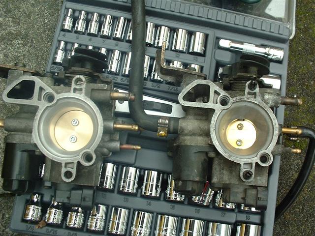

we have a forum member tricker in denmark
who has provided FF members(myself included) with a bored out tb.
At this point it appears Tricker has stopped supplying these
its 40mm over the standard 32mm.(for SPI engines)
this allows more air to be drawn in and so raises power.
this can be used on engines in various states of tune.
i had it on my turbo.
fitment is fairly straightforward and instructions are provided.
these are best coupled with a good induction kit
torque raises by approx 10nm
top end bhp rises by approx 7hp
(on an n/a engine)
thanks too arc for the pic
original TB on the left
check the guides section for fitment info
